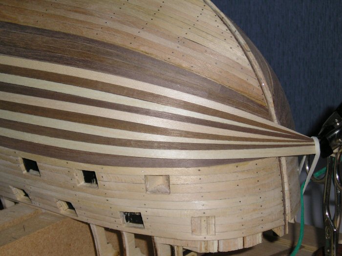

Some of you are having a problem with the planking of the lower hull at the bow mainly the clinker effect. I've setup my hull with maple and walnut veneer planks to show you the amount of taper you would need to reduce the clinker effect. Don't worry the planks are just held in place by elastic bands and a clamp.
As you can see the planks have overlapped and shows the taper, at some points the taper needed is so great the plank goes to a point or is less than 2.5mm at the keel, here you would need to add a dropper plank as shown in the magazine.
I hope this helps you to understand your problem and what you need to do to fix it!

Cheers for that photo all is clear for me now after reading all the posts. I'm still at the sanding and forming stage, a bit behind due to work but at least all your posts will help me with my build
