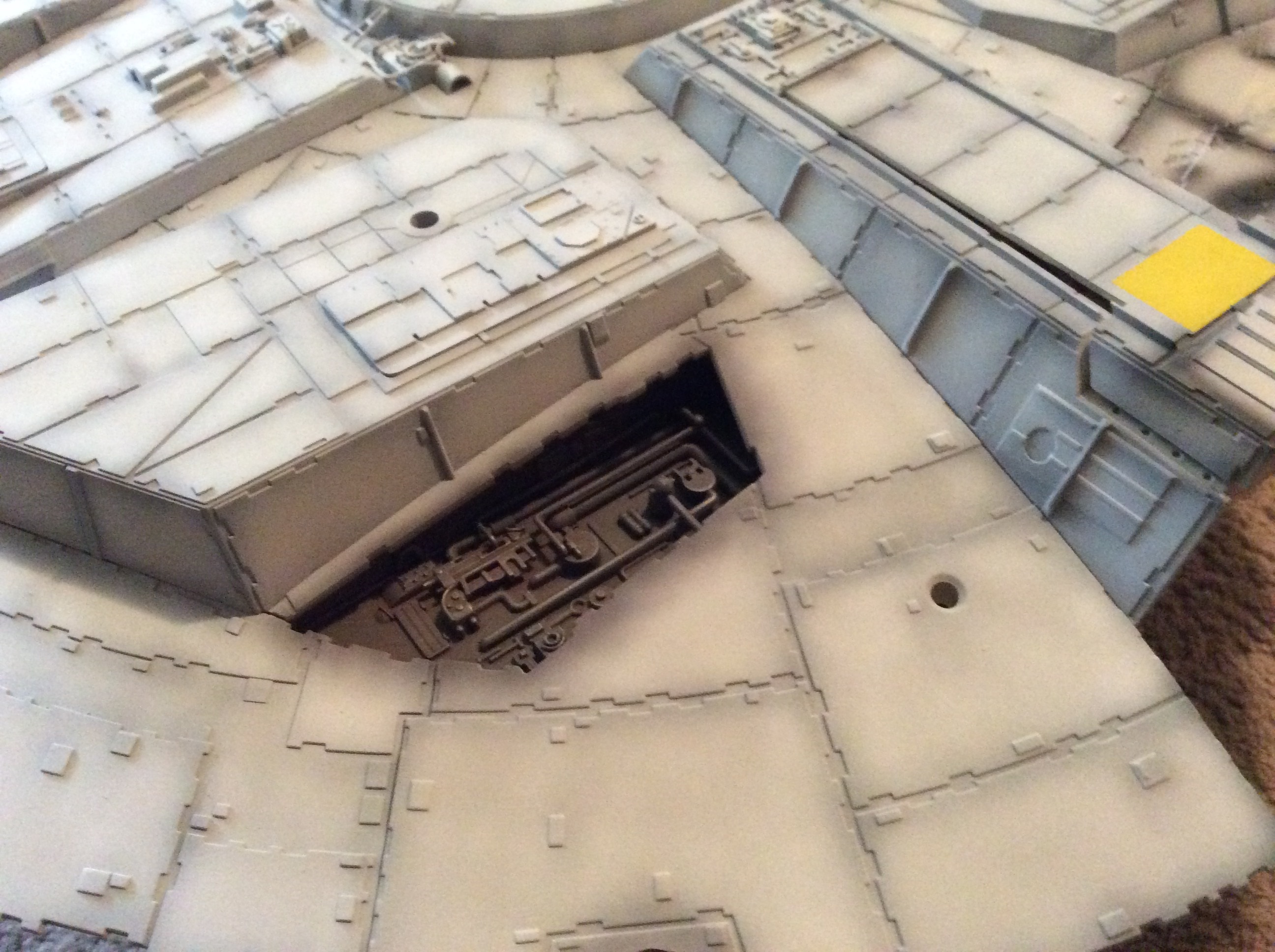

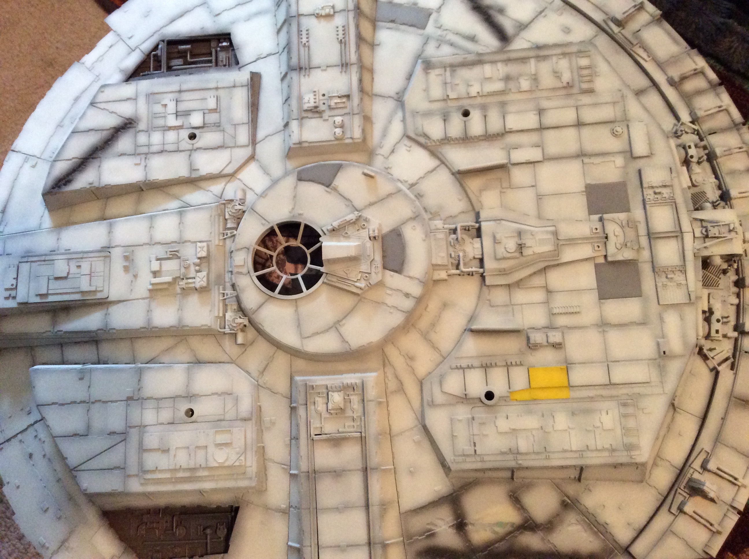

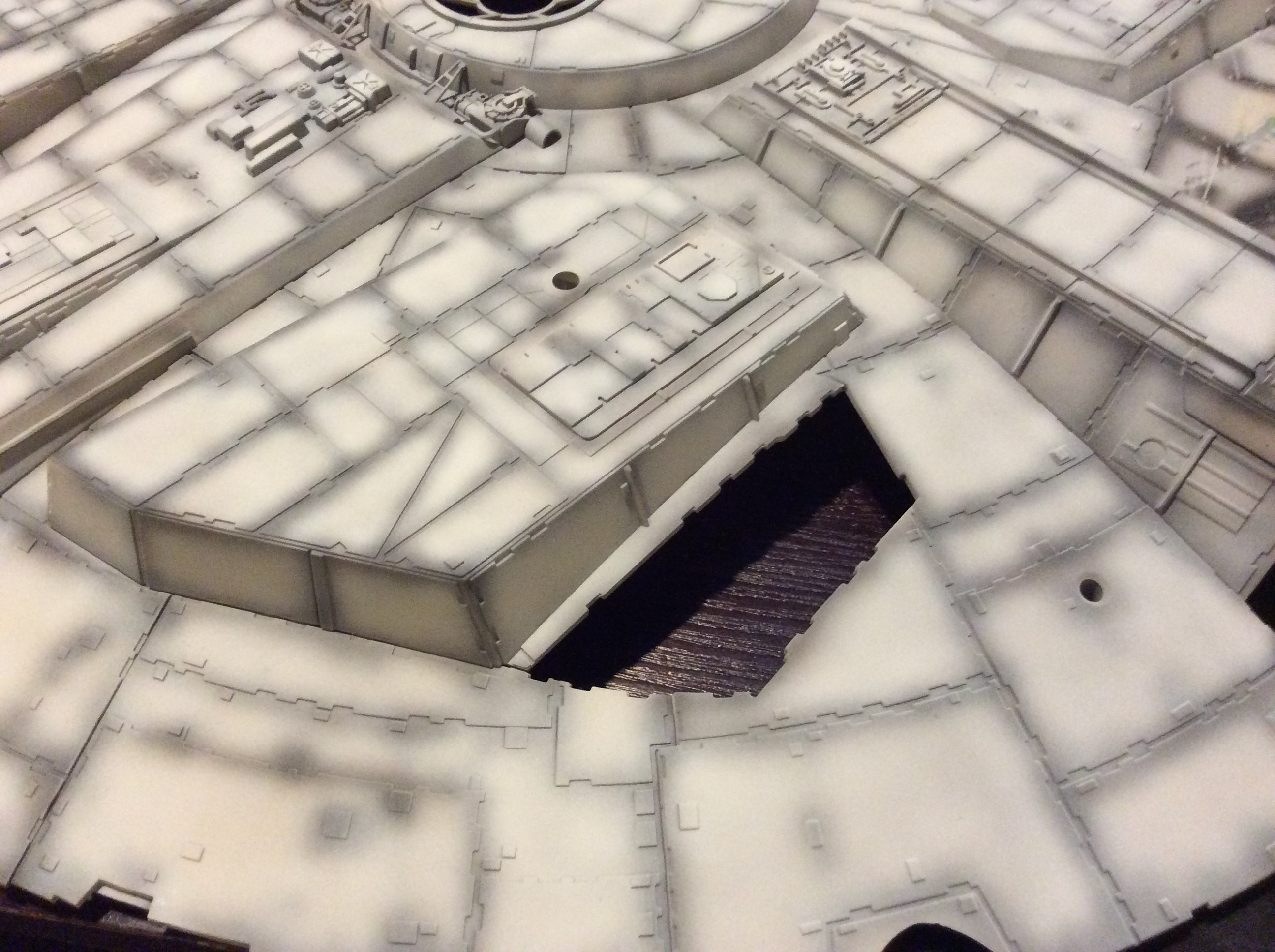

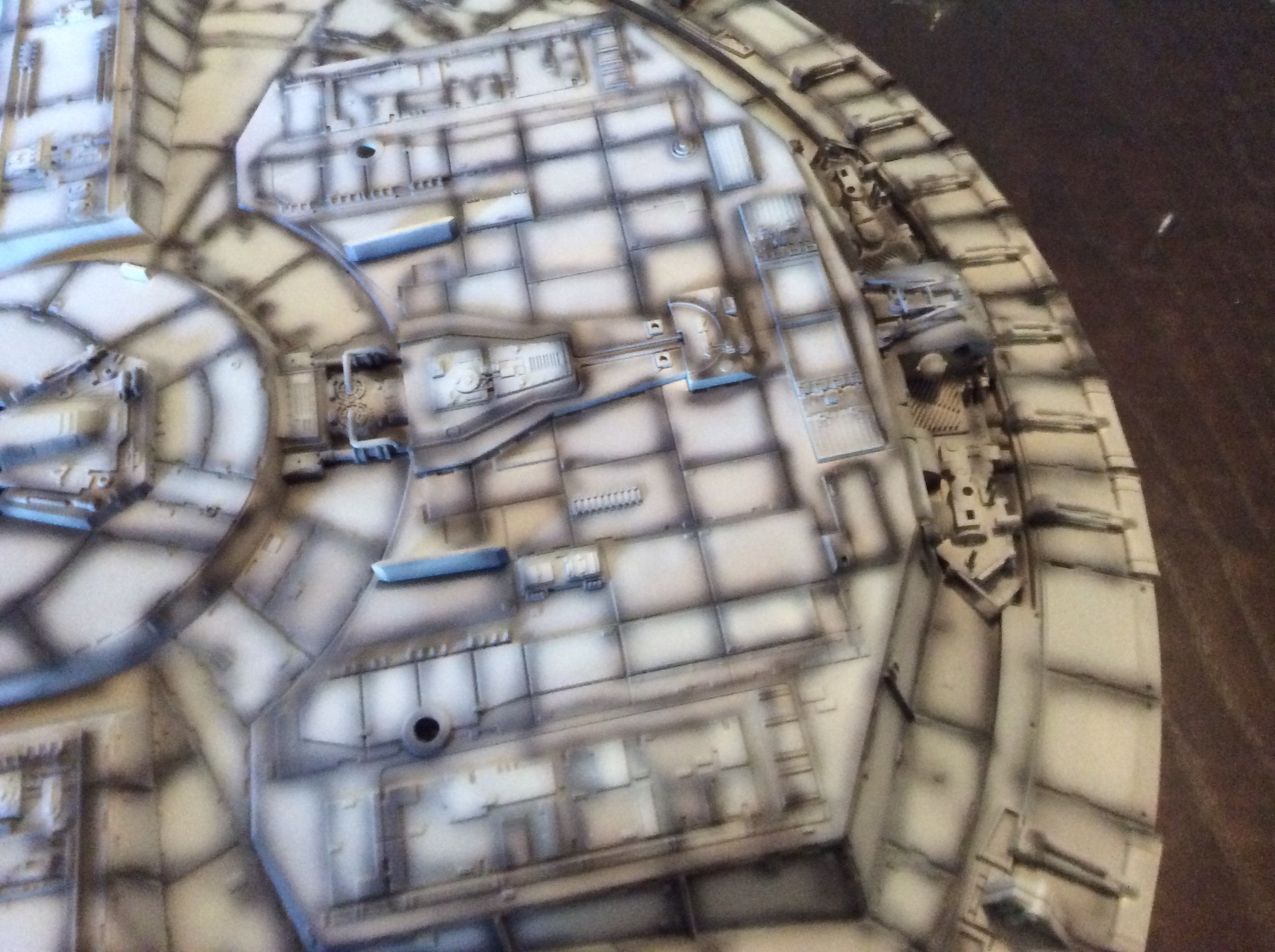

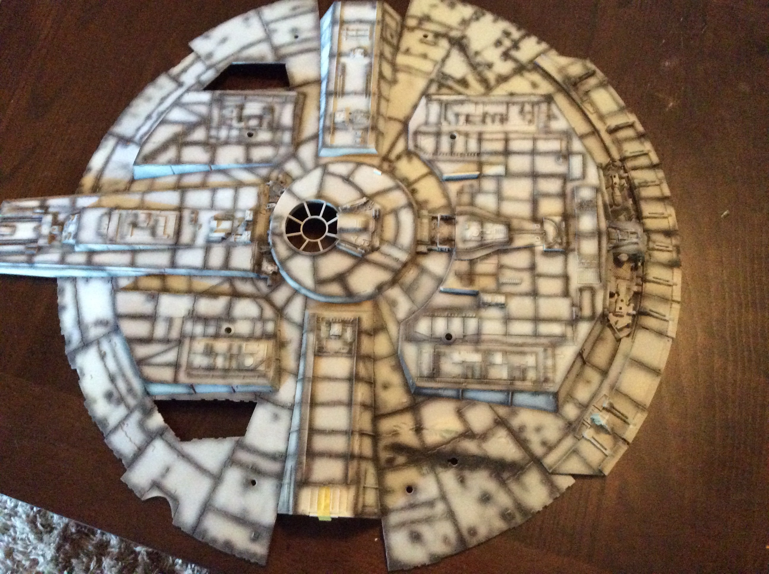

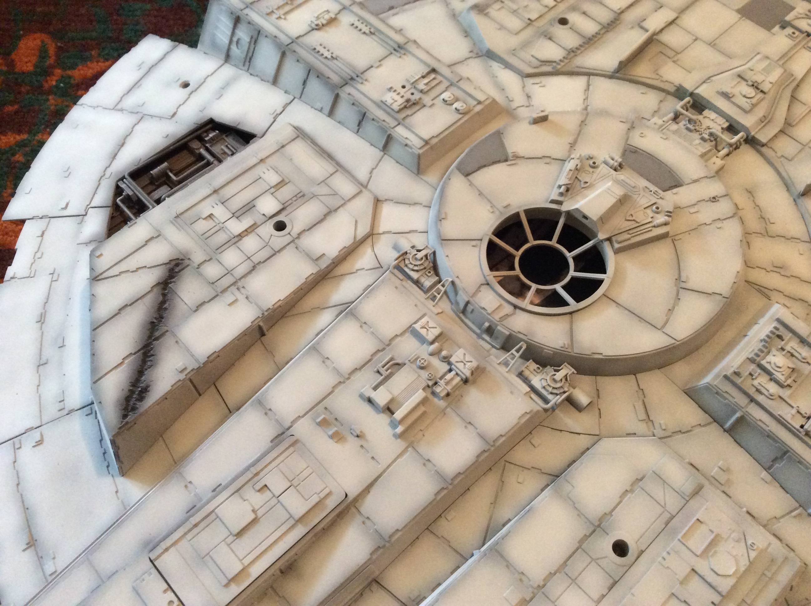

I'm about 18 months in. Mostly collecting parts. Every few months, I get motivated to build and catch up. The bottom is mostly done and it's time to start laying down paint.
My quick review. The kit is mostly awesome, though overpriced. Hard for me not to think that when you consider what you can buy for $60 in a hobby store vs what you receive each month. The only negative about this kit is battle damage. Easily fixed though with some putty, elbow grease, and dremel. That having been said, I don't regret the decision to dive in. It's nice to be close enough to see the finish line.
I likely won't do any weathering until everything is painted, because it's important this is consistently done throughout. I'm painting this the same way I would a tank or plane or jet. I'm a big believer in pre-shading. I use Tamiya's rattle can primer, and everything else is via airbrush. I pre-shade. Then I lay down thin coats of the base color until pre-shading is subtle to my liking. I then mix some white with base color and make some panels slightly lighter. I want each panel to have a slightly different hue, but I don't want it to look like a checkerboard.
