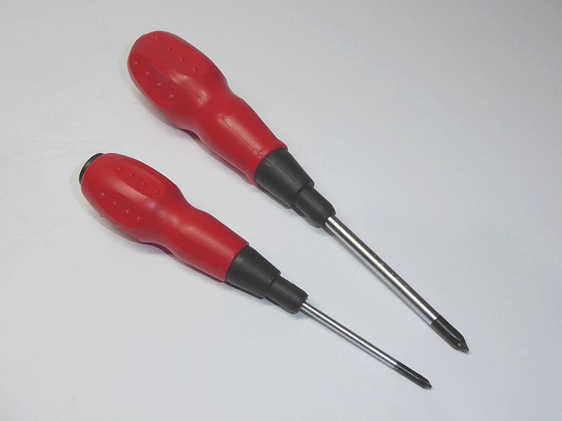

If it helps these are the only two screwdrivers I use with this build, also the only two I use with my Lamborghini build too.
They are Chrome Vanadium which I have had for about 15 years. I have just measured the ends, the black part just behind the phillips head, with my digital calipers and they are;
Small: 3mm
Large: 5mm
You can get a very good grip with these, both of which I have never had an issue with head stripping. The only issue I have had is with the large screwdriver as its very easy to over tighten a screw, in my case I overtightened it to much and sheared the whole head off Blink
I would certainly recommend a decent set of screwdrivers before going down the die and tap set.

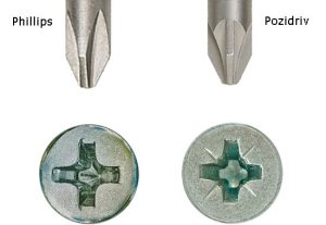

Make sure the screwdriver is a phillips, the left one in the picture below, and not a posidriv as a posidriv would certainly strip the head.

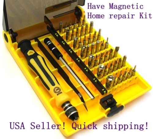

Thanks all, I just purchased this mini screwdriver set on ebay. I seen a lot of the videos through the DeAgostini website on youtube using this particular set.
I think I'll give it a try.

That looks pretty good.
A nice buy.
If you plan building some big kits in the future - and there are some beauties out there - a decent set of tools is a no-brainer.
Why spend upwards of £800 on a kit, then skimp on the tools to build it?
Have HUGE fun with your build. Enjoy it and don't be afraid to re-paint or add detail to the bits as you go. After all, it's in weekly parts.
