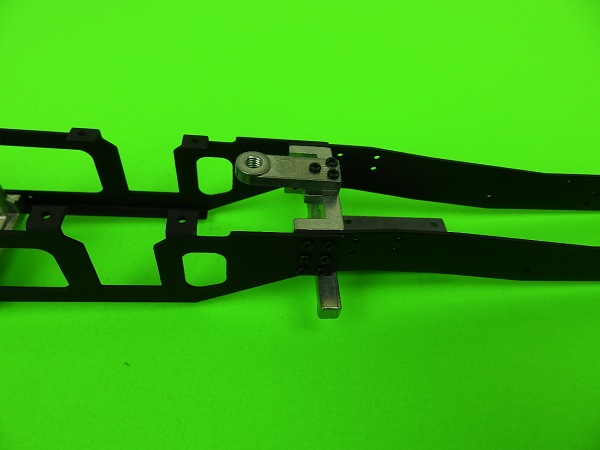

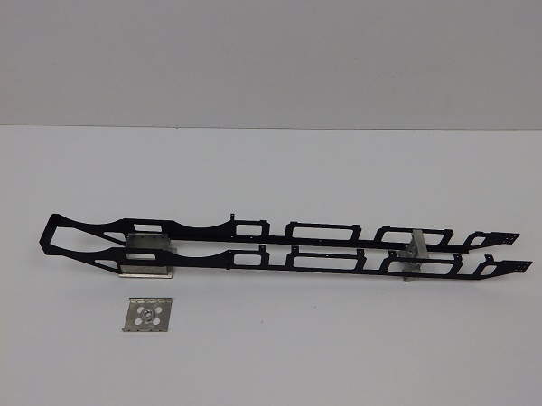

#1 Posted : 30 June 2016 17:24:54

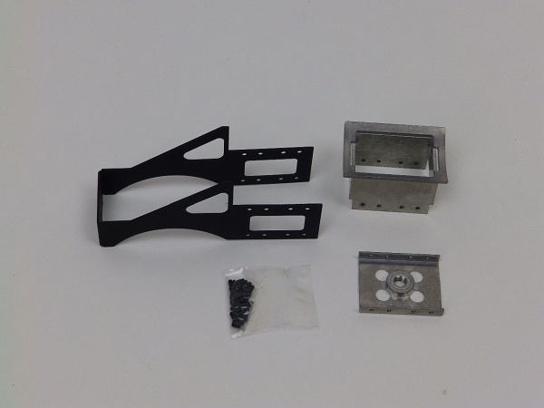

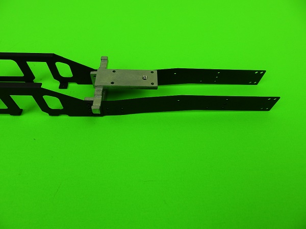

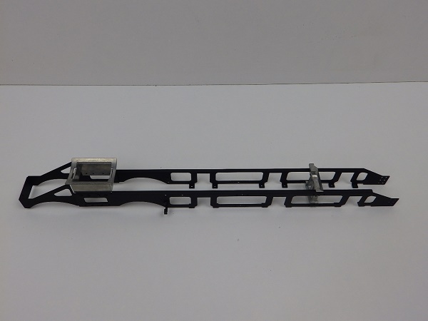

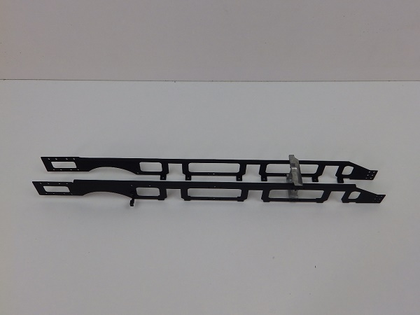

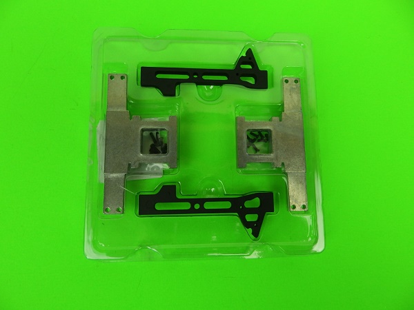

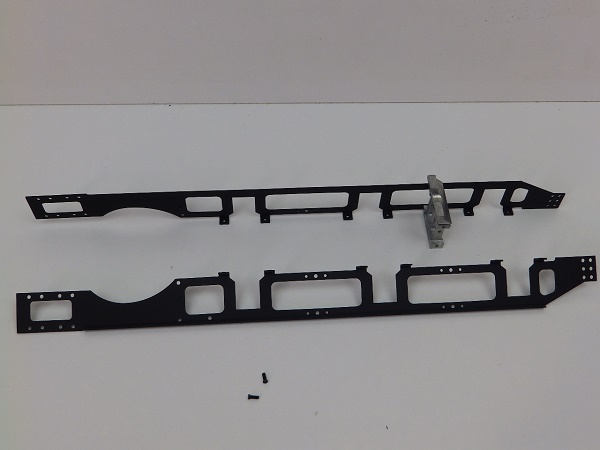

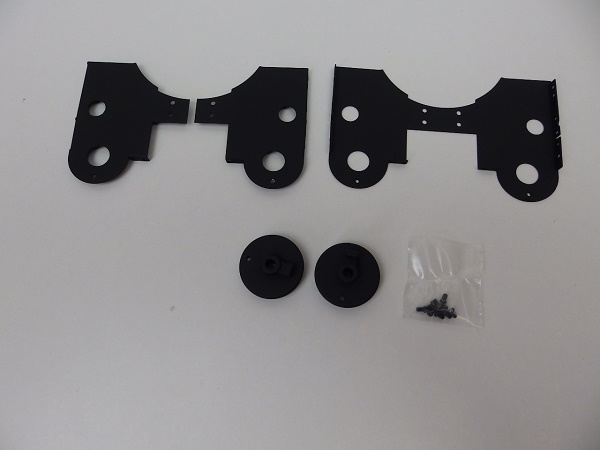

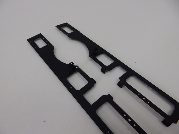

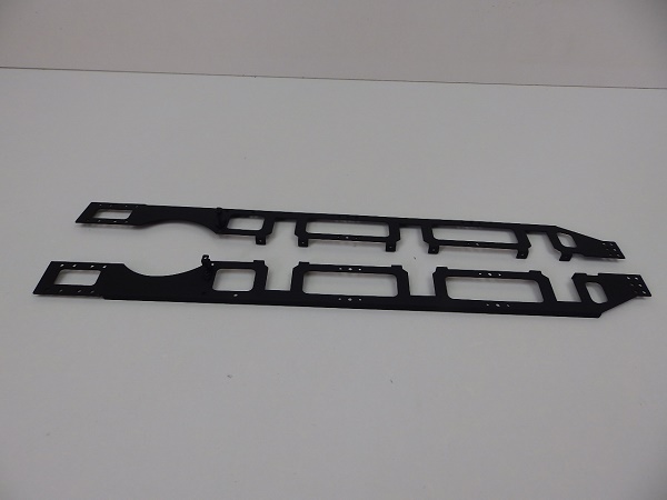

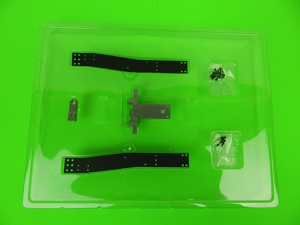

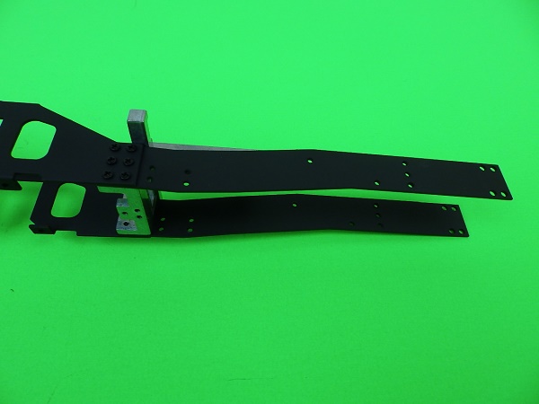

Stage 10

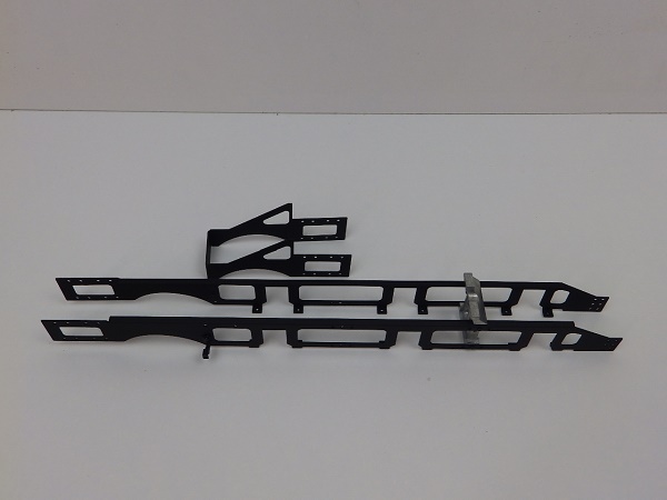

Your parts:- Left and right underframe, brake supports, underframe brace and screws
Take the left and right brake supports and fix them in place on the left and right underframes using two 2 x 3 mm screws. Next line up the brace with the underframe and fix both underframes to it using four 2 x 5 mm screws.
Save any unused in a bag labeled with the stage number for future use.
Stage complete.

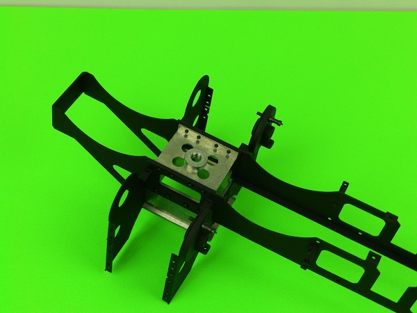

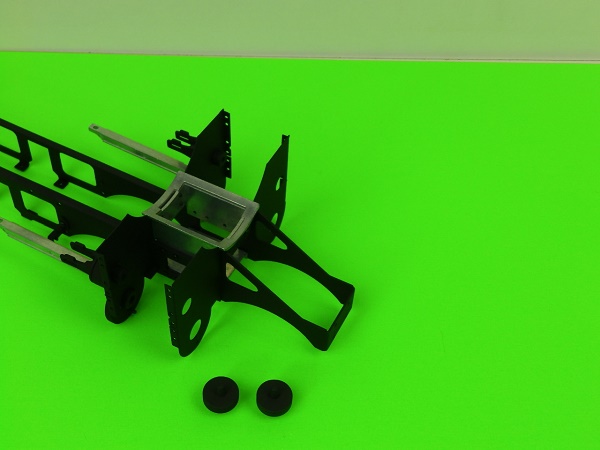

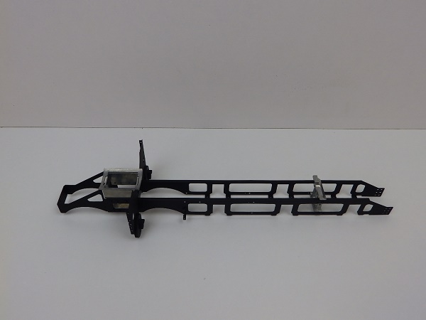

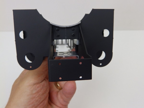

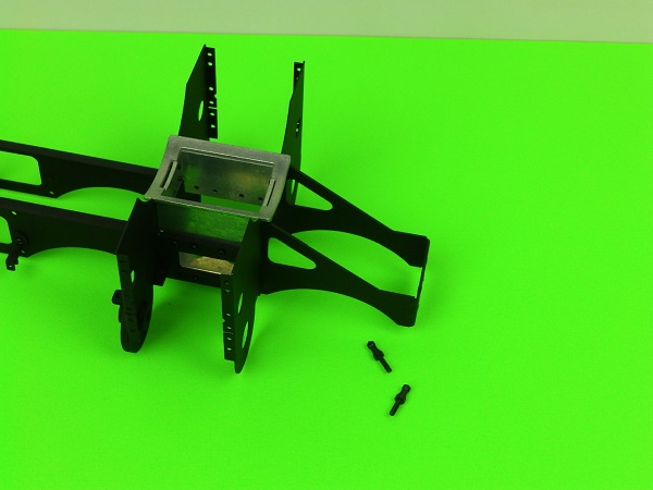

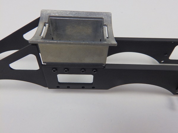

#2 Posted : 30 June 2016 17:30:28

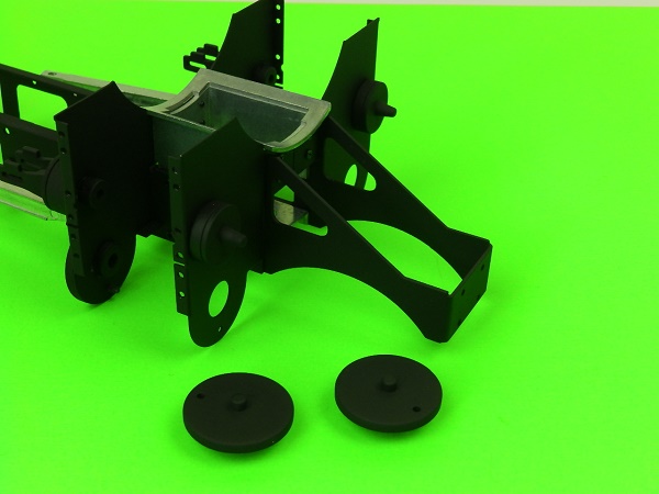

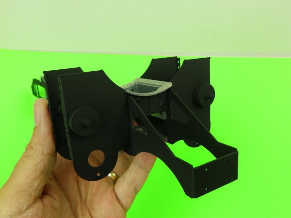

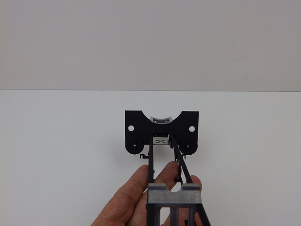

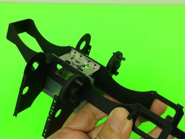

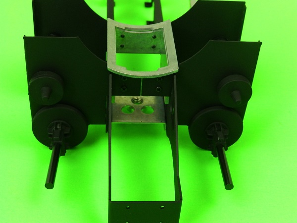

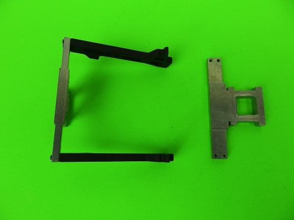

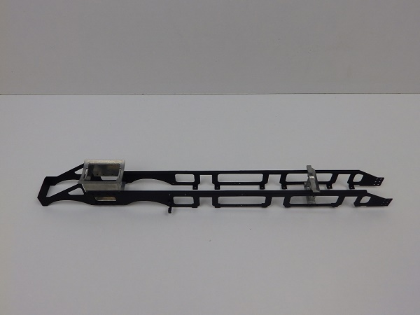

Stage 11
Your parts:- Front underframe, smokebox support, truck support and screws.
Take the main underframe assembly from stage 10 and gently squeeze the underframe front part together so it slides inside the main frame and line it up with the holes in the two frames. Next take the smokebox support and place it on top of the frame assembly in line with the screw holes. Screw the support to the frames using eight 2 x 3 mm screws.
Now turn the frame assembly over and add the truck support to the frame again lining it up with the screw holes in the frame. Once it is in position use eight 2 x 3 mm screws.
Save any unused parts in a bag labeled with the stage number for future use.
Stage complete.

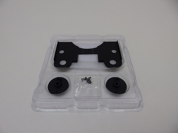

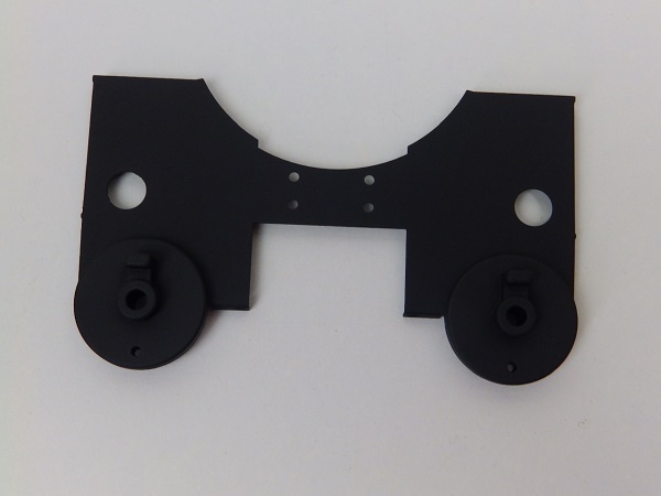

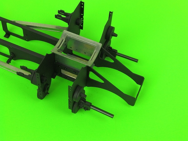

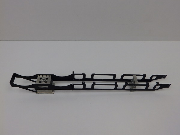

#3 Posted : 30 June 2016 17:34:00
Stage 12

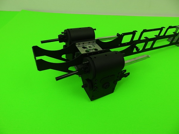

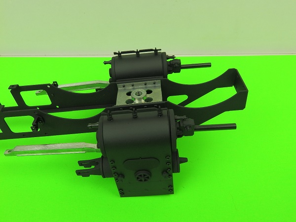

Your parts:- Front and rear cylinder plates, cylinder covers and screws.
Take the rear cylinder plate and screw two screws into the holes at the rounded ends, make sure the screw heads are on the inside surface of the plate. Next take the cylinder covers and glue them in place on the plate making sure to line up the holes in the covers with the two screws, Make sure you do not get glue on the threads of the screws. When the glue is dry remove the two screws from the rear of the plate.
Now take the two front cylinder plates slide one into its slot and fix in place using two 2 x 3 mm screws, do the same with the other front plate. Note that if the plates do not slide into there slots loosening the screws, then sliding in the plate and re-tighten any loose screws will cure the problem.
Next take the rear cylinder plate and fix it in position at the rear of the smoke box support using four 2 x 3 mm screws.
Stage complete.

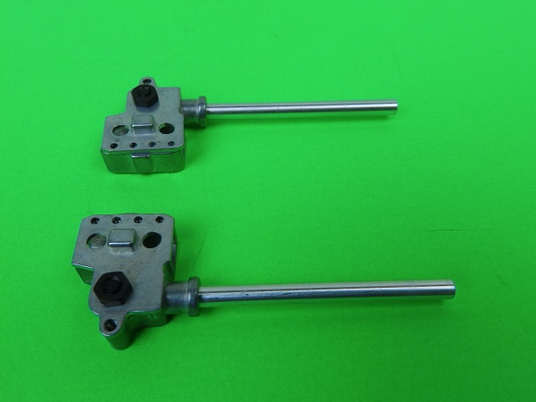

Take the main assembly and at the rear of the cylinder housing add the two safety valves too the lower end plates, screw them in until they are seated correctly. Next take the motion bars and making sure the oval holes are at the rear fit them to the lower rear cylinder covers using two 2 x 5 mm screws. Once the motion bars are fitted make up the rear upper valve guides and glue them in place above the motion bars making sure they are correctly aligned.

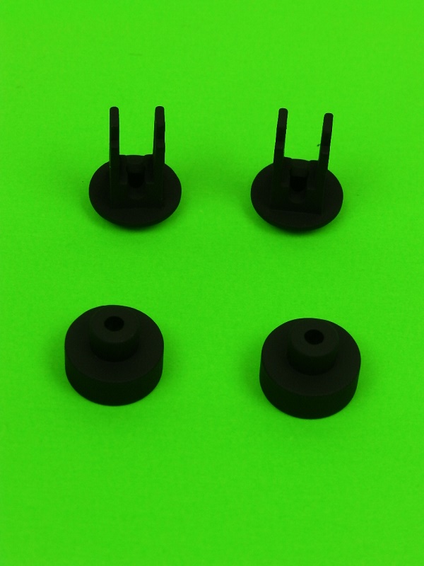

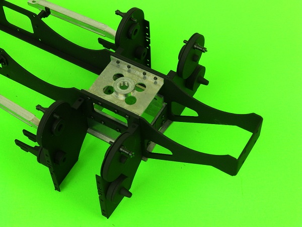

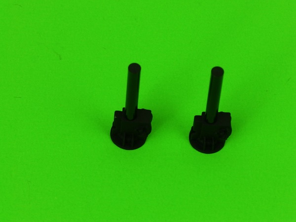

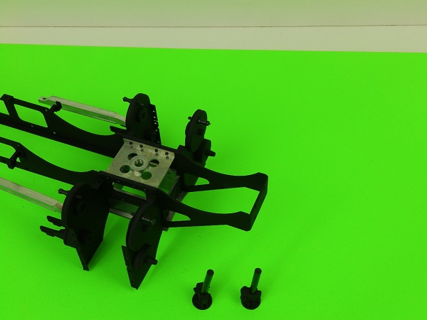

#5 Posted : 30 June 2016 17:45:13
Stage 14

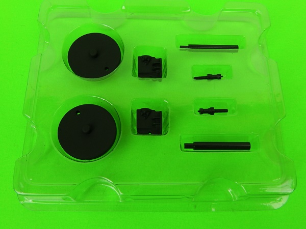

Your parts:- Piston rods, housings, cylinder covers and safety valves.

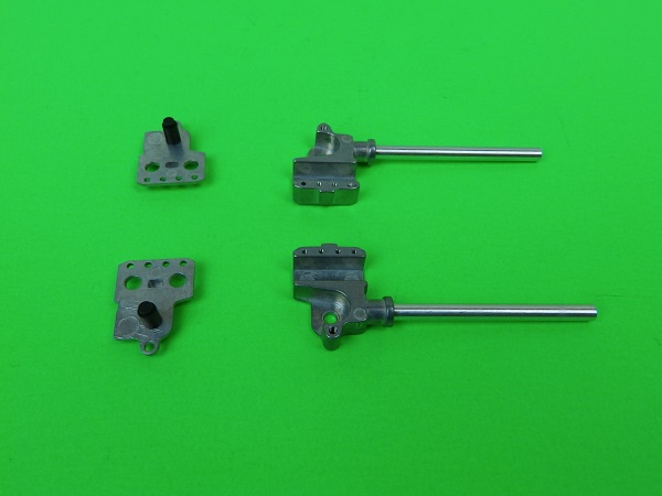

Glue the two piston rods into the two rod housings making sure the rods are vertical and straight . Next take the cylinder covers and glue them in position on the lower front cylinder plate making sure the holes are lined up on both parts as this is where the safety valves will fit. Next add the safety valves to both plates. You could fit the safety valves before the glue sets as this will aid in lining them up. Now take the piston rod housings and glue them in place on the lower front plate making sure again that the are vertical and straight.
Stage complete.

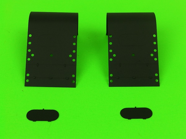

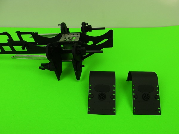

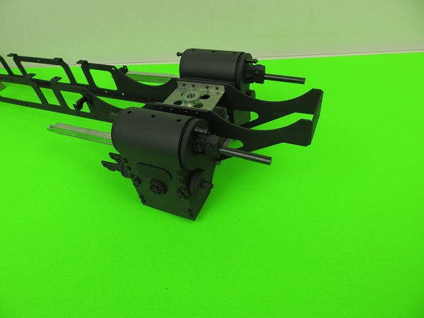

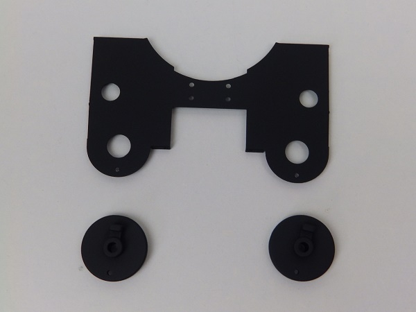

#6 Posted : 30 June 2016 17:49:00
Stage 15
Your parts:- Cylinder sides, valves, hatches, covers, drainage pipes and screws.

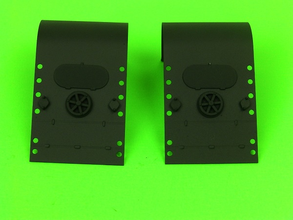

Take a cylinder side plate and then line up and glue an inspection cover to both parts you will see the position already marked to aid placement. Next take the hole covers and valve wheels and position them in place on the covers. Hold the parts in place and turn the plate over then apply glue to the studs making sure the end screw holes are free from excess glue.
Once the parts are dry take the left side plate and line it up with the screw holes on the left side cylinder plates, using fourteen 2 x 2 mm screws fix the plate in position. The best way to do this is to add all the screws at the front but only loosely fitted then turn the assembly upside down and fit the last two screws at the base, tighten these first and then do the final tightening of the screws on the cylinder side. Fix the right plate in the same way.
After the side plates have been fitted turn the assembly over and glue the two drainage pipes in position.
Stage complete.

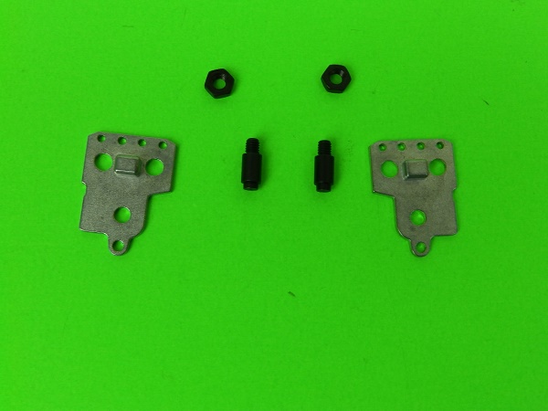

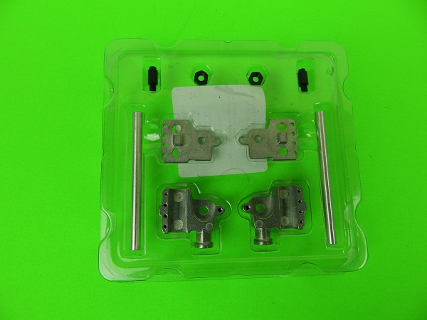

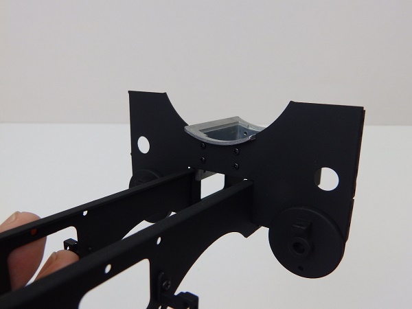

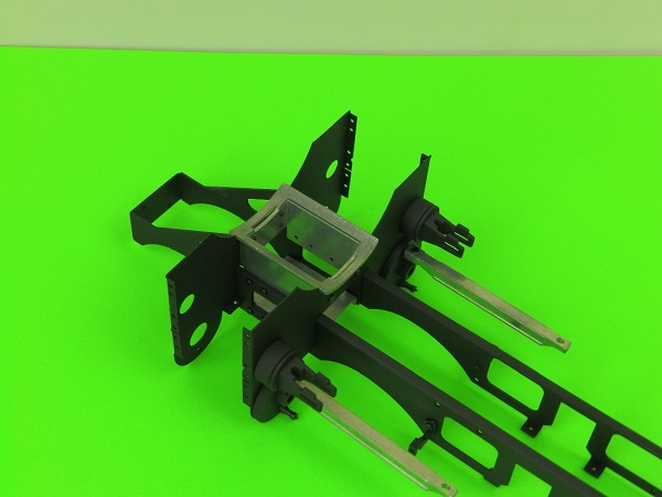

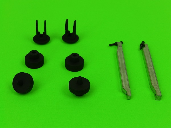

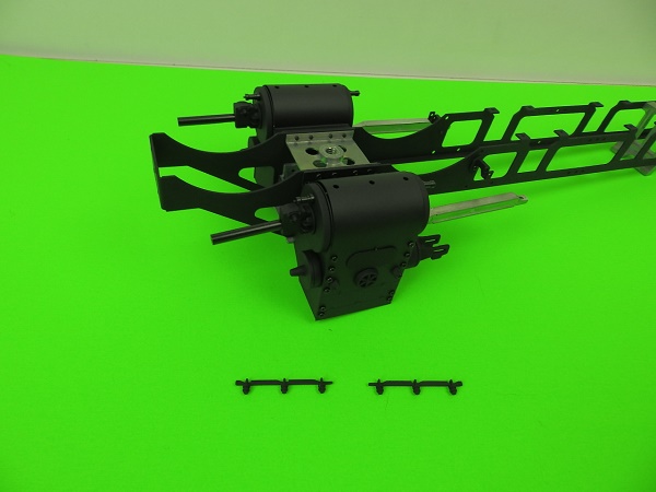

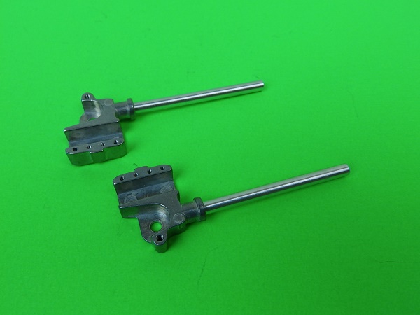

#7 Posted : 30 June 2016 17:54:35
Stage 16

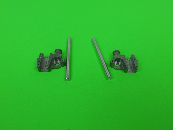

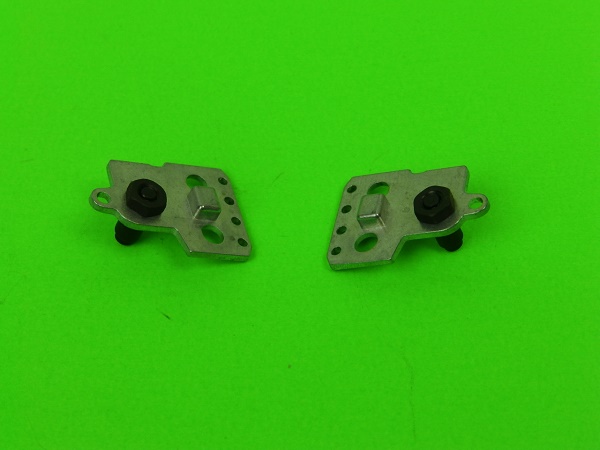

Your parts:- Crossheads, pins, nuts and bolts.

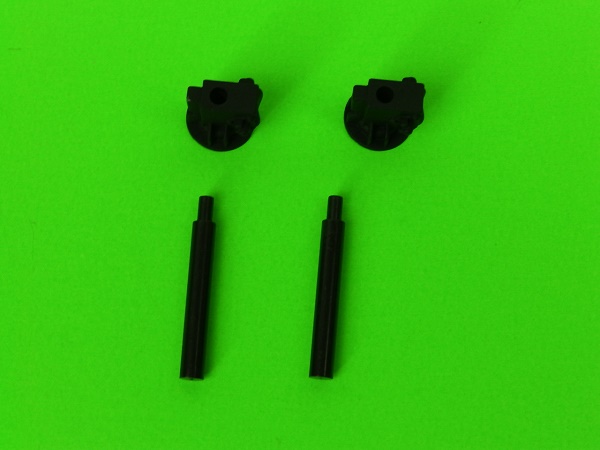

Take an outer crosshead plate and insert the pin from the inside so the threaded part is on the outside and fix in place with the nut ,do the same for the other crosshead plate. Next take the inner crossheads and glue the piston rods into the plates making sure they are straight and vertical to each other.
Stage complete.

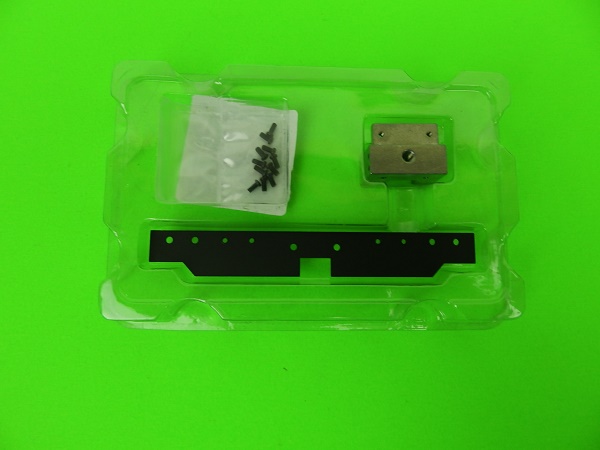

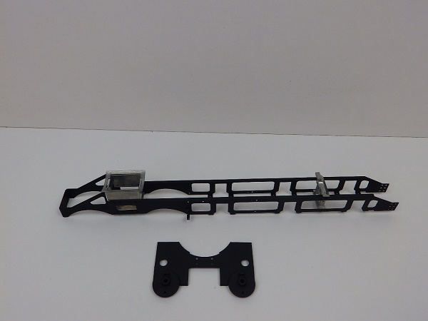

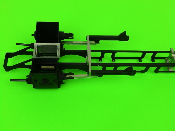

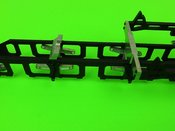

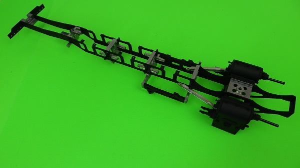

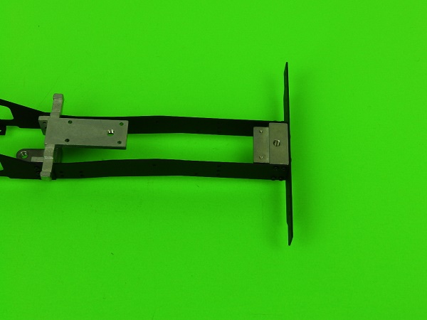

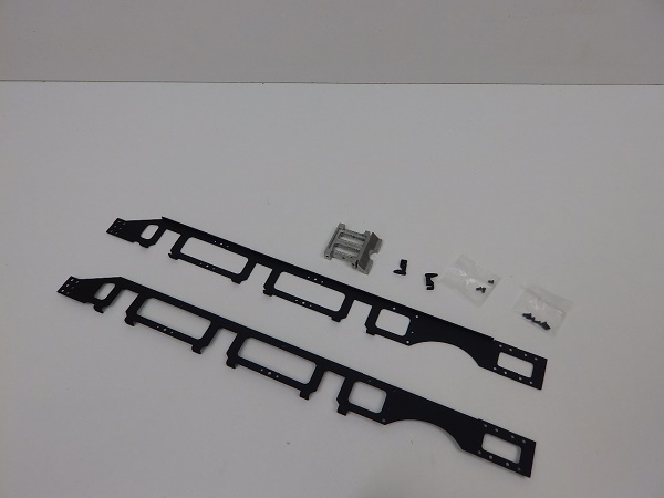

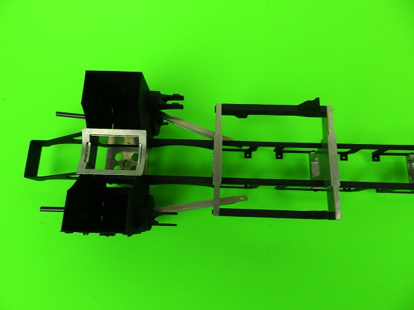

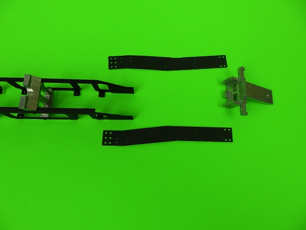

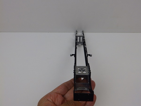

#8 Posted : 30 June 2016 18:04:09
Stage 17

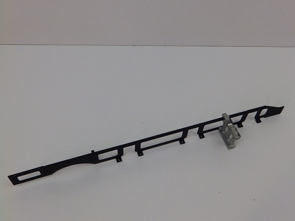

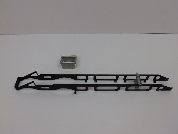

Your parts:- Underframes, support brackets and screws.

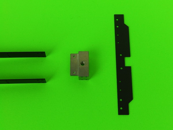

Take the main assembly and at the rear end place the support bracket in position then line up the underframes with the screw holes in all the parts, fix the parts together using six 2 X 5 mm screws. Do the same for the other side. Now take the expansion bracket and fix it in place on the support bracket with 2 X 8 mm screws.
Stage complete.

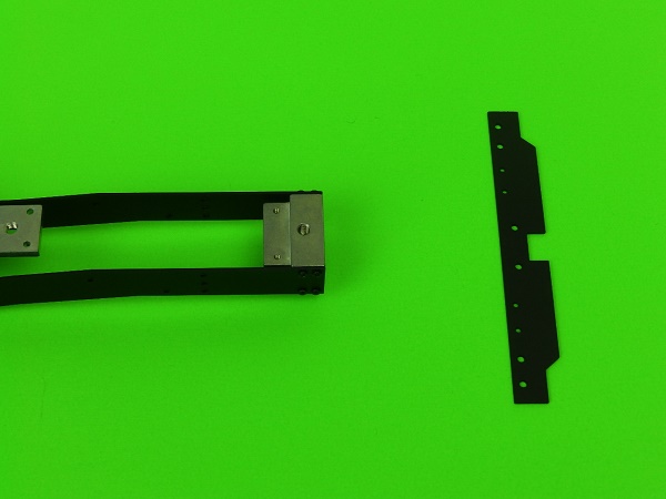

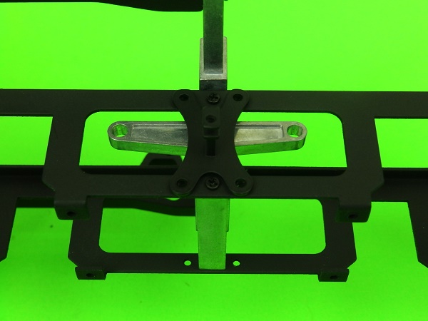

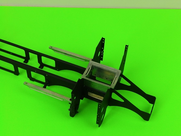

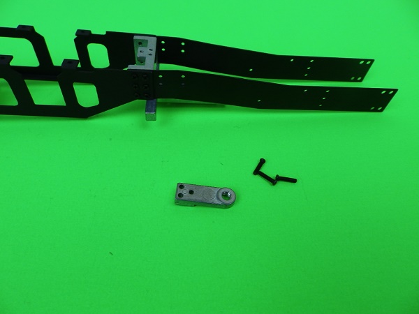

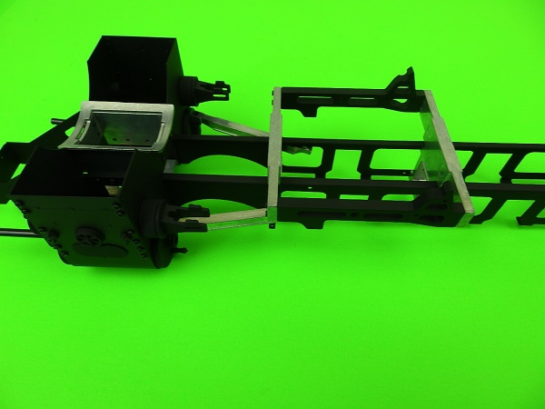

#9 Posted : 30 June 2016 18:05:58
Stage 18
Your parts:- End beam, end plate and screws.
Place the rear end beam between the arms of the rear underframe and line up the screw holes fix the beam in place with four 2 x 4 mm screws. Do the same for the other side. Next fit the end plate to the beam using two 2 x 4 mm screws making sure that the end plate and beam line up with the side plates and the top of the beam.
Stage complete.

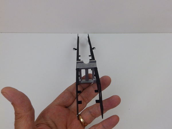

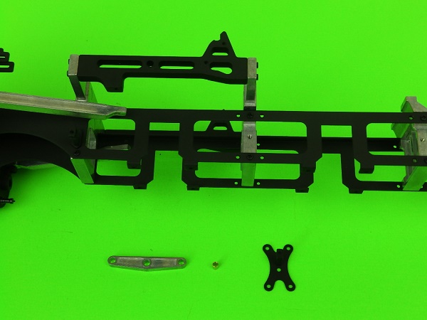

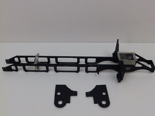

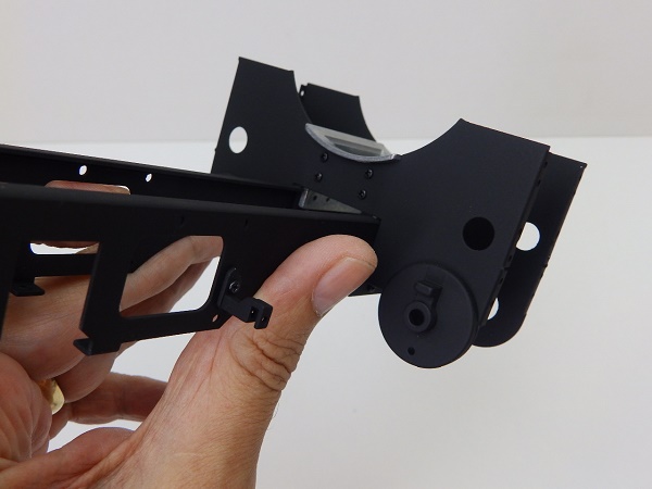

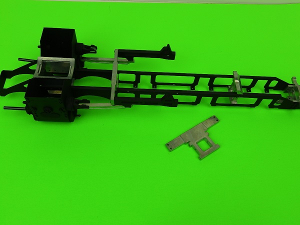

#10 Posted : 30 June 2016 18:09:21
Stage 19
Your parts:- Motion frame parts and screws.

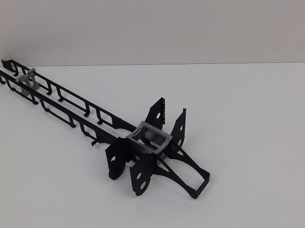

Take the two side motion frame parts along with the front and rear frames and assemble them then remove the rear frame. Take the front frame assembly and fit it to the underframe by twisting it into place and fixing it at the front with four 2 x 5 mm screws. Now fit the rear plate to the underframe using the same twisting motion to fit it and again use four 2 x 5 mm screws to fit it to the underframe. Lastly replace the screws at the top rear of the motion frame.
Stage complete.

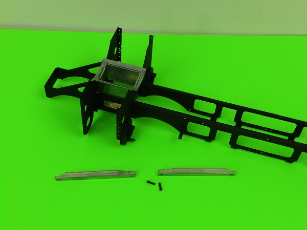

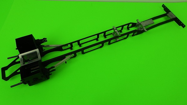

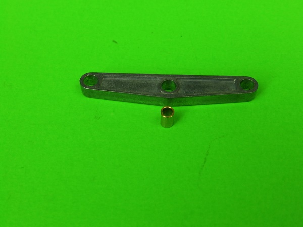

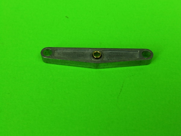

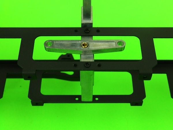

#11 Posted : 30 June 2016 18:11:42
Stage 20

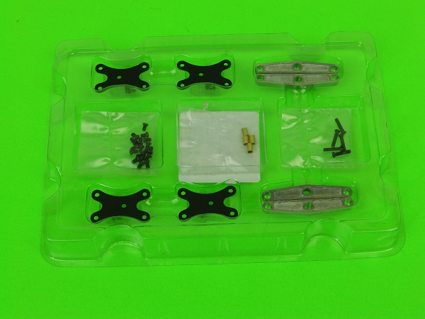

Your parts:- Equalising bars, brackets, bushes and screws.
Take an equalising bar and fit a bush to it then place the bar on the hole in the rear motion frame plate then take a bracket and fit it over the bar making sure the central hole is lined up with the bar. Once all is lined up fix the bar and bracket by inserting a 2 x 8 mm screw through the central hole in the bracket. Next use four 2 x 3 mm screws to fix the bracket to the underframe. Repeat this for the remaining three bar and bracket assemblys.
Stage complete.
