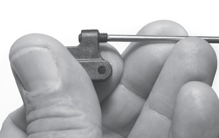

The parts supplied for Pack 03, Stage 12, the left front lower arm, should have included a long allen screw. This screw has been supplied with Pack 9 and should be fitted into the height adjustment block (Stage 12, part C) by following the instructions below.

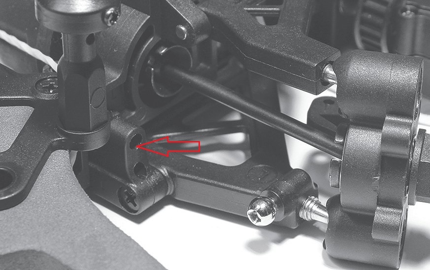

If you have already assembled the left front suspension of your Huracán, you will find the hole for the grub screw in the height adjustment block, indicated by the red arrow.
Tighten the grub screw into the hole, as shown, (the height adjustment block,
shown here on its own for clarity).
