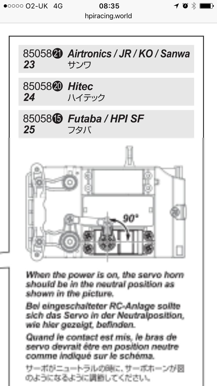

Hi, after watching the second video I can see at the end the servo horn is hitting the back of the right hand shock mount and the servo horn is not at 90 degrees to the servo when the wheels are straight. You could try setting the servo to it's central position with the servo horn removed, then setting the servo horn at 90 degrees to the servo. After this adjusted the main steering pushrod two get the steering straight. This is the general set up for all the rc cars I have built as the servo has more leverage on the wheels with it set this way.
I have attached a picture from my hip savage manual so you can see what I mean. Hope this helps
Regards Shaun
