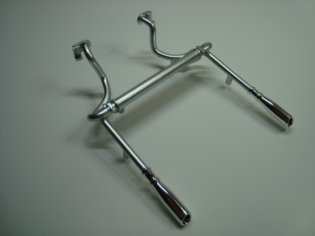

The lower silencer half has two cutouts at each end, for mounting the silencer inlet and exhaust pipes. Test-fit the right silencer inlet pipe into the cutout at the rear of the lower silencer half. Also check the fit of the right exhaust pipe in the cutout at the front of the lower silencer half.
Once you are happy everything fits combine the upper and lower halves of the silencer. Insert a 2.3x4mm screw into the hole in the silencer, the turn the screw a couple of rotations leaving a small gap between the ends of the silencer halves.
Hold the two halves of the silencer apart and insert the right silencer inlet pipe into the rectangular hole in the end. Hold the right silencer inlet pipe in place and insert the right exhaust pipe into the rounded hole. When both pipes are in place, tighten the screw full, making sure the mounting pins on the silencer and the pipes are all facing the same way.
Open out the other end of the silencer and insert the left silencer inlet pipe into the rectangular hole. Then insert the left exhaust pipe into the rounded hole. Secure the left end of the silencer with a 2.3x4mm screw like you did with the right side.
Take the right tailpipe and align the tip with the hole in the end of the right exhaust pipe. The tip and the hole are both D-shaped. Test-fit the tailpipe and then secure it with a drop of instant adhesive or superglue. (Whenever you use superglue, always follow the manufacturer’s instructions and safety advice). Test-fit the tip of the left tailpipe in the end of the left exhaust pipe,
then glue it into place using the same method as the right tailpipe.

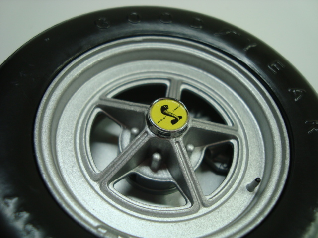

Issue 08
Right Front Brake
Parts content:
Steering Knuckle
Brake Disc Shield
Brake Disk
Brake Caliper
1.2x3mm screws
2.3x3mm screws
Shelby Logo Wheel Cover

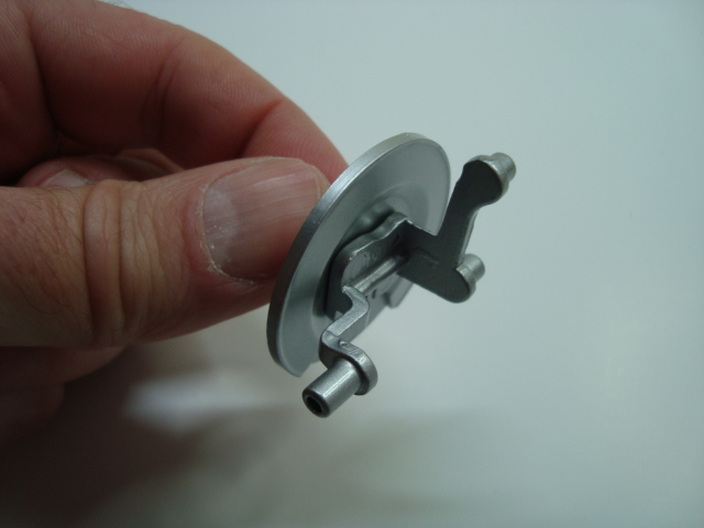

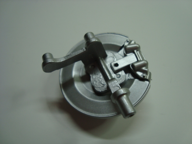

Take the steering knuckle and the brake disc shield, and align the studs with the holes, then push the steering knuckle into place on the brake disc shield.
Now hold the brake disc with its flat side facing the knuckle and disc shield assembly. Then fit the two together by pushing the spindle through the hole in the centre of the brake disc. The disc should rotate freely on the spindle.
Slide the brake caliper over the brake disc in the recessed area of the shield so that the holes of both are aligned, then fix the parts together with a 1.2x3mm screw. The disc should now be held in place by the caliper, but it should still be able to rotate freely.
Take the brake disc assembly and insert it into the inside of the wheel. Rotate the assembly until the lug on the wheel fits into one of the notches in the brake disc.
Finish off by pushing the Shelby logo wheel cover into the hole in the centre of the wheel, covering the screw.
Issue complete, carefully store any remaining parts in a labelled bag

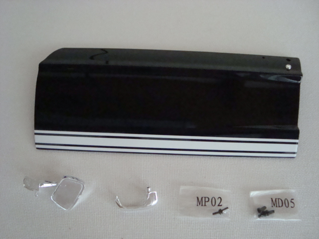

Parts content:
Left Side Mirror
Left Door
1.8x3.5mm screws
Left Door Handle
1.2x3mm screws

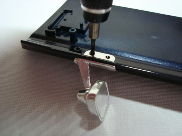

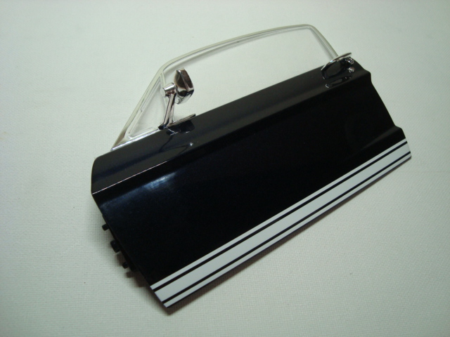

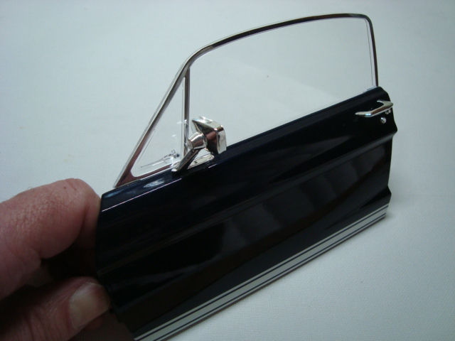

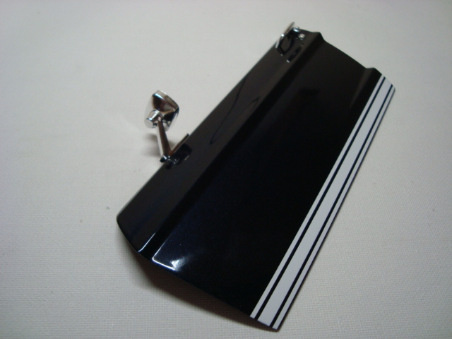

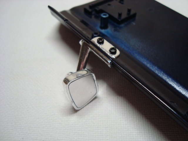

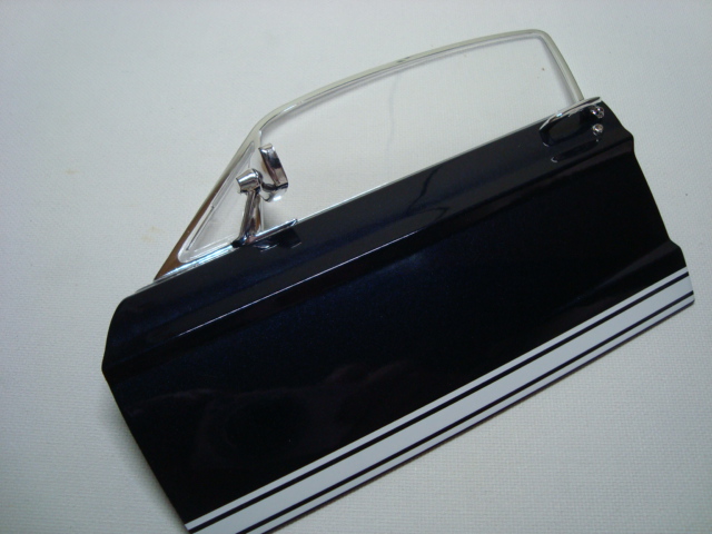

Take the left side mirror and note the shape of its base. Now hold the left door with the inside facing up. Insert the base of the mirror into the slot in the door. After placing the mirror base into the slot, position it so that it rests on the posts on the inside of the door. The holes in the base should align with the holes in the posts, now fix the mirror to the door with two 1.8x3.5mm screws.

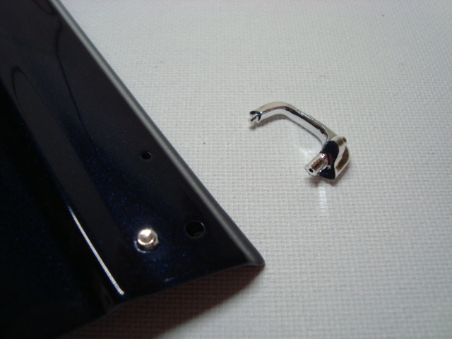

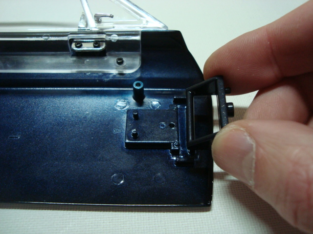

Next, align the pins of the door handle with the corresponding holes in the door and push the handle into place. Tighten a 1.2x3mm screw into the post on the inside of the door to secure the handle.

Retrieve the left door and place it on your work surface with the inside facing up ensuring you handle it carefully to avoid damaging the mirror or handle, perhaps use a towel or soft tissue to put it on so you don’t scratch the paintwork.

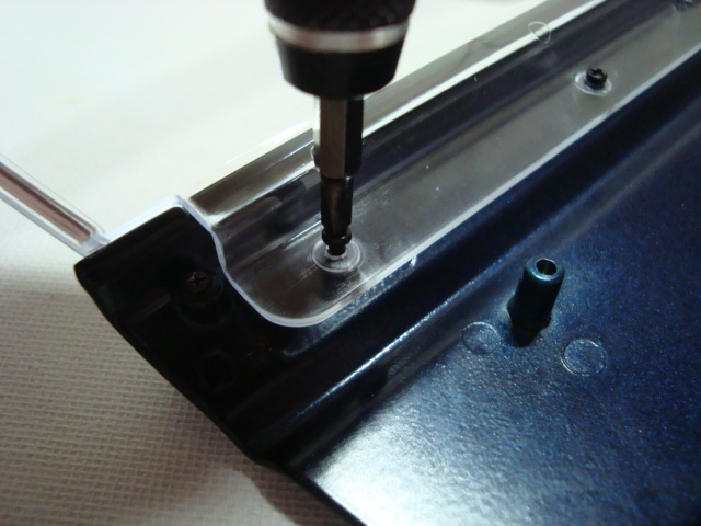

Locate the three posts and hold the window locating the three holes along the bottom edge over the three posts on the door. Check that the cutout in the window is properly positioned over the base of the mirror and then push the window down onto the posts.
Half-tighten a 1.8 x 3.5mm screw into the hole in the window nearest the front of the door. Half-tighten another two 1.8 x 3.5mm screws into the other two holes in the window and then fully tighten all three screws to secure the window in place.

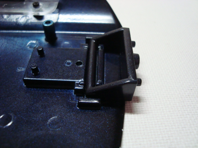

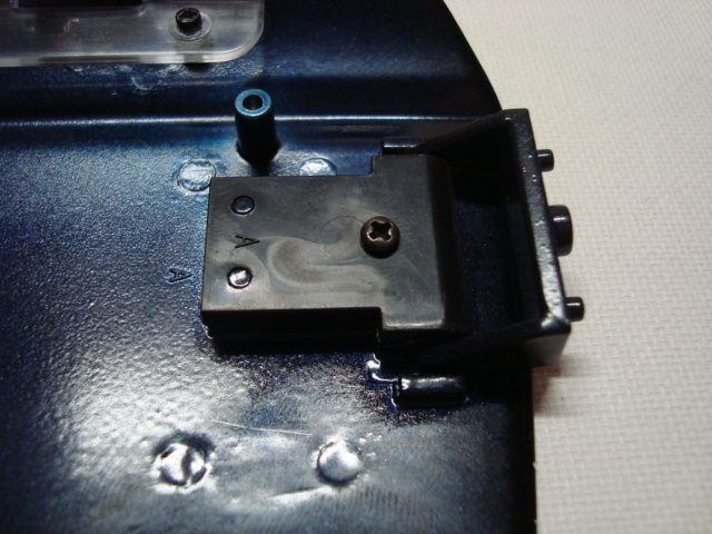

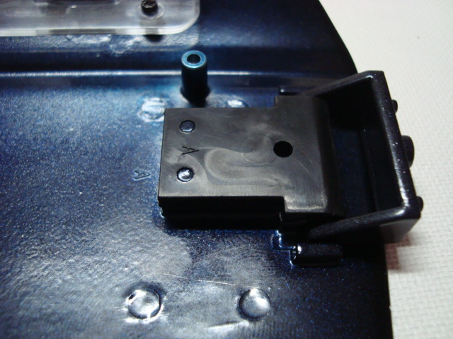

Hold the hinge, next to the front edge of the door with the long straight edge facing away from the door. Place the hinge into the grove at the front of the door and then align the holes in the hinge plate with the pins on the door. Lower the plate into position so that it covers the hinge and fix in place with a 2.3 x 4mm screw.
Check that the hinge pivots freely, so that it will allow you to open and close the door once it is fitted to the car. If the movement is restricted, loosen the screw slightly.
