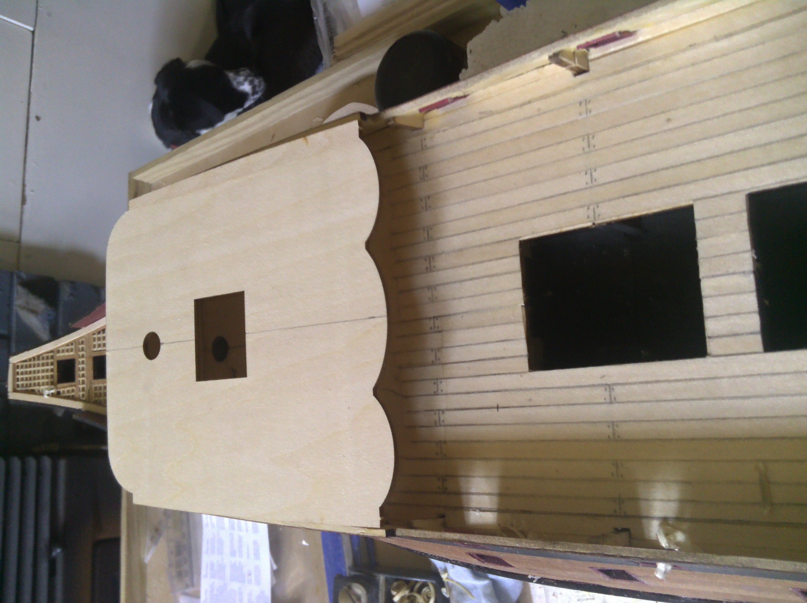

Photo of my problem.

BigGrin Hi Craigo I had the same problem but an easy fix. I cut out a peace of ply from the scrap that the parts was fitted to and glued it to the sides of the deck . Once dry , fit and trim . Hope this helps rgd Martyn

Confused Thanks Martyn but my problem is at the stern end it does not overhang at all it actually sits inside the hull sides at the stern end. At the bow end it's perfect.

Hi Craigo, this is a problem many of us found and is easily fixed. If you take a look here you will see I had an identical problem..... Hope this helps.

BigGrin Thanks Alan. Seeing that reinforcing and the added material to fix the problem is great. I didn't want to just burge on as I wasn't shore how it would effect the build further down the line.
