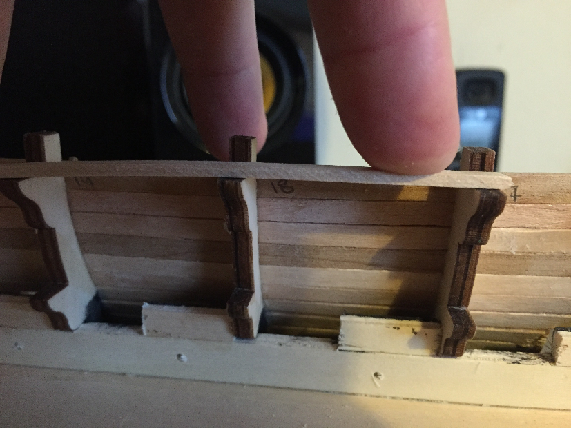

Hello again everyone,
My build is going very slow due becoming a brand new dad :-)
I've nearly finished planking the top half of the victory (pack 3)
I noticed when marking the frame height 4mm above the brackets that the brackets on frame 18 are quite a bit higher than the other frames. By about 3mm. So this means the deck would bulge up at frame 18, but at both 17 and 19 it would be lower.
Is this normal or a fault? It wouldn't be hard to correct it but I just want to be sure how it should be.
Many thanks in advance :-)
Neil

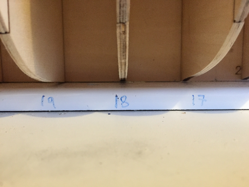

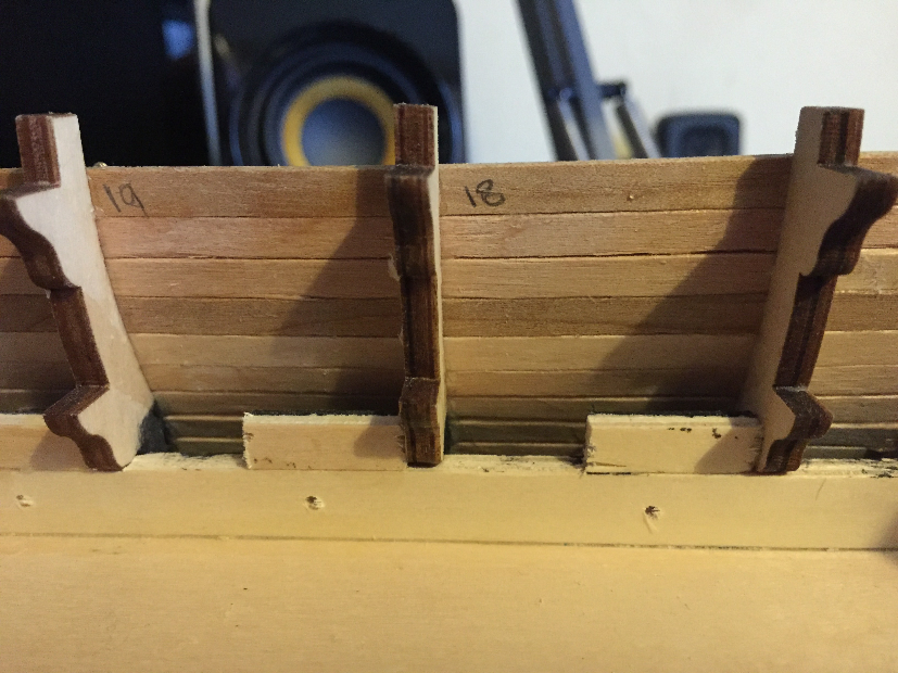

Hi Everyone!
Thank you for the rapid replies. I didn't expect to wake up to all of that advice.
I must admit I don't like the thought of unsticking the frame. Surely it would be easier to trim a bit off the top of the brackets?
I can confirm it is the same at both sides. Also it is seated properly at the bottom. The lowest deck sits fine too.
I have attached some images of the top with me holding a plank so you can hopefully see how raised up the brackets on frame 18 are. Also a picture near the false keel so you can see that it is seated properly.
I look forward to your replies :-)
Many thanks,
Neil

There's the problem right here
Somehow the side arms of the frame sit higher than the surrounding ones.

I've just double checked it and your right. It does sit higher. But it confuses me why the bottom of the frame sits flush with the bottom of the keel.
Any way at least we've established it is a problem and now I need to work out the best way to correct it.
Is it best to cut the tops of the frames below the lower bracket and shorten them? Or just trim the tops of the brackets down?
Thank you for your support :-)
Neil

Well it doesn't look as bad as I imagined it to be from the text description. I think you'd get away with sanding down the bracket to the correct height.
Note I'm not as far into the build as you so any advice is conjecture and you should probably listen to someone further ahead in the build.

Hi Neil, thanks for posting the pics it makes things a lot clearer. As Greyhawk has said it is not as bad as it could be and it certainly looks as if frame 18 hasn't been fully seated into its slot. In this instance I would probably reduce the support brackets on frame 18 to ensure decks is level across frames 17-19. You will also need to check the level on the next deck down as you may have to do the same thing there. Finally, you may also have to add a packing strip to the bottom of the frame when it comes to planking the lower hull otherwise you may end up with a dip.
Hope this helps.
