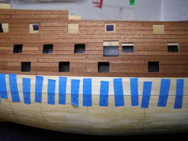

G'day Tim,
Another option for you to try out. I am using blue painter's tape cut into small strips (about 1.5 inches long, then cut the strip width way onto two). The blue tape has just enough adhesion to hold the planks in place. This I found was advantageous to ensure that the new laid strips butt up flush against the previous.
Take care though when peeling off the tape when finished to avoid removing any splinters from the sapele. I did not encounter this, but just in case. I found that I could use the strips twice and marked the re-used with an X so I could keep track of the new and used. I am currently planking the lower hull and provided a photo of my method.
Ciao,
Adam

That's a great idea, Adam. I happen to have some painter's tape on hand. I'll give this a try. BigGrin

Hi Tim,
No drama, different strokes for different folks. Suggest that you do a dummy run on some scrap just to be sure that the tape you use does not mess up your end result. I'm using Scotch 3M brand.
Ciao,
Adam
