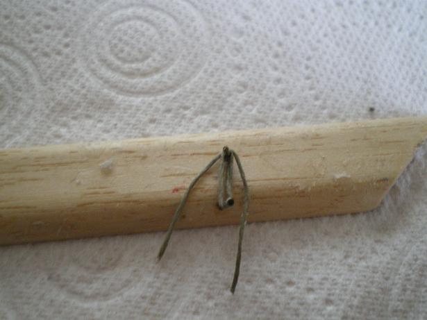

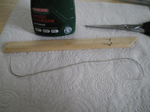

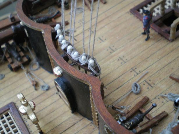

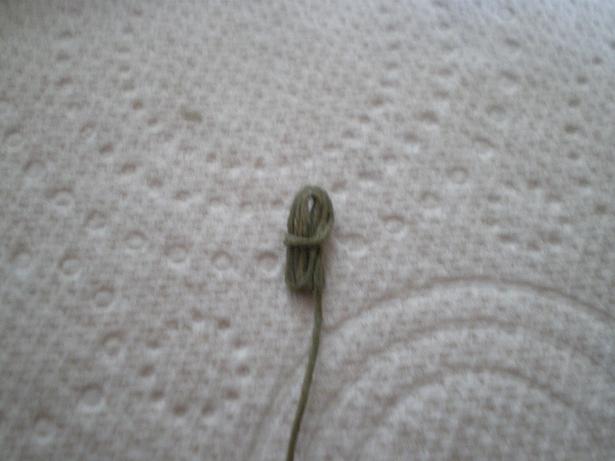

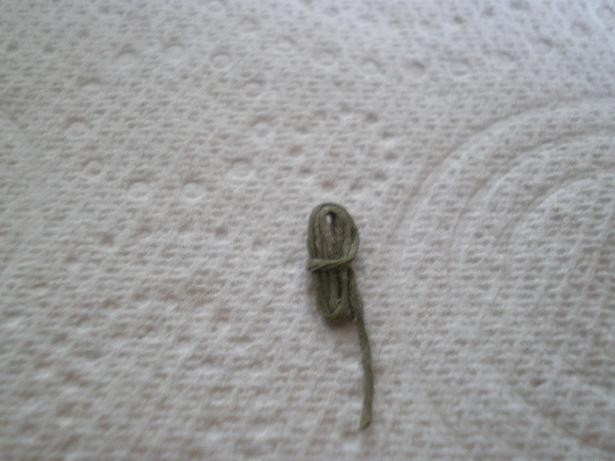

All you need is a scrap bit of wood and two pins and some PVA glue
Push the pins into the wood aprox 10mm apart and cut the heads off.
Cut a length of cotton and rub some watered down PVA onto the cotton and then wrap the cotton round the pins then slide the rope off the pins trim one of the ends back to the rope and hide it round the back . The long end can be passed round or left loose . Let dry then place over the belay pins and bend down to look like they are hanging down Cool
Hope this helps rgd Martyn
Ps if you move the pins you can make smaller or biger ones Cool

Great tip Martyn, I will try and remember this when I come to rig my Trinny althought its a long way off yet Cool
