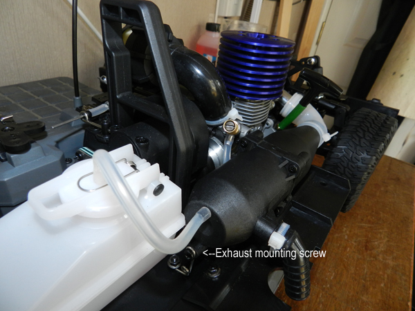

Anyone had the same problem or is it just me?
The carburettor adjustment screws are hidden behind the exhaust and the only way I have found of getting to them is to release the exhaust mounting screw. Have I got a larger silencer box?
Any clues anyone?
Alec

Sorry, not quite there yet, but even the "press release" photos seem to show this is how it is. Slight design fault I guess.

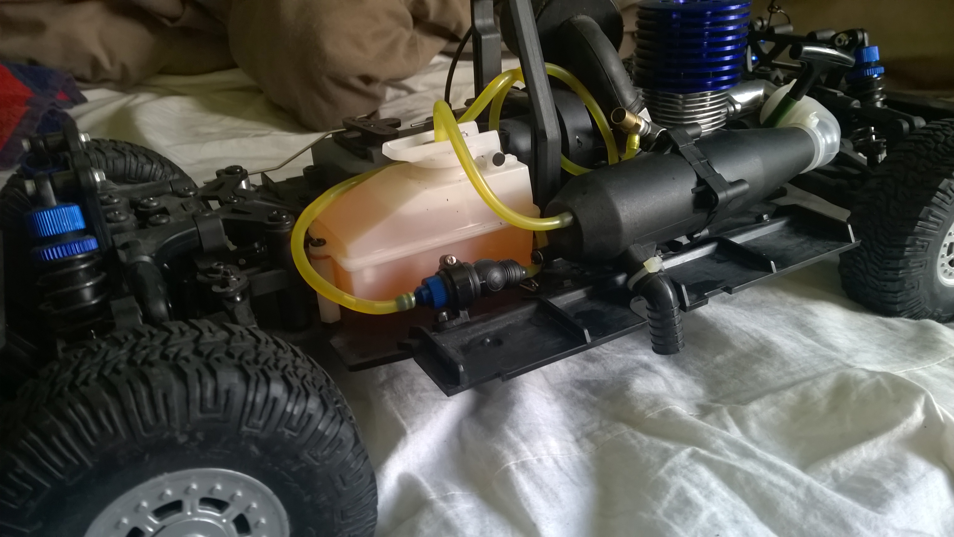

Still struggling with the carb adjustments, I cannot seem to get it right, I think it is and then I run it and it stalls when I release the throttle. I have followed all the instructions but it's not right. One instruction says fuel needle valve four turns out from shut another says two and a half to three is ideal. I guess I play around until I have some luck.
I have had two instances of the throttle servo doing its own thing regardless of the hand control, and switch on sequence has been followed carefully as per instructions. Worried about this, as so far I have been able to stop the engine before any damage occurs. Loved building the thing but not enjoying running it so far.

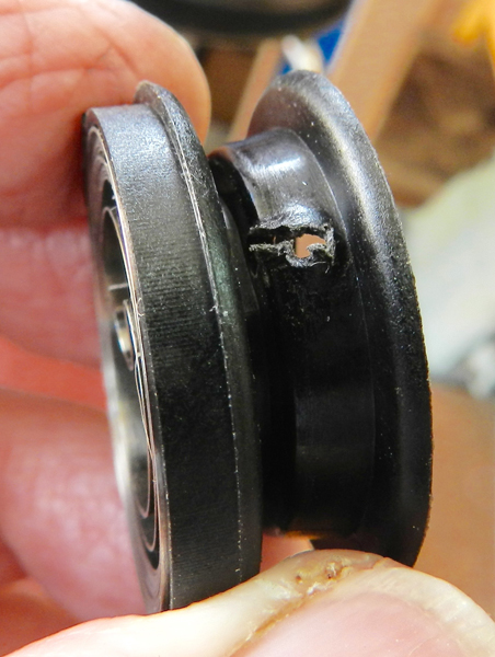

My fault I think because pulled too hard but starter cord has pulled through the pulley. I've done a temp repair but will have to try and get another starter if that is possible. Every one be aware! picture attached.
Alec

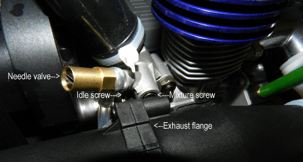

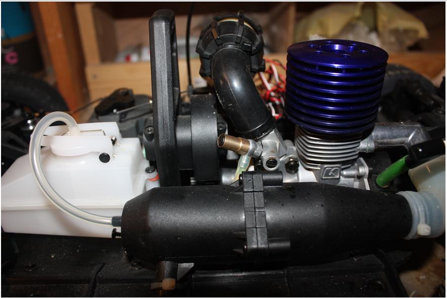

Sorry I keep forgetting to check my Hummer but I am pretty sure there was nothing in the way of my low speed needle / mixture screw.

Got the same problem
Having problems starting my Hummer, have even got a replacement carb but it is still difficult to start and the position of the adjustment screws does not help.
As you say the only way is to remove the exhaust.
I did manage to start mine by removing the glow plug adding a few drops of fuel in the piston replacing the glow plug. This worked but is a bit of a faff.
