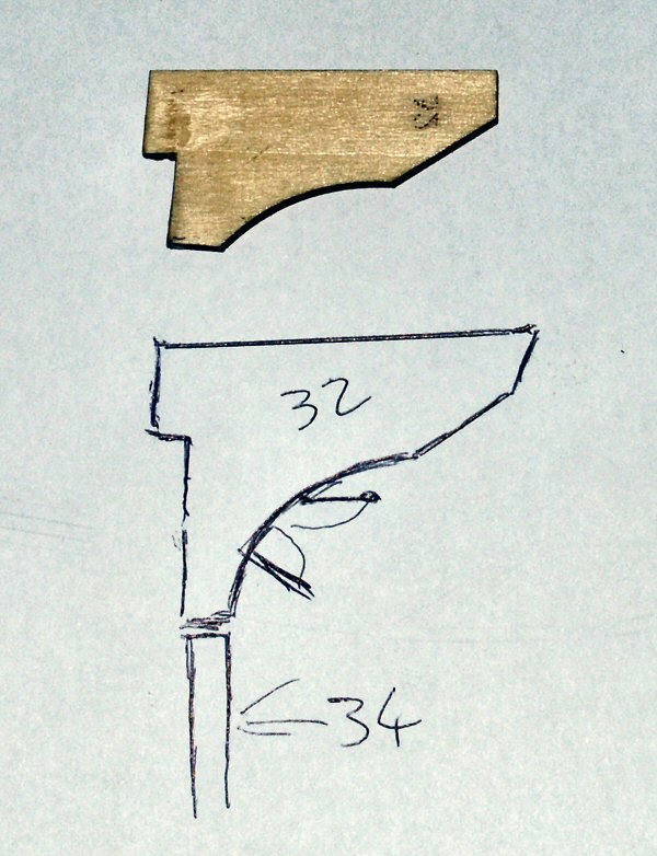

Time for drawings on this build!! Tomicks cut out 16 gun ports on the lower deck but as far as I am aware the front one in the bow is closed, if this is the case it would be easier just to score round your gun port template to give the effect of a closed port. There is only 30 guns on the lower deck and its the front port that doesn't have a cannon, on the dvd it shows it closed, so drawings would be a great help. Obviously they cannot supply us with all the drawings of the build (the experienced amongst us would simply jump ship and scratch all the way home) but drawings of the stage where at would be helpful.
On another point parts 32 on the stern, the concave shape on them seems far too shallow i.e. the rear gunports dont seem possible and without drawings showing that area I`m not happy fitting them, I`ve done a rough sketch of what I think is more acceptable but without drawings on that area it seems a bit tricky to convert,, I`m all for scratching but scratching without drawings is inventing and thats pushing it a bit far

I think Willz means the 4 gunports on the stern, looking at his drawing.
