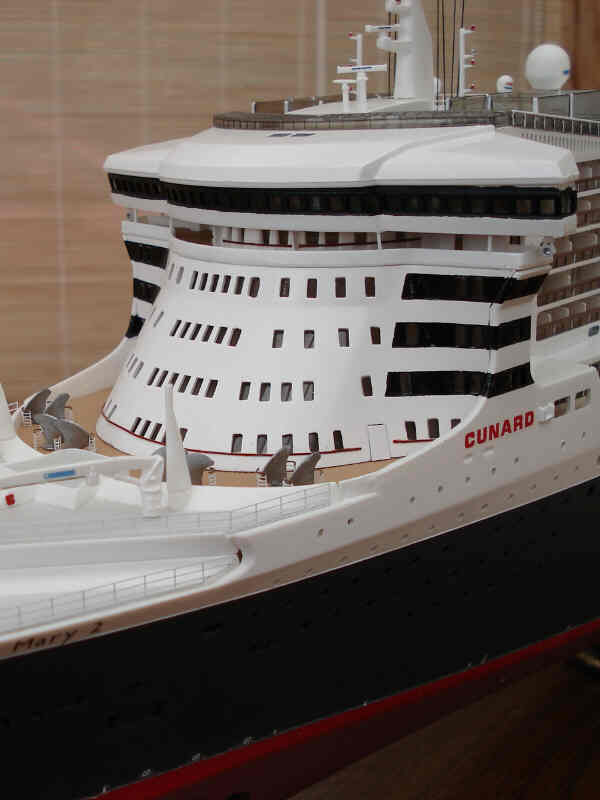

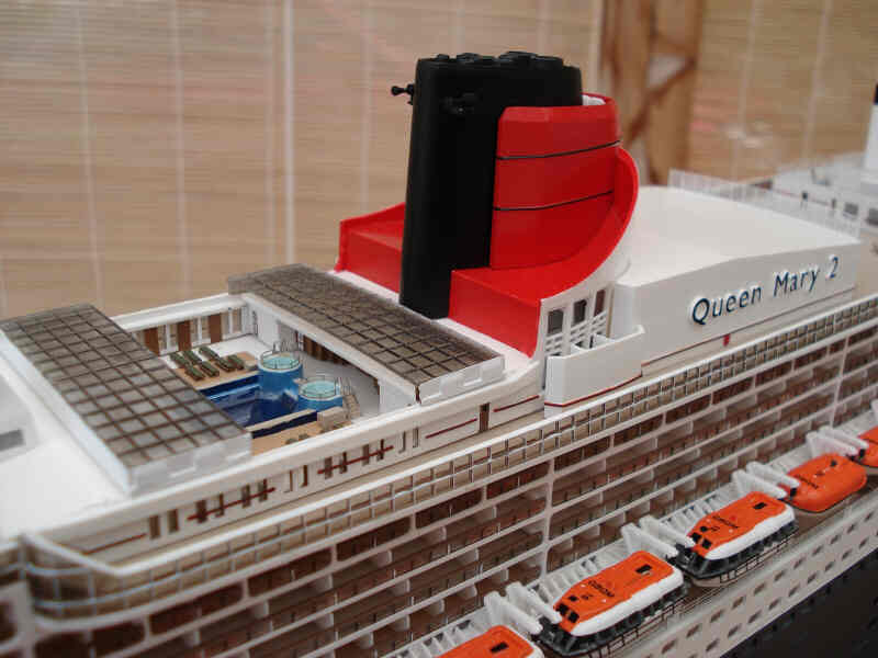

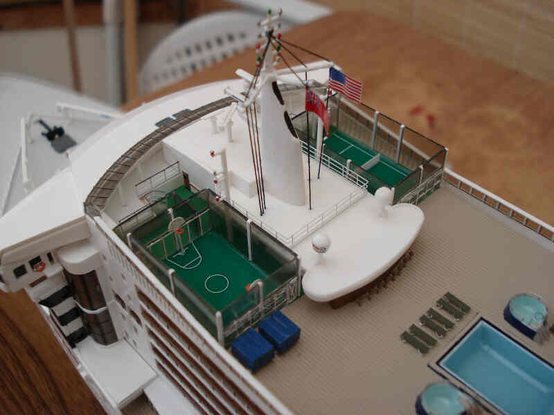

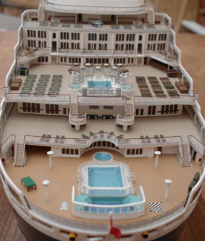

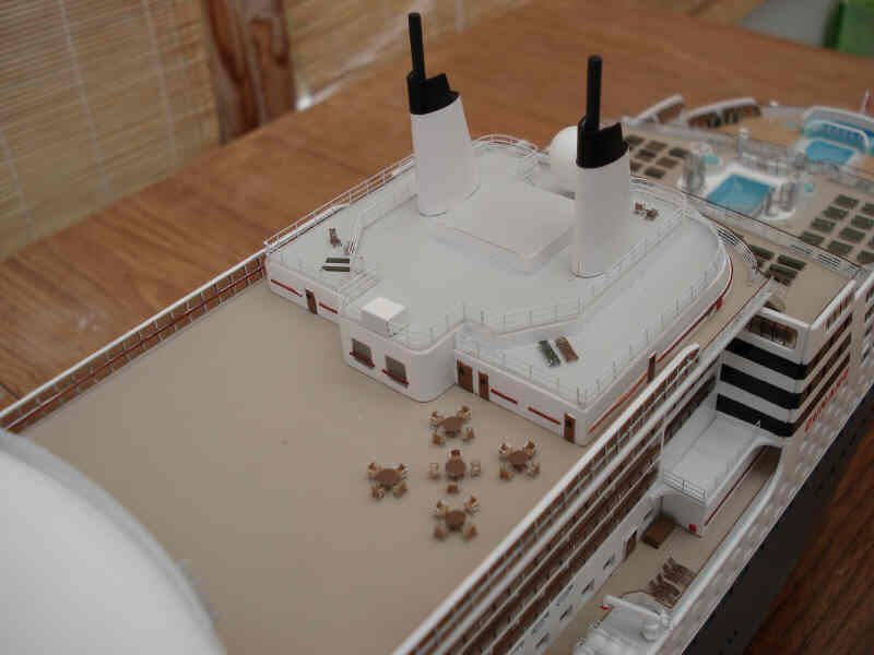

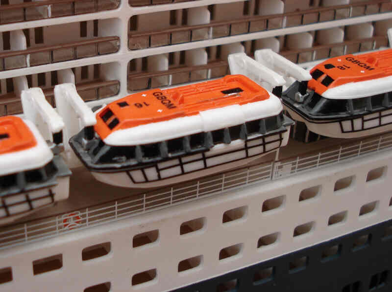

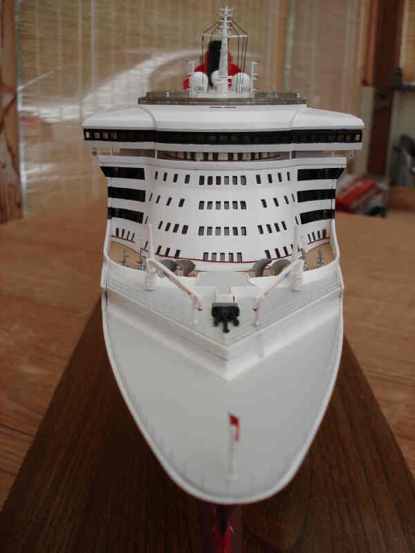

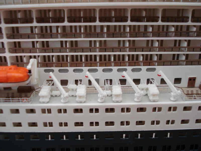

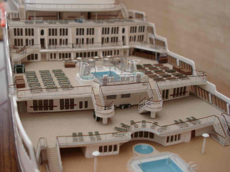

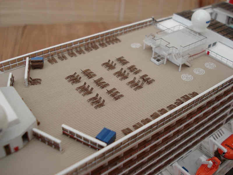

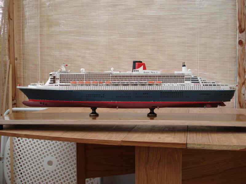

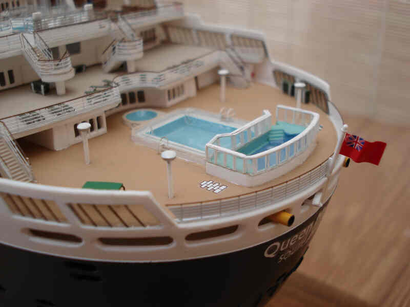

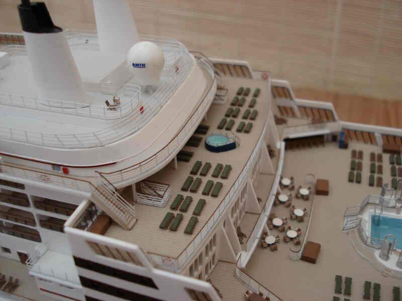

Early last year I found a relatively cheap kit on ebay and decided to have another go at this build. The plan this time is to illuminate the ship with a combination of leds and fibre optics.
But to get this diary started (and work out how to post photos) here's a few pics of my first attempt.
Regards, Colin.

Colin
Beautiful model you have yourself there.
Revell really do put out some unusual and big kits. You have done this one full justice and it looks top notch in its display case.
Very well done.

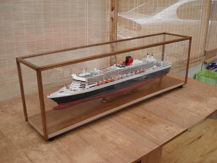

Thanks for the comments.
Yes it is big. In the case it's just over a metre long. Too big for the house so since it was built it has lived in my local travel agent's window.
The etch kit is from Gold Medal Models. That was partly what convinced me to buy the second kit on ebay as it came with the GMM etch set. For the same price as the etch kit alone! I got the Revell kit FREE. At least that was the way I explained it to my wife.
I've sailed on the ship four times now and comparing the thousands of photos I have with the model I discovered that there are a few inacuracies. So I wrote this "fix list" which may be useful for anyone who wants a more accurate model. The steps and part numbers are as listed in the supplied instructions. I know it's not exhaustive and I know I will find more as I go through this second build. I didn't fix all of these last time and I'm pretty sure I wont do so this time.
tried to attatch it as a Word document but that didn't work.

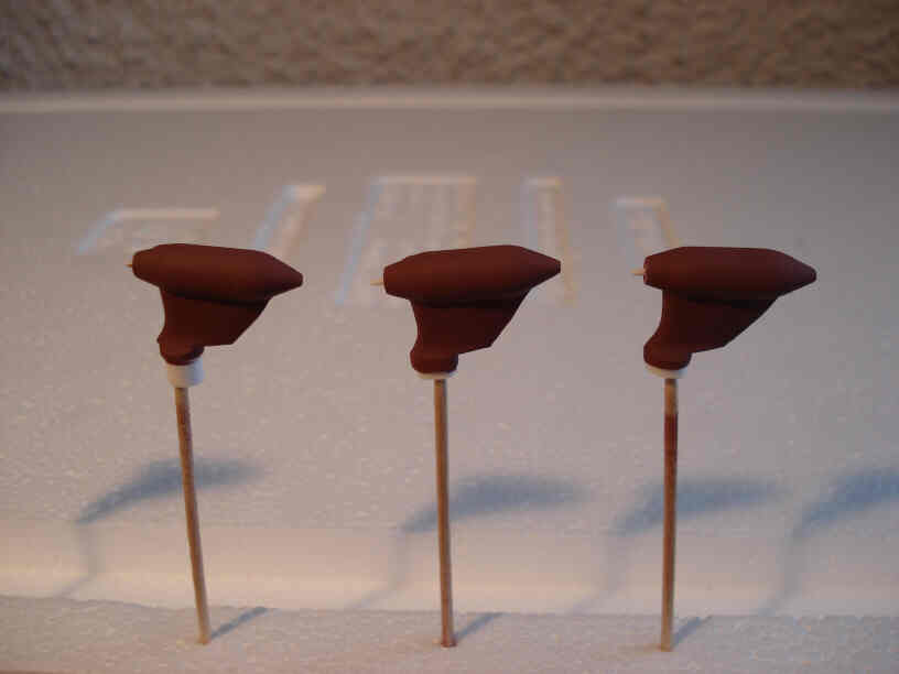

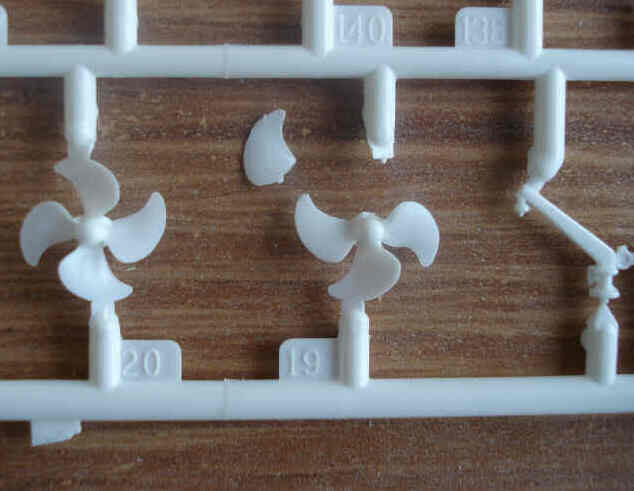

OK. So I've been doing little bits and pieces of the new build and buying lots of stuff, but haven't posted anything yet. Sorry about that.
Almost every review I've read of this kit has said that the stairways at the back of deck 7 (promenade deck) have been snapped off but I've been lucky both times. The only damage that I've found (so far) is one of the props. There were two other parts loose inside their poly bags but they had come off the sprues cleanly with no damage.
Some of the mouldings seem a lot messier than I remember and required a lot of tidying up.
The last time, without paying too much attention, I managed to assemble the pods with all four propshafts spinning freely. This time, being extremely careful, I've managed to stick two of them solidCursing

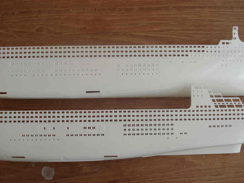

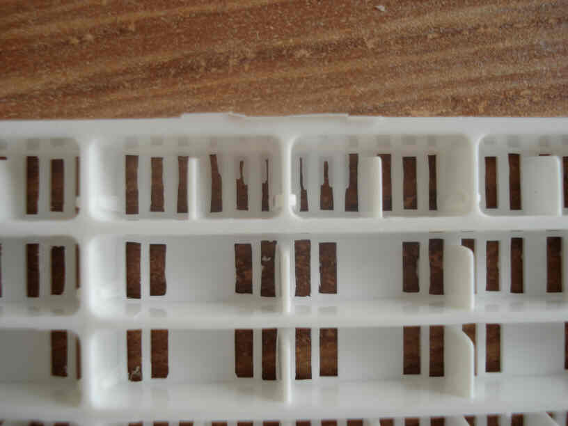

With this being an illuminated model the first major task is to open all the windows / portholes / etc. in the two hull pieces. Searching around the web there seems to be two schools of thought on this and I'm now begining to think that I've chosen the wrong oneBlushing.
The first method is to sand down the inside of the piece until all the material in the window has been removed. This seemed like rather a lot of work and quite risky.
So I went with the other option and drilled out the portholes and cut out the windows. The drawback to this is that, when studied closely, the window frames now seem rather thick. I'm trying to convince myself that it's not too bad and hoping that it's even less noticable once the dark hull paint is applied.
The aft internal bulkhead cuts across some of the restaurant windows so I'm moving it further forward (against the aft stabaliser cover)

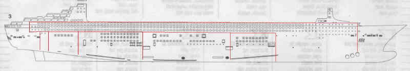

I've given the lighting some thought (like five or six years since I finished the first modelBigGrin). It started with "wouldn't it be cool to have flashing lights in the disco" and developed from there. The current plan is to divide the hull into various lighting zones as below and by using different leds and/or different resistors, to vary the lighting slightly in each of the public rooms.
