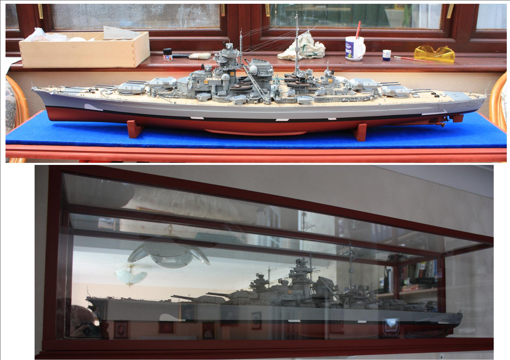

I made my own case for my model of the Bismark
The size as follows:-
140L X 39H X 30D (Centimeters)
I used 4mm glass sheets, as opposed to plastic which I feel over the years will mark more easily than glass
The frame is made of lengths of 2cm X 2cm which I routed out to accommodate the glass
Also as I was wall mounting the cabinet the back "panel" is a mirror so that you can see the other side of the ship.
The completed case stands on a base (see picture) Sorry about the poor quality of the picture of the case but the glass and mirror cause a lot of reflection
Cant remember what it cost to build but I have no doubt it was cheaper than buying ready made.
