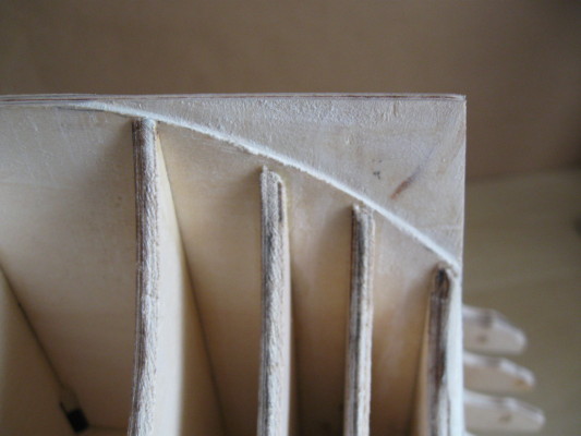

First, in the States we get monthly parts deliveries rather than weekly as appears to be the case across the pond. Each monthly delivery seems to include 10 packs - my first delivery is of packs 1 through 10 and the build instructions/magazine is a single volume - yet the instructions are still provided based on each pack as the next assembly step(s). So, given that I have received all of the parts for the false keel, does it make sense to assemble the entire keel before attaching the first bulkhead as shown in the instructions for pack 1?
Second, as I look through the official build log, it appears as if there is a bearding line and rabbet at the stern area of the false keel. Is this something done after pack 10 or am I misinterpreting what I'm seeing in the photo? If it is a bearding line, would it make sense to wait until after drawing and carving it before attaching the first bulkhead?

With regard to your question, not sure what part of the official build you are looking at but there is no beading or rabbet line.
There is a requirement to narrow down the false keel at the stern following the frames and this is done at the faring stage, perhaps this is what you mean? (pic below)
If I have misread what you mean then please post some more info as to which part of the build you are looking at. Good luck with it anywayBigGrin

Thanks for the reply. Yes, that was what I saw in the picture. Thanks for clarifying it for me.
