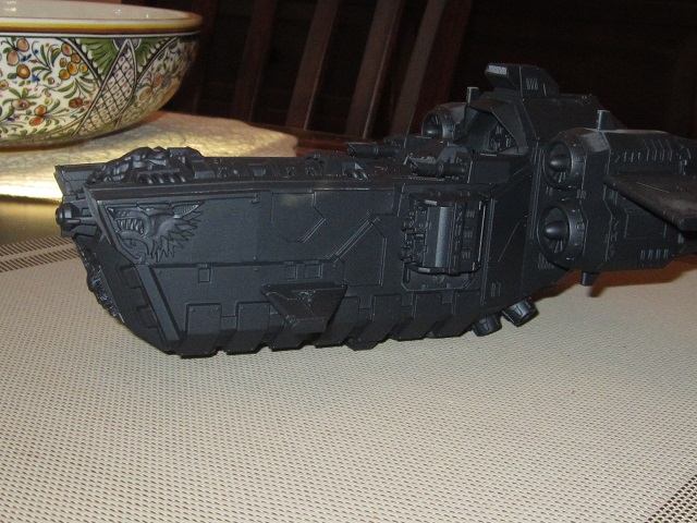

Here it is with a black primer
I will post pics after each separate paint is applied.

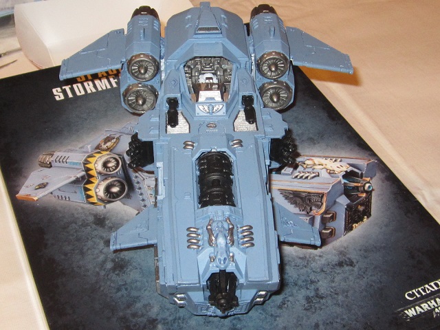

#7 Posted : 08 April 2015 06:13:41
here is the gunship with all the base layer paints applied.I did actually strip it down and start over because it was really streaky.definitely need to thin the paints a bit to get a smoother finish. I am gradually learning how to use this paint.
next step is shadows and highlights of the colors

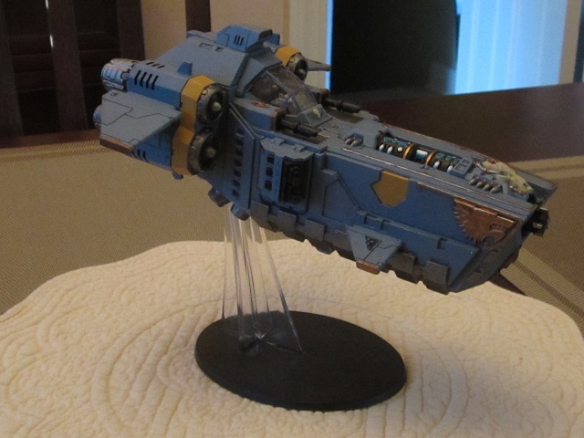

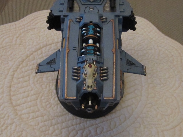

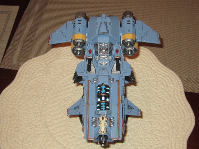

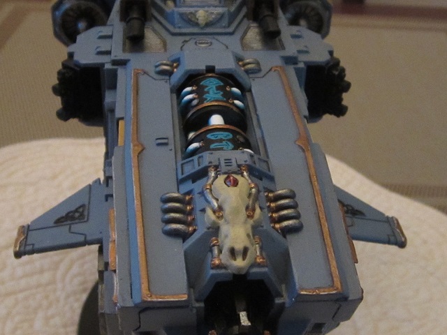

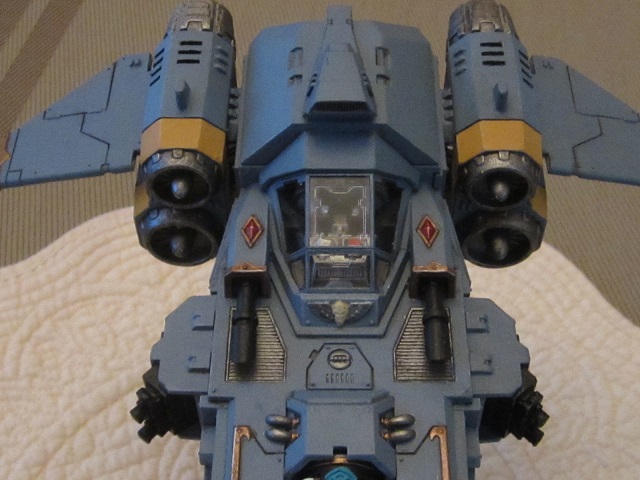

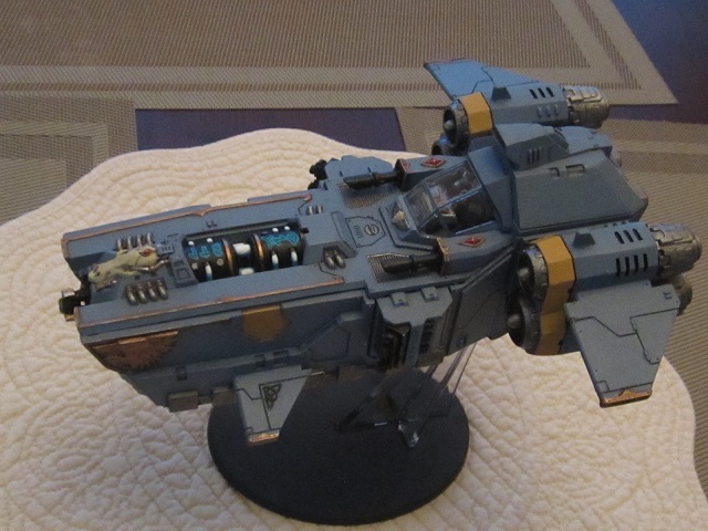

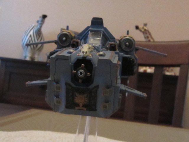

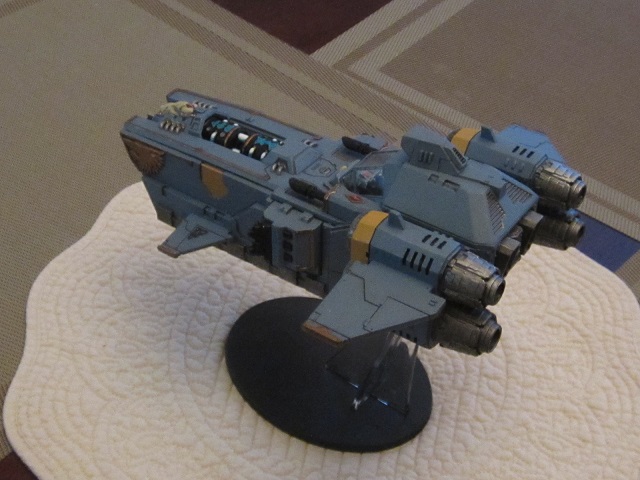

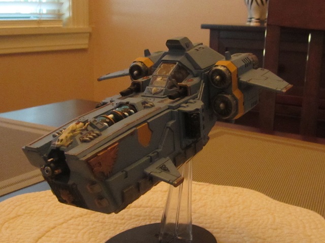

#10 Posted : 26 April 2015 02:27:51
Here are the finished pictures
#11 Posted : 26 April 2015 02:29:45
more pics
