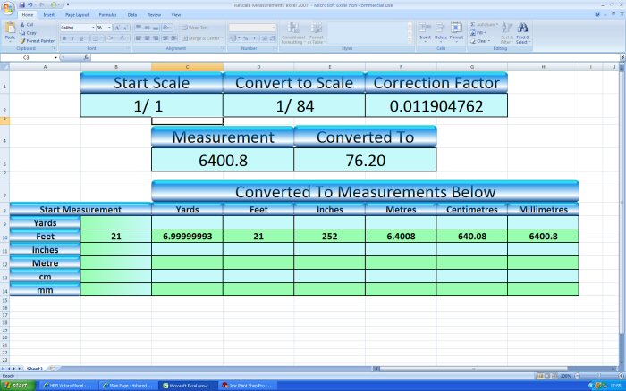

Hi Shipmates! BigGrin
A little spreadsheet to help you resize measurements from one plan to use on your model. Say you have a plan with the scale of 1/48 and you need the measurements for the 1/84 scale Victory, No problem use this simply spreadsheet on execl 2007 entered 48 in the 'Start Scale' so it showed 1/48, then entered 84 in the 'Convert To Scale' so it showed 1/84 and that gave my a 'Correction Factor' of 0.571428571. Next measured the gunports on the plan 9mm so entered 9 in the 'Measurement' section and got 5.14 in the 'Converted To' section, so rounded 5.14mm down to 5mm.
Below that I setup a section to convert measurement from yards down to millimetres so I can use reference measurements from all sources real and from scale plans. As you enter the scale your can go from 1/1 scaled down to 1/99999999 or the other way from 1/99999999 scale up to 1/1 scale.
Example you have the real deck plank measurement 21 foot so you want the scale measurement for a scale 1/84. Enter 1/1 for 'Start Scale', 1/84 for 'Convert To Scale', 21 in the 'Start Measurement' section on the row for 'Feet'. This give you all the converted measurements from yards down to millimetres, Enter 6400.8 in the 'Measurement' section and you get 76.20 in the 'Converted To' section that's 76.2mm.
Just use the link below and download the file I've set the spreadsheet protection on so you won't change the formats only the cell's that you need to change can be. If you what you can unprotect the spreadsheet to see how the formulas work.
http://www.4shared.com/f...urements_excel_200.html

YES! but doesn’t convert sizes larger than cm, so if you get details in feet and inches or even yards you have to first convert into cm or mm measurements. So if you have all the conversions on one spreadsheet then that's less work for you.
