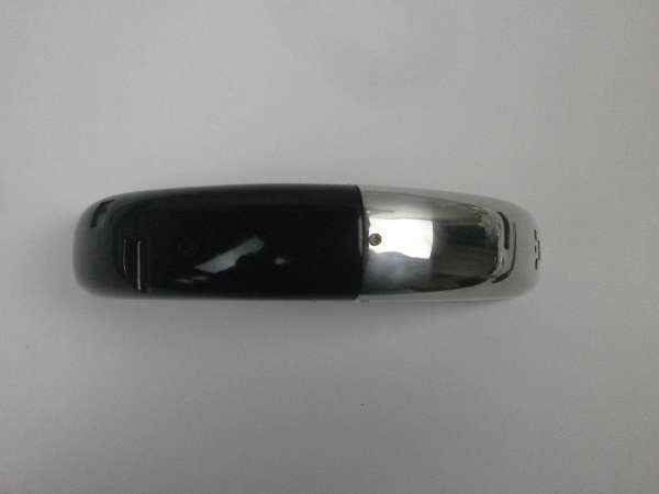

Pack 11 contains stages 34-37

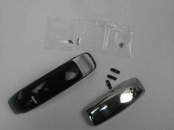

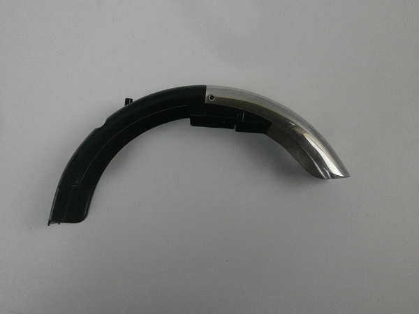

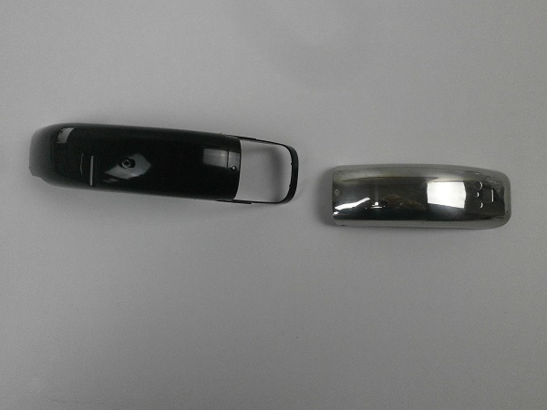

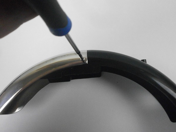

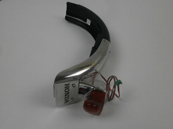

Stage 34 contains the rear fender halves A, B , wire holders and screws.
Firstly clean the metal part of the fender then take the two fender halves and join them together making sure to line up the 3 screw holes. Then use a 'V' type screw in the central screw hole to join the fender halves together. Finally use two more 'V' type screws at the sides to fix the fenders together, be careful not to over tighten the screws as you could distort the metal part of the fender.
This concludes stage 34, store any assembled parts safely in a bag labeled with the stage number future use.

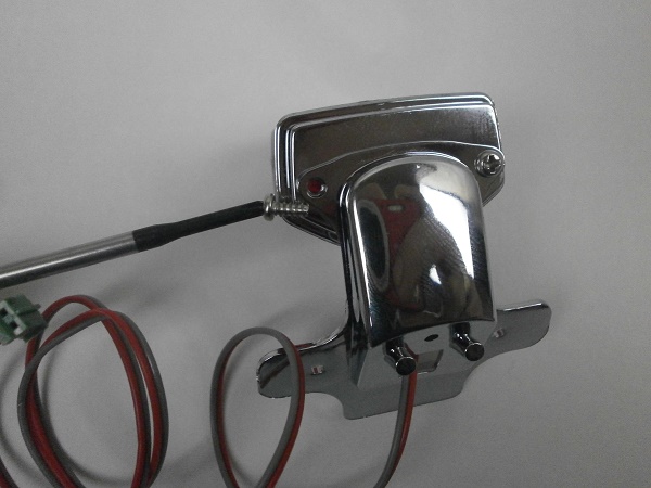

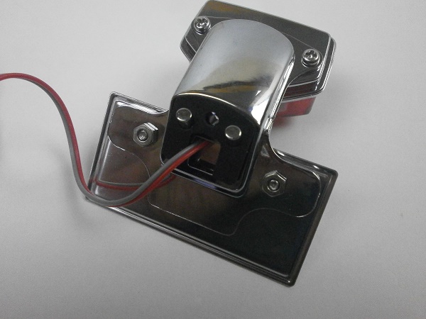

#2 Posted : 15 March 2015 14:50:50

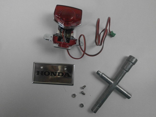

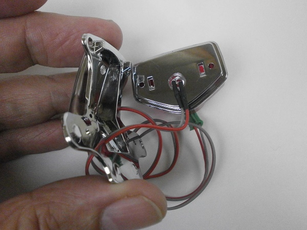

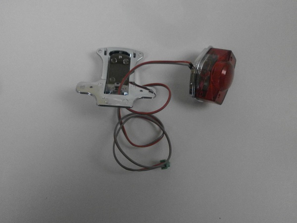

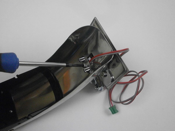

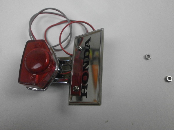

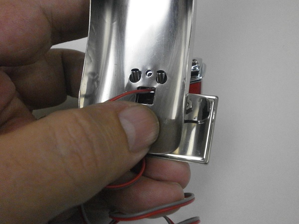

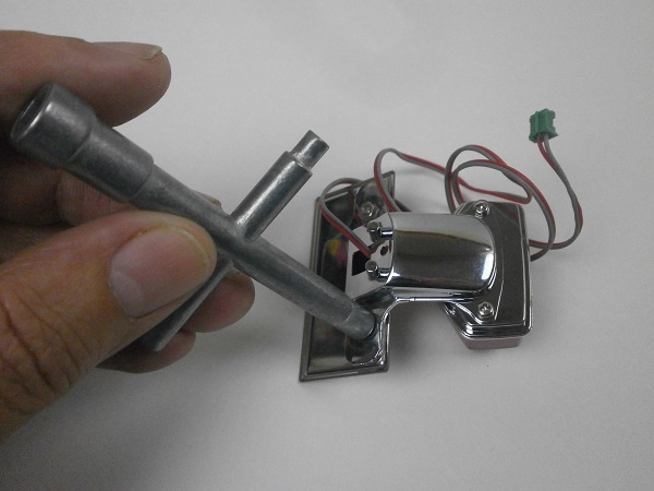

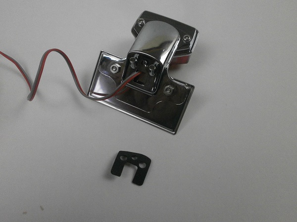

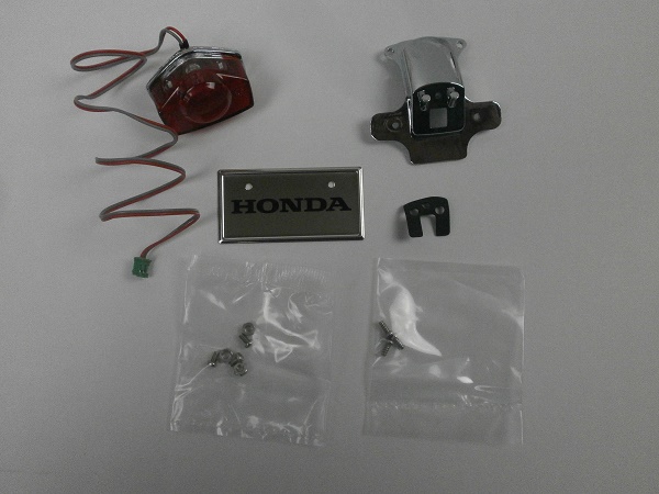

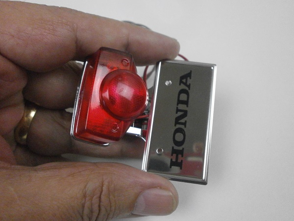

Stage 35 contains the tail light,bracket,licence plate,back plate and screws/nuts.
Push the tail light wire through the hole in the bracket and line up the tail light with the two projections and push carefully together then fix the tail light in place using two 'O' type screws. Next take the licence plate and line it up with the two holes and use two 'X' type screws to fix it in position. Then turn the assembly over and use the two nuts on the screw threads and tighten using the cross wrench. Place the sponge rubber licence back plate onto the rear of the bracket and then pass the tail light wire through the hole in the fender, line up the two studs with the two holes in the fender and turn the fender over holding the brake light assembly in place and use a 'O' type screw to fix the bracket.
This concludes stage 35, store any assembled parts safely in a bag labeled with the stage number future use.

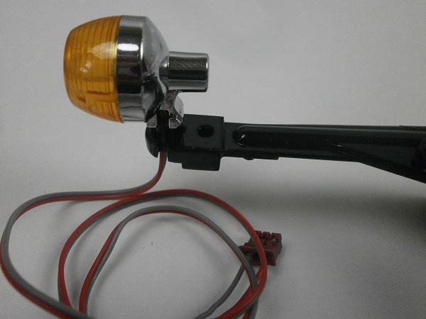

#3 Posted : 15 March 2015 14:59:04

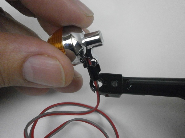

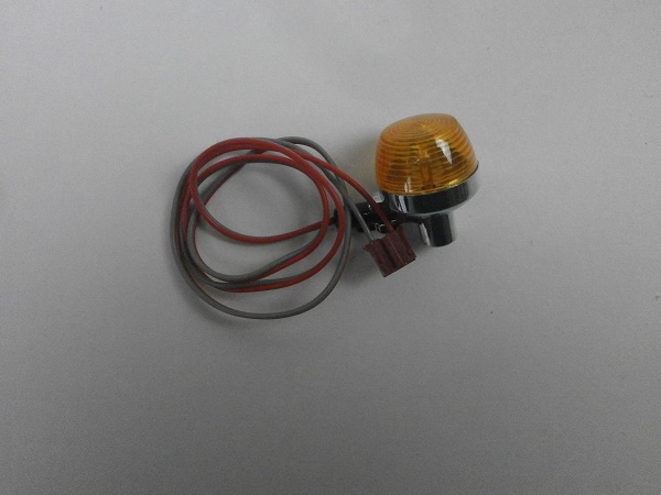

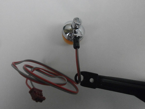

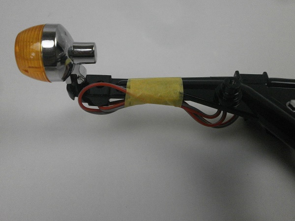

Stage 36 contains the rear right indicator.
Firstly orientate the top side and bottom side of the indicator ,the bottom side is where the wire is visible. Take the right half frame from stage 33 and find the rear hole with the gap in it. If you look closely there is a recess where the notch on the indicator housing will fit, Just push gently into place to fit it and then use some masking tape to hold the wiring loom in place.
This concludes stage 36, store any assembled parts safely in a bag labeled with the stage number future use.

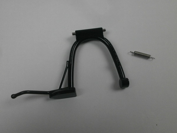

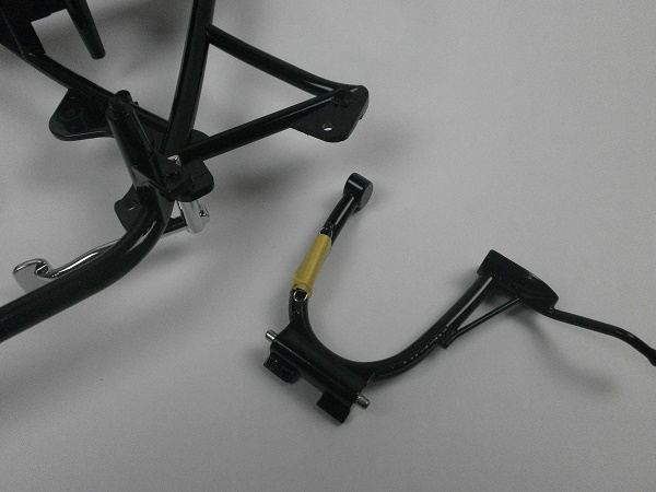

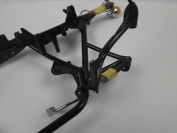

#4 Posted : 15 March 2015 15:01:43

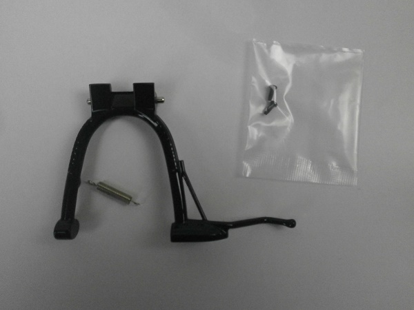

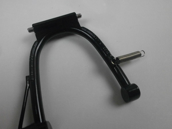

Stage 37 contains the centre stand,spring and screws.
Locate the hole under the right side frame where the stand fits an 'E' type screw will be used later in the build to fix the spring here. Take the centre stand and hook the spring through the hole on its side then use some masking tape to secure the spring on to the stand.
This concludes stage 37, store any assembled parts safely in a bag labeled with the stage number future use.

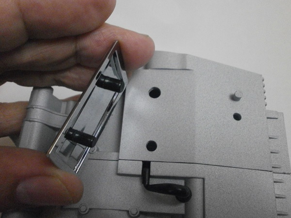

#5 Posted : 28 March 2015 16:28:03
Pack 12 contains stages 38-40.

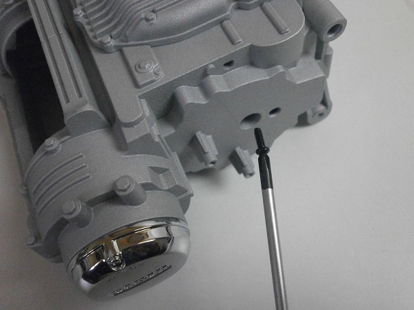

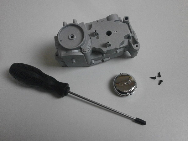

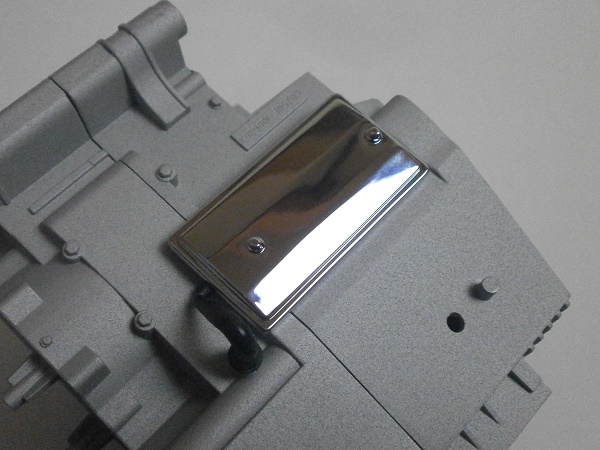

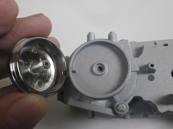

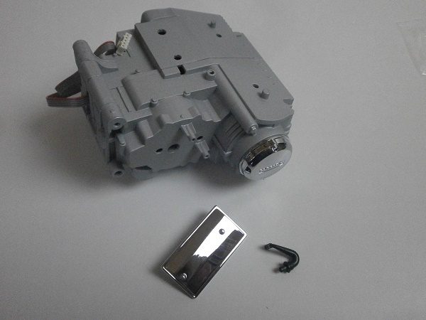

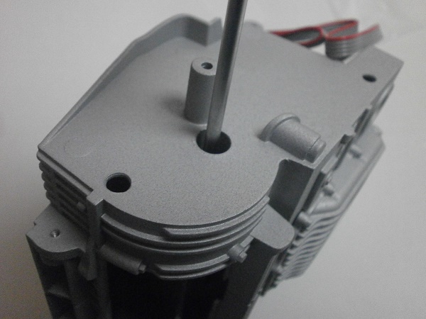

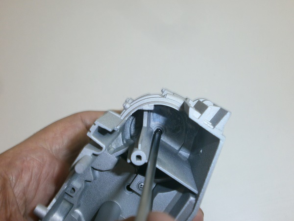

Stage 38 contains the right crankcase half,points cover, long phillips screwdriver and screws.
Firstly take the points cover and tap a hole in the mounting stud using an 'E' type screw. Then take the points cover and line it up with the notch and recess. Holding the points cover in place turn the crankcase over and use an 'E' type screw to fix the cover in place
This concludes stage 38, store any assembled parts safely in a bag labeled with the stage number future use.

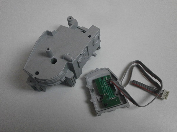

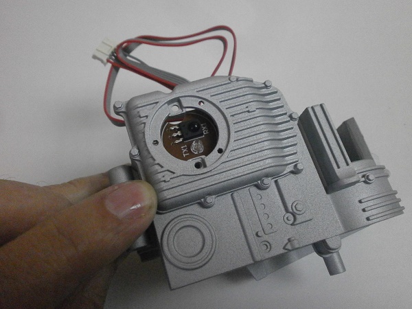

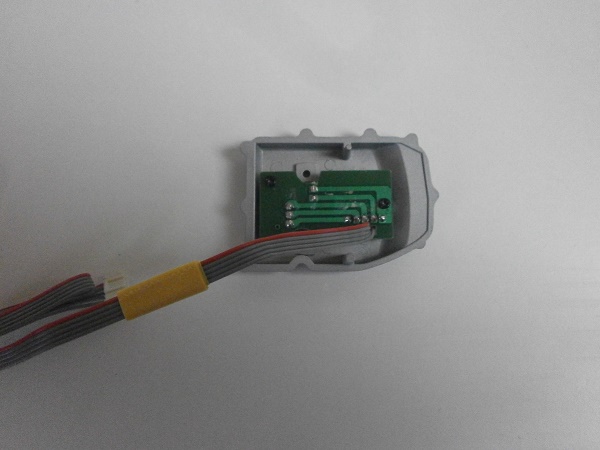

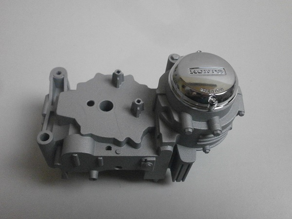

#6 Posted : 28 March 2015 16:33:14

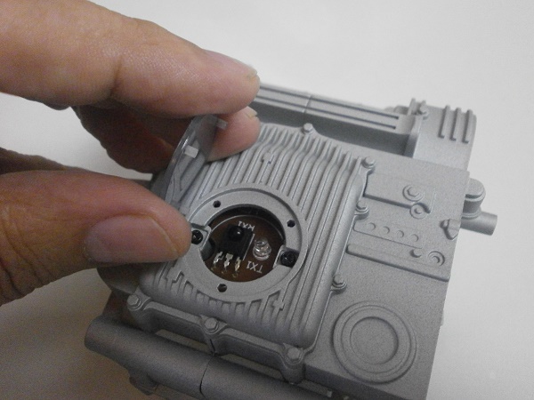

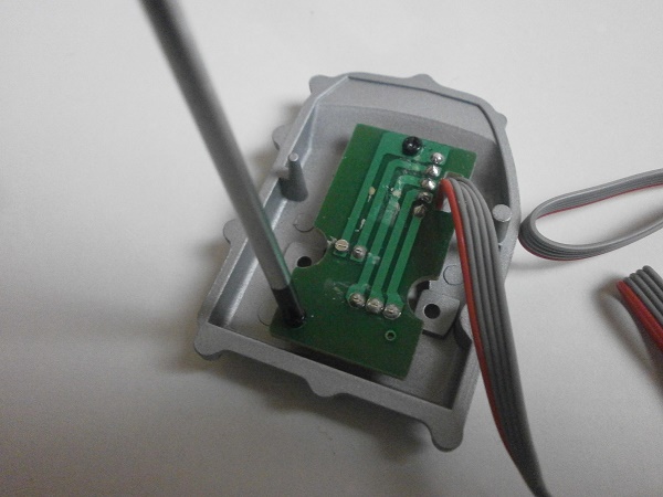

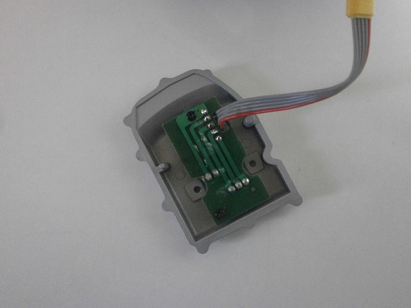

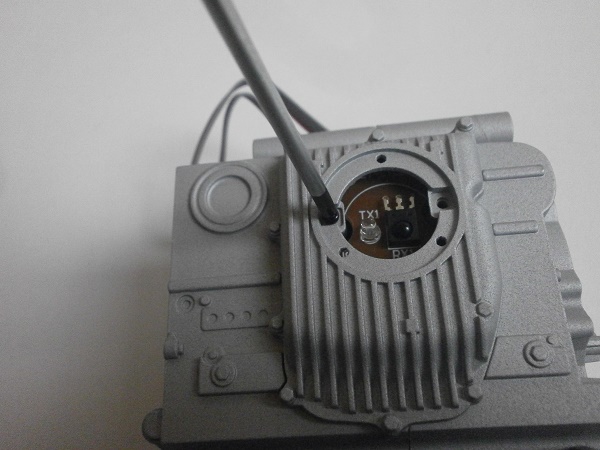

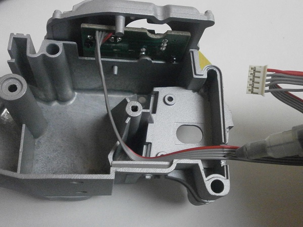

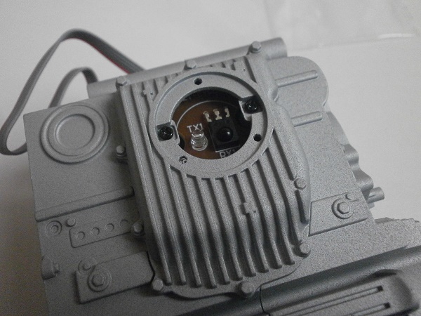

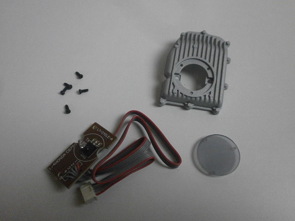

Stage 39 contains the oil pan,IR sensor board,sensor window and screws.
Firstly inspect the sensor board and that all the components are in place then line the board up with the two screw holes and fix it in position using two 'B' type screws.
This concludes stage 39, store any assembled parts safely in a bag labeled with the stage number future use.

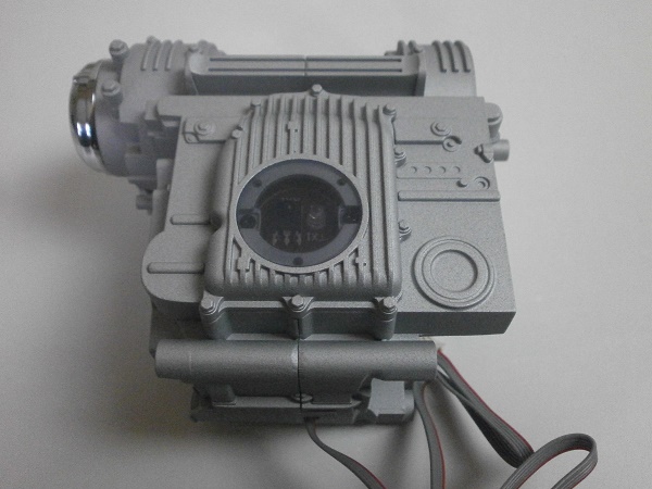

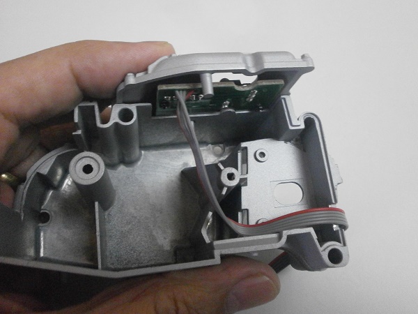

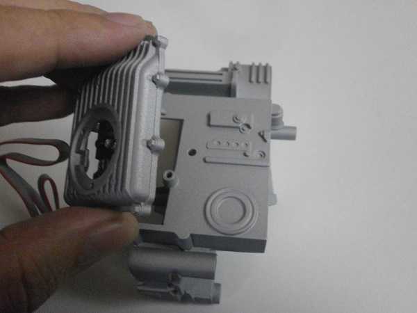

#7 Posted : 28 March 2015 16:44:22

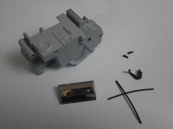

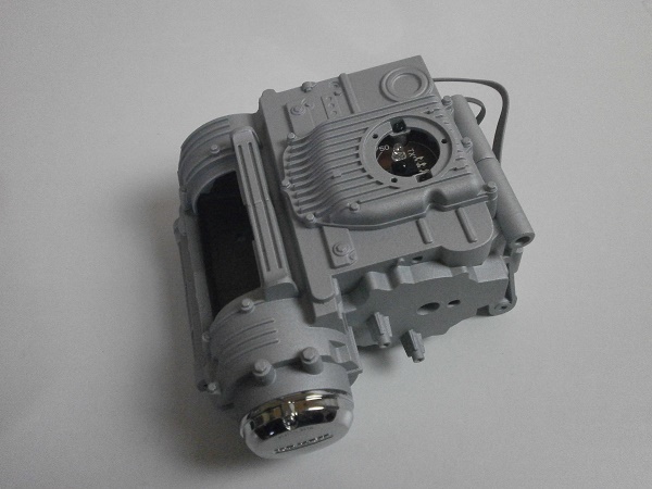

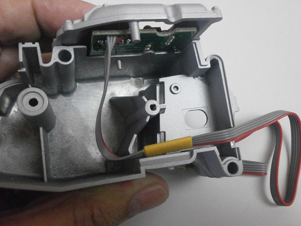

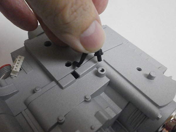

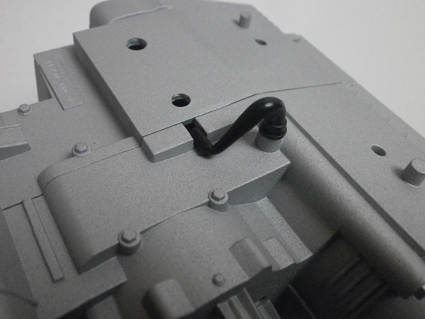

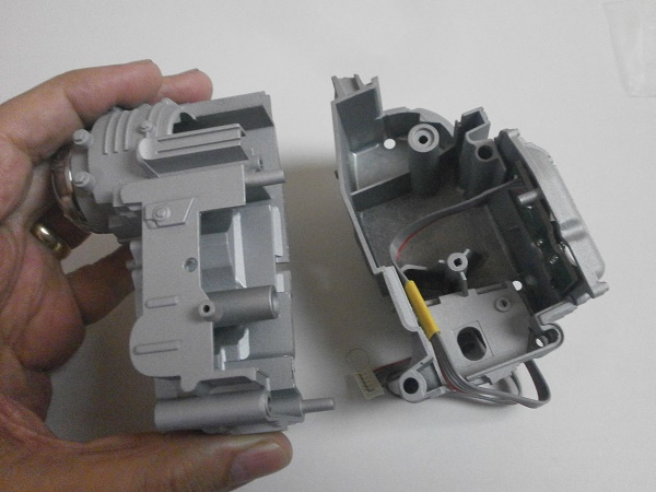

Stage 40 contains the left crankcase half,starter cover,cord grommet,cables and screws.
Check that the square cut out on the left hand crankcase is smooth and free from flash if any flash is present use a file to remove any sharp edges. Next use an 'E' type screw to tap the two holes in the left and right crankcases.
Now take the oil pan and line it up with the bottom of the left hand crankcase making sure the half round projection fits into the circuit board. Position the cable as shown and mark it where it crosses the crankcase edge. Remove the oil pan and wrap a 10 cm length of tape around where you marked the cable.
Lay the left crankcase on a table and place the cable in the position shown so there is a gap of about 2 cm then holding the cable in position fit the right crankcase onto the left crankcase. Hold the two crankcase halves together and fit the oil pan studs into the holes and use two 'B' type screws to fix it in place then use two 'E' type screws to fix the crankcase halves together as shown.

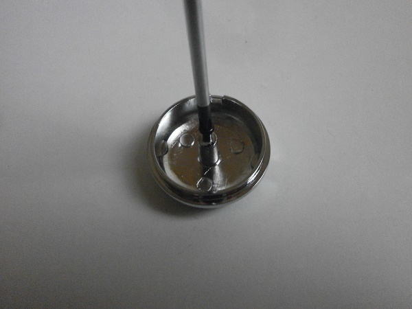

Next take the L shaped grommet and push it gentle in place making sure the cut out on the stud lines up with the cut out in the hole. Take the starter cover and line up the studs with the holes on the crankcase and push gently into place. Turn the crankcase over and line up the three pins on the sensor window with the three holes in the oil pan and press it lightly into position.
This concludes stage 40, store any assembled parts safely in a bag labeled with the stage number future use.
