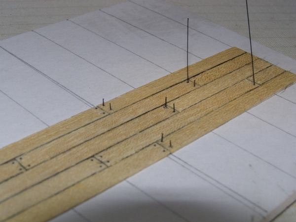

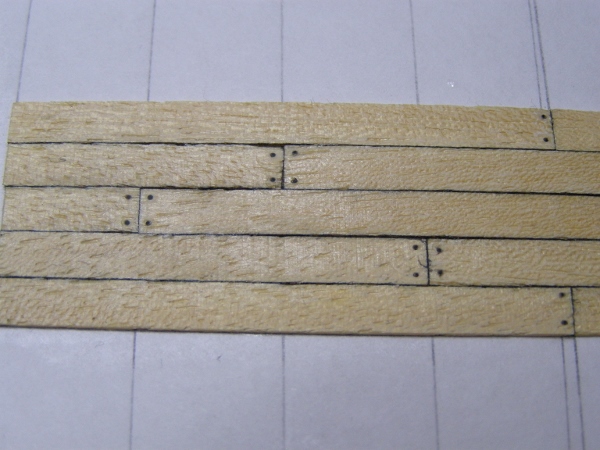

I have also been experimenting with tree nailing the decks on a piece of scrap. In addition to the advice already presented, here is another that you may want to consider.

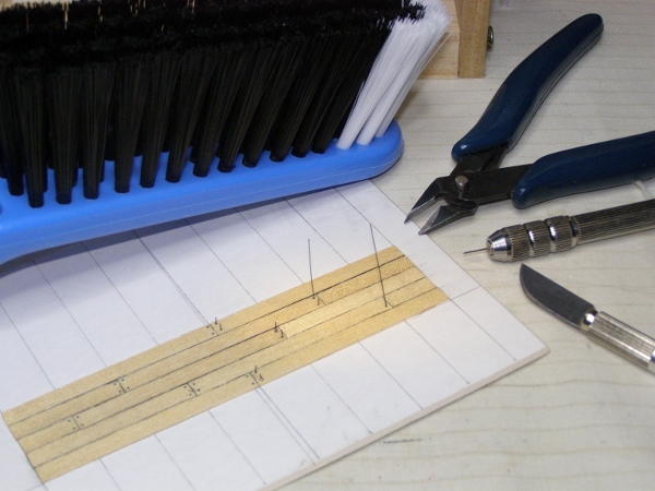

I was after a black treenail finish to compliment the simulated caulking so in-lieu of fishing line I am trying out using the bristles from a banister brush as shown in the attached pictures. I had mixed and inconsistent results with a pencil, however, this may have been due to my inexperience or selection of pencil (same 6B that I used for the caulking).
The bristles on the brush are 0.25 to 0.3mm in diameter. I cut in half an old sewing needle, filed a V point and placed the needle in a pin vise miniature hand drill. The needle is just over 0.4mm diameter and ideal for predrilling the decks. Use a sharp hobby knife to square trim the end of the bristle before placement into the deck. I found that cutters would squash and splay out the bristle making it difficult to fit. Apply a small amount of superglue to the end of the bristle and place it in the predrilled hole. Allow the superglue to fully set (ideal time for a brew break and rest the eyes) and then trim the bristle. Use a flexible nail file board to lightly sand the bristle so that it is flush with the deck.
The results are looking promising at this point. I just need to see how the deck goes with a light stain and a final seal before deciding whether I like the final finish. For a lighter treenail, I am considering using a straw broom or a scrubbing brush, however, I have not been able to find one that has an even or right size diameter.
So, another alternative in the mix for consideration. As per previous advice, try out various techniques on scrap and see what works well for you.
