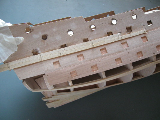

It's me again. Sorry but I am new to building a ship of this magnitude and want to make sure I don't make an error that will mess things up down the road. Fixing errors aren't as easy in wood as they are with plastic.
I am placing the smaller bulwark on the rear starboard side. I have the bulwark placed like it is stated in the instructions. Pic 1
The front of it is placed on Frame 8 overlapping the upper bulwark.
The problem is, it is a bit vague when it comes to lining the rest of it up.
In Pic 2:
Is the rear of the bulwark lined up correctly? I am not sure how much it should overlap the upper bulwark.
In addition, as you can see in Pic 3:
There is a space between the lower bulwark and where it overlaps the upper one. Aside from a little warp, it is separated from the upper one because of how it rests on the hull frames. Is this correct? Should it rest on the upper bulwark? If so, I assume the hull frames need some more sanding to allow it to sit properly.
Thanks for the help,
#2 Posted : 14 February 2015 09:33:19
Hi Steve, looks as if she coming along very nicely so well done...Cool Cool. As for the fitting of the side panels and what I can see from your pics. Placement looks good although just a little high on the stern so if you can lower the panel just a touch more then you should be good, you don't need much of an overlap. The gap between the upper and lower panel needs to be closed further and from what I see it looks as if you need to carefully take a little more off the ribs ensuring you keep the same continuous flow along the hull, when you're happy pin and glue the panel in place..Cool Cool. Take some time to study the official build pics and of course Karl's diary, both show exactly how it should all look when done....Cool Cool .. Hope this helps and do keep the pics coming, she is a beautiful ship to put together.....Cool Cool .. Hope this helps.
#3 Posted : 14 February 2015 10:54:23
There is meant to be a step from the panel to the panel above, as the planking will run down the top panle and butt up to the step as can be seen in the phtot below taken from my build forStage 31

Thanks for the kind words Gandale. This is certainly an enjoyable build. And thanks to both, for the help. Bulwark has been confidentially placed now.
