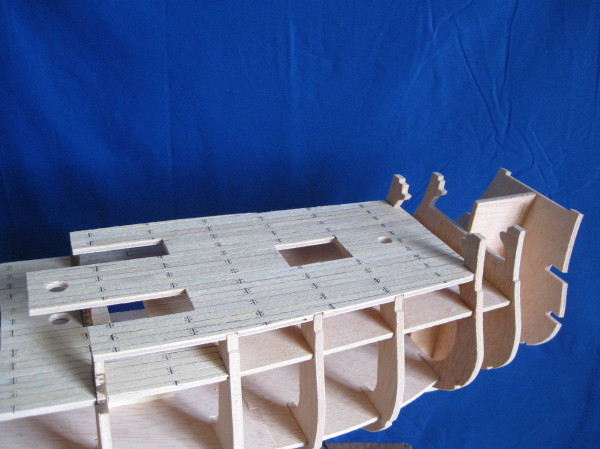

#6 Posted : 26 January 2015 18:33:51
Ah right got it.
If the ribs are fully seated, there is indeed slight curve in this deck, and you'll need to clamp the deck to the beams for it to sit properly and its should then rest on all of the beams.
If any of the beams have uneven heights from one to the next, then its possible the ribs are not fully seated. If you post a photo of your build in this area then we can guide further if necessary.
Have attached a pic of how mine looks..

I think I have it right as the false deck below sits squarely on the frames (like in yours shown in the pic). I just thought I had done something wrong as the lower stern deck rested on frames 8 and 12 and 9 - 11 shorter then those frames. This is what led me to believe either frame 8 or 12 was sitting too high. So curved it is. :-)
Thanks,
