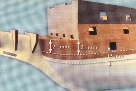

Hi Joe, you should allow the sapele strip lie where it wants to go and not in any way force it into position, if that means it wants to rise up the bow then allow it to happen... Derek is correct, the lowest edge of the sapele will be painted over by the red band so won't be seen. As long as the lowest edge of the sapele is more than 21mm from to top edge of the bow then you will be fine. Have attached a pic to show you the measurements to work from and how it should look, you will see how much of the sapele needs to show above the red band.... Hope this helps but if you need to come back to me the please do, if you can post a pic of this area of your build then that will help too.....
