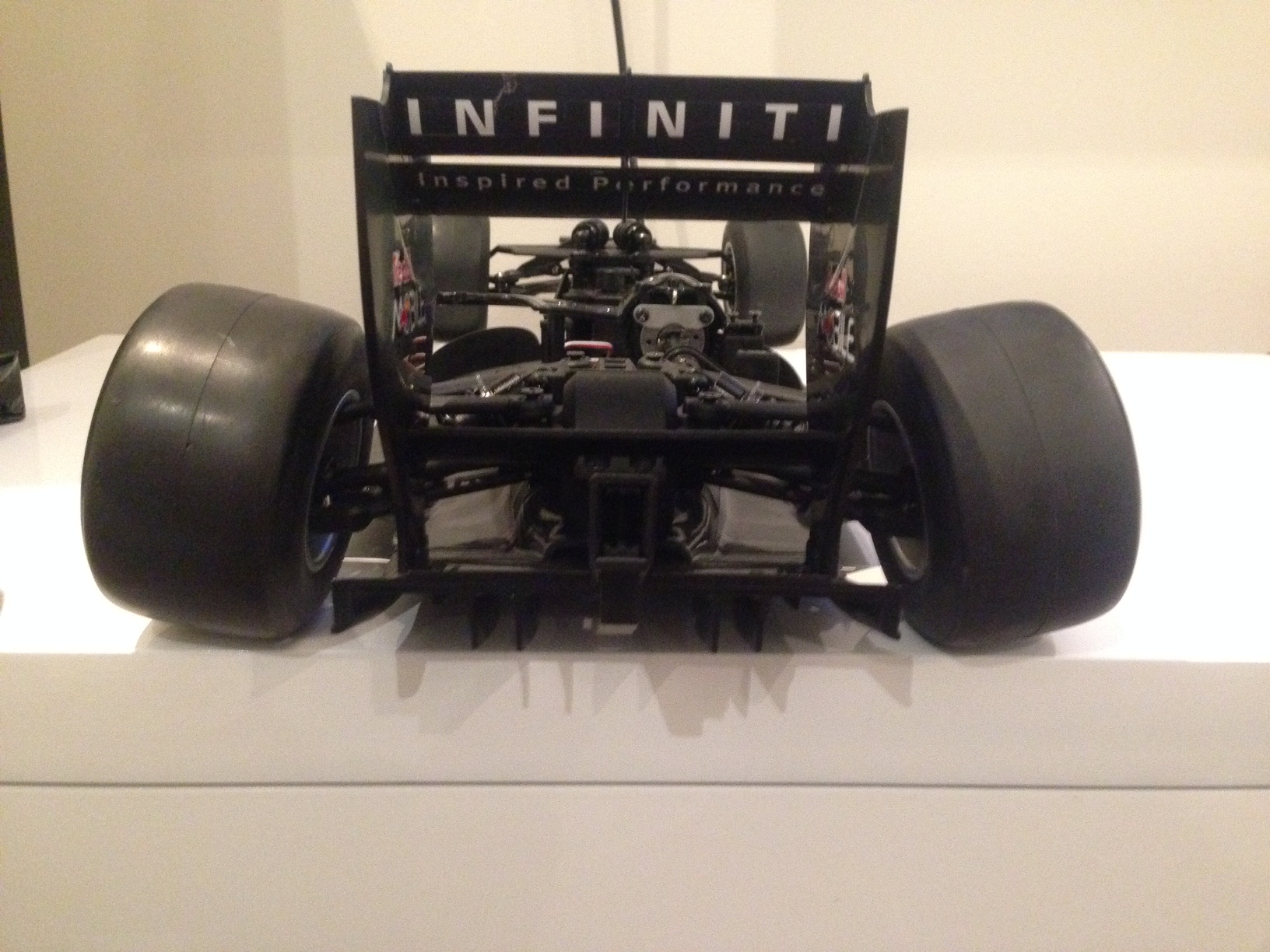

I have just fitted both rear wheels to my RB7 and have noticed that there seems to be a quite extreme camber.
Both sides are pointing in at the top at an angle i wouldn't have expected.

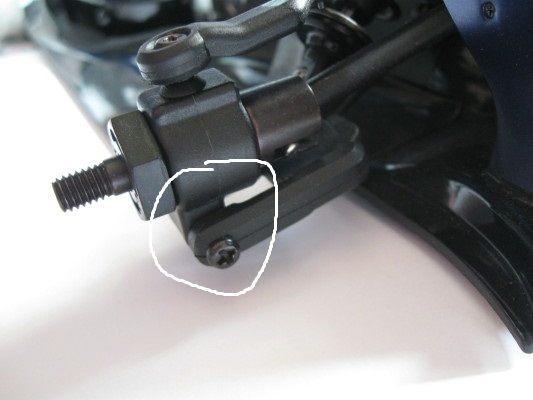

#6 Posted : 11 September 2014 13:01:34
Here is a pic of mine, where you can see that the bottom mount tab is wheel side rather than facing inside.

Thanks so much. I saw the error of my ways just after i uploaded the pic.
