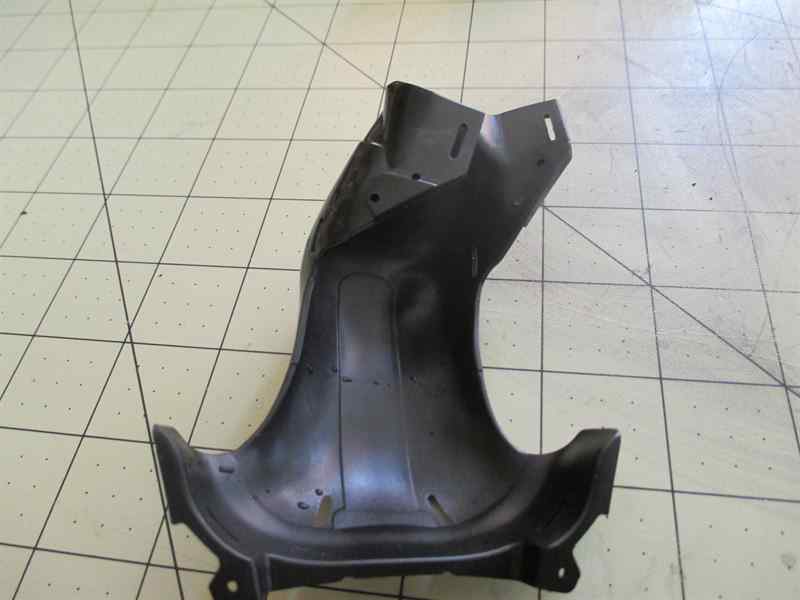

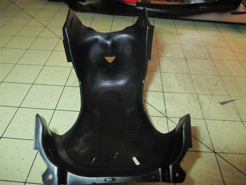

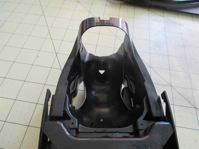

Hi Guys,
Here are the before and after pics of the seat.
As Tomick mentioned, do exercise caution! It is indeed hot! Once again, I must caution: DO NOT USE BOILING WATER! Remember the Shrinky-dinks we had when we were kids? Use boiling water, and that will be your seat!!
