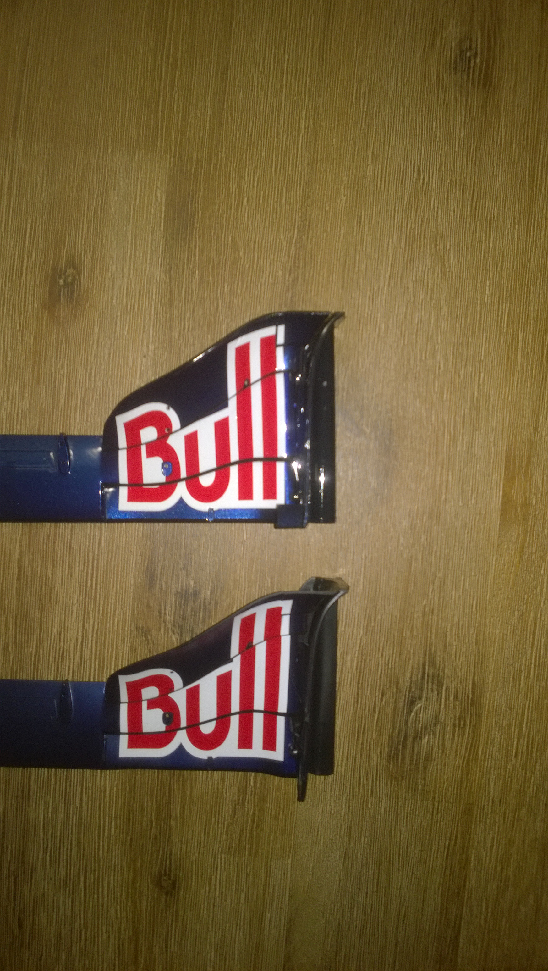

I took bought an extra Issue 1 to test spraying it with a clear coat.
1. It makes the piece look 100 times better. It pops the colors while adding a high gloss. It also fills the seems on the joins nicely as well as masking whatever gluing evidence you might have. And it obviously solves the glossy sticker on matt base difference.
2. Allthough most of the wing came out good looking some spots did not.I am goin to guess this is due to the molding residue. I did not try prepping the surface before hand.On one spot it also looks like the decals already on the pieces responded to the spray paint.
Based on the difference, spraying the body with a clear coat is very tempting but it obviously risks completely spoiling a piece if it blunders.
Was wondering if anyone had thoughts on this and maybe preperation suggestions? Unfortunately I do not have another test piece and my local CNA is out of issue 1 for more test pieces.

Just a pic

I managed to get another spare wing Which I washed in a mild soap. Spray result was much better but unfortunately where ever the pre-printed stickers/decals does not bind 100% to the plastic it reacts to the Clear coat and bubbles. In this case on the front wing there appears to be a few such cases where the sticker goes over grooves in the plastic. Some parts came out beautifully where others has small showings of imperfections, and my OCD will drive me nuts.The clear coat also had difficulty taking to the plain black parts where there was no paint.
