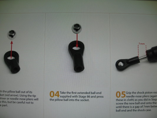

The front shock absorbers can be upgraded to 'racing' spec which will provide a higher ground clearance at the front.
To do this, you will need to use the two 5.8mm ball ends supplied with Stage 86 and the instructions of Stage 87 to complete the upgrade.
Basically, the ball ends of the front shocks are swopped with a longer version, and the gap between ball end and shock body adjusted to 7mm of visible shaft.
