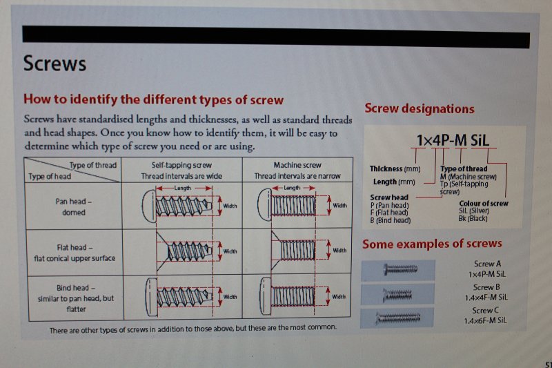

When building the MP 4/23 there was a screw guide in the magazine depicting letter of screw and size. Are we using the same screws on the MP 4/4 build ?
#2 Posted : 02 May 2014 20:03:29
Hi Al
To answer your question I would say that it is likely that some screws maybe similar to the MP4/23 but that does not necessarily mean they will all be the same, plus there maybe additional sizes/types within the Senna build. When you recieve your packs you will be supplied additional screws (so if you need 4 screws then you may get 5 of that type) with each stage just incase you lose one. I suggest you put any spare ones aside incase you need them later in the build.
In pack 2 there is a guide on some of the screw types used and how to identify them...
Spencer

thats what im after BigGrin makes life a bit easier when using a multitude of screws
