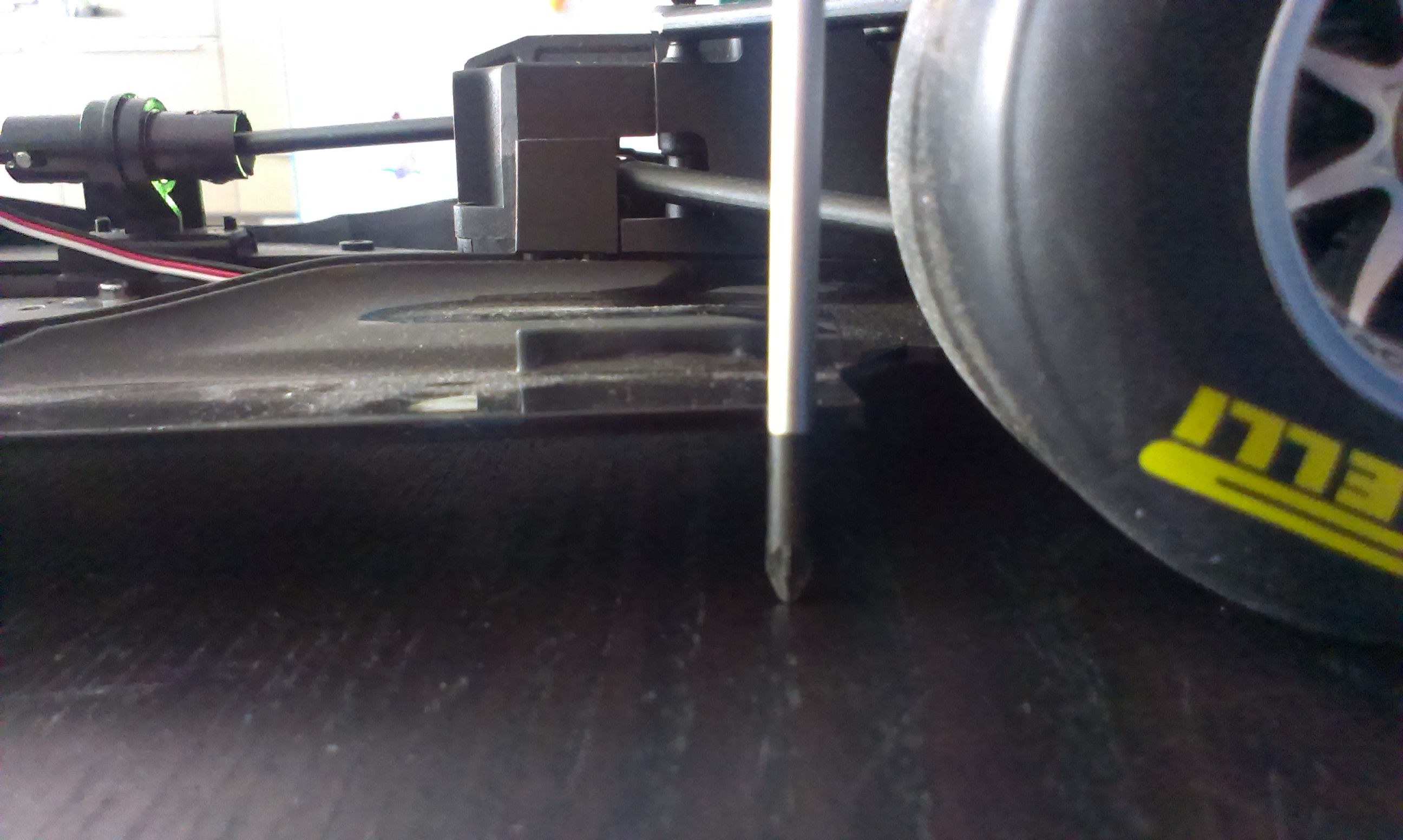

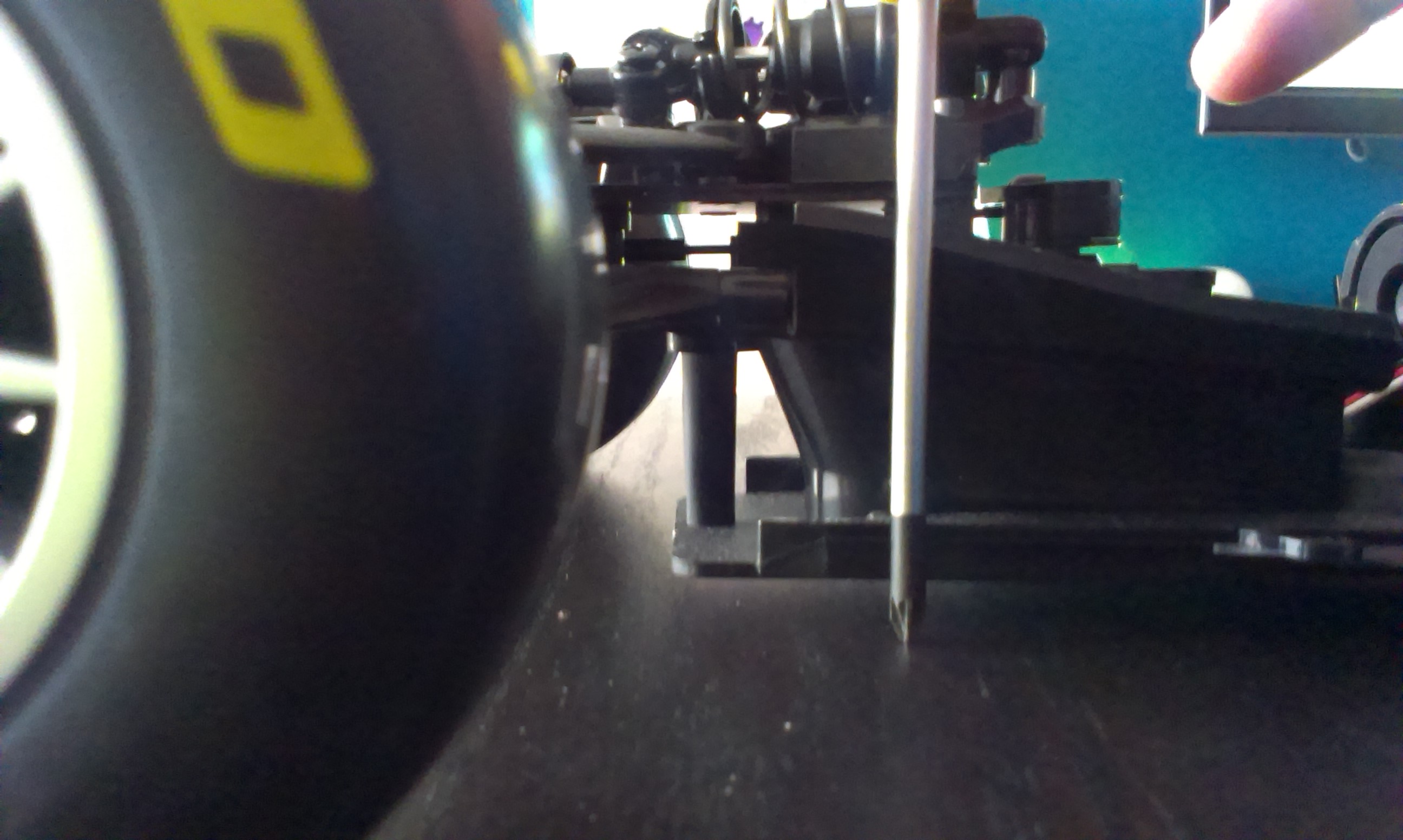

I am building my F1 car and after finishing the rear suspension I noticed that I have a height difference between front and back.
I didnt measure it but i believe the difference is around 10mm.
How do I solve this? Can someone measure the heightdifference on his car?

I measured the difference in height FR:5mm from ground, RR: 20mm from ground
thx
