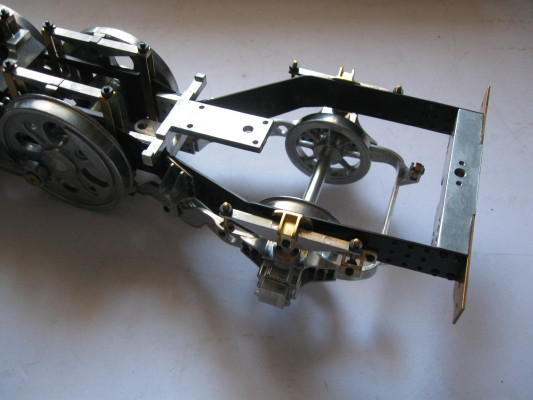

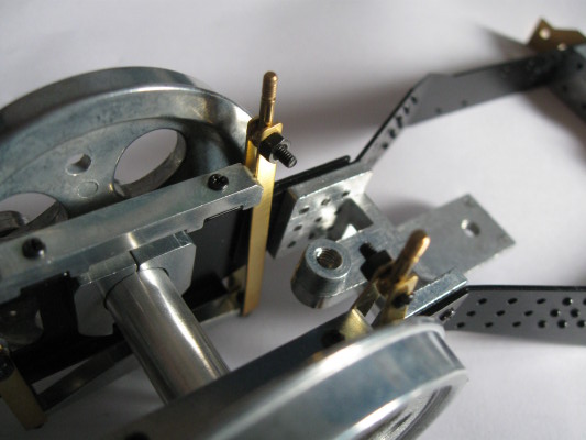

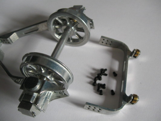

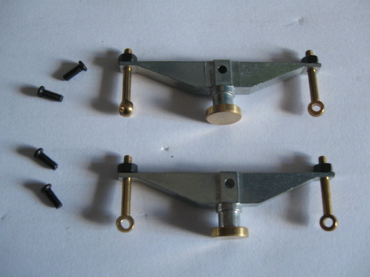

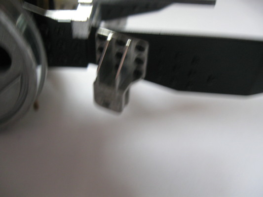

Pack 17 contains Stages 65-68

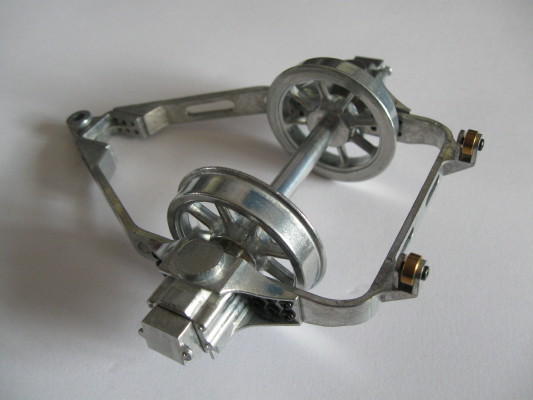

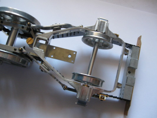

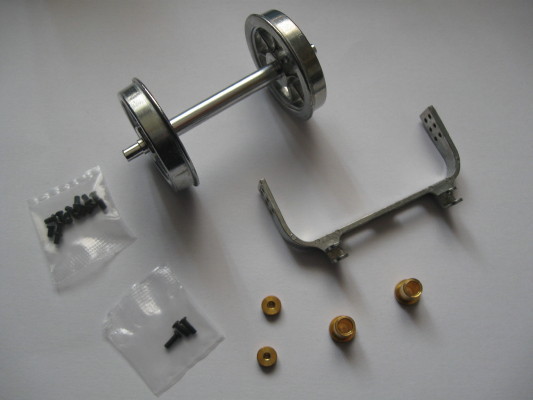

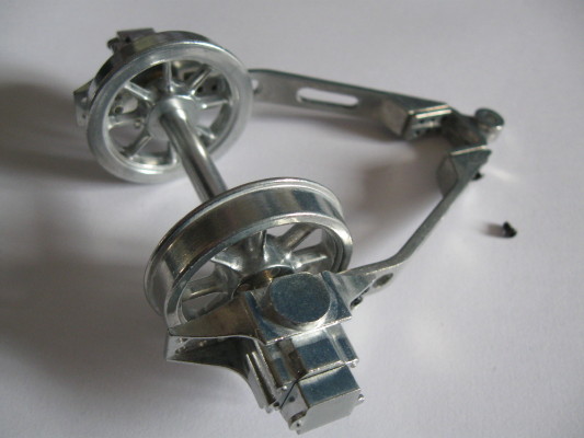

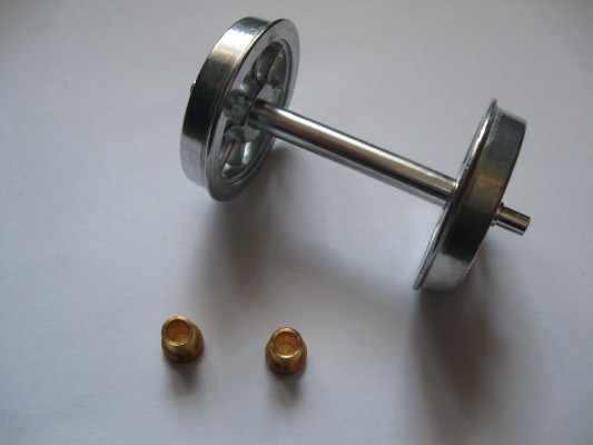

Stage 65 - Contains the trailing wheel set, end beam, brass bushes & rollers and screws.

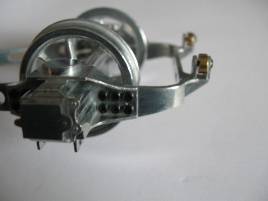

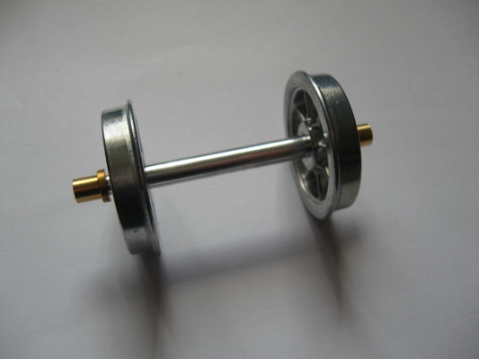

Place one of the bushes over the axle projecting from the side of the wheel. Then place the second bush on the other end of the axle.
Loosen the screws that hold the trailing truck beams to the pivot housing. Spread the two beams apart
and insert the bushes at the ends of the axles into the two trailing trucks. Then re-tighten all the screws that were loosened.
Make sure that the trailing wheels turn. If they don’t, try loosening the screws and re-positioning the wheels.

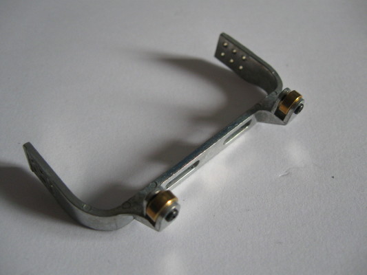

Place one of the rollers in between the semicircular projections of the end beam, then place a 2x5mm screw through the end beam and roller and tighten into place. Repeat this process to fit the second roller in the end beam.
Place the trailing truck assembly and the end beam as shown, then place the ends of the end beam inside the trailing trucks, aligning the holes of both. Tighten a 2 3mm screw into each of the six holes.
Align the screw holes on the other side and tighten a 2x3mm screw into each of them.
This completes the trailing truck/bogie.

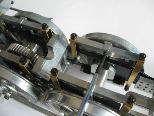

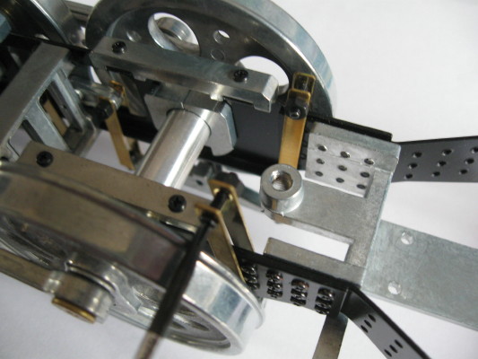

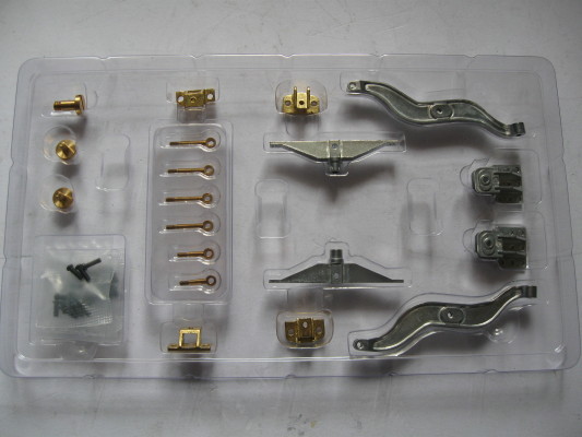

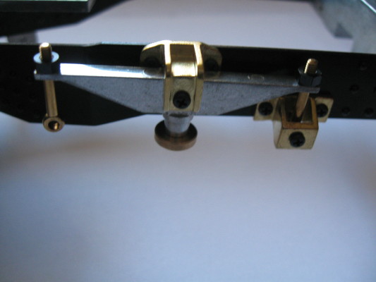

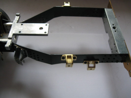

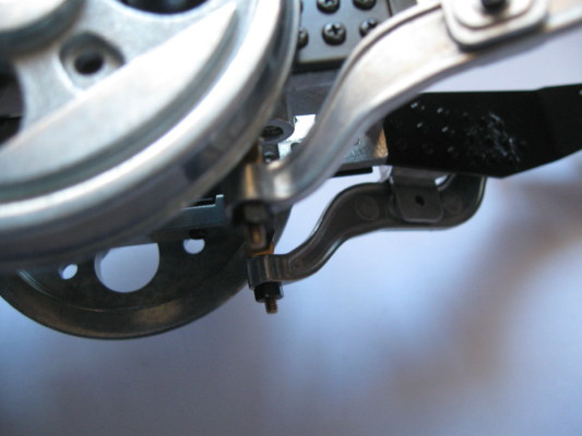

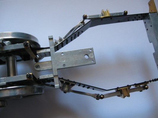

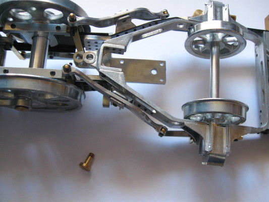

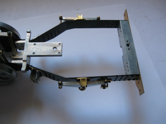

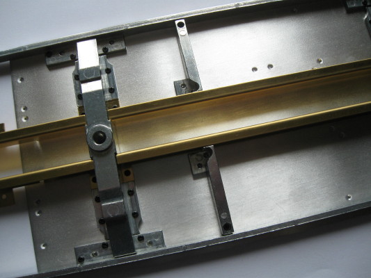

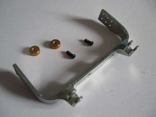

Stage 66 - Contains trailing truck equaliser parts.

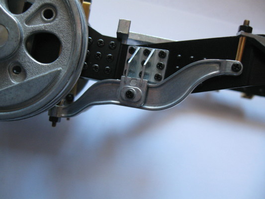

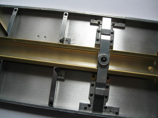

Start by removing the screws that hold the leaf spring to the fourth wheel set and put the screws to one side.
Turn the underframe over, and remove the screws and nuts of the suspension links and keep them to one side.
Put a short spring counterbalance between the links, pass the screw through the hole and tighten the nut over it.
Fit the two equaliser mounts onto either side of the underframe, behind the fourth wheel set, with 2x3mm screws.
Screw a spring mount and counterbalance bracket into place on either side of the underframe with 2x3mm screws.
Apply a small amount of instant adhesive to the hole in the leaf spring, then insert the slide block into the hole in the spring.
Place a long leaf spring counterbalance through the hole at the end of the spring and secure with a nut. Repeat this process to prepare a second leaf spring.
Place the spring in the spring mount and the leaf spring counterbalance into the counterbalance bracket. Align the holes of the parts. Then tighten a 2x5mm screw into each of the holes.
Take the left trailing wheel equaliser and align the three holes with the three in the short and long counterbalances and the equaliser mount. Tighten a nut over the end of the short counterbalance ,a 2x6mm screw into the equaliser mount and a 2x5mm screw into the long counterbalance. Then repeat to fit the right equaliser.

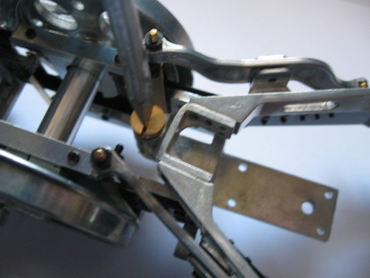

Re-tighten the screws removed from the leaf springs of the 4th wheel set.
Turn the assembly over and align the holes of the underframe and the trailing truck, as shown in the instructions.
Apply some thread lock to the thread of the pivot screw, and tighten it into the aligned holes of the trailing truck and underframe. Tighten the screw so that the traling wheels remain in contact with the surface of which the rest of the wheel sets are resting.
We now move onto the assembly of the Tender.

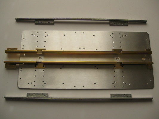

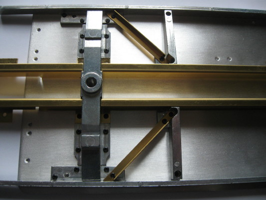

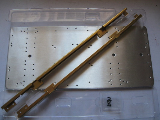

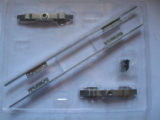

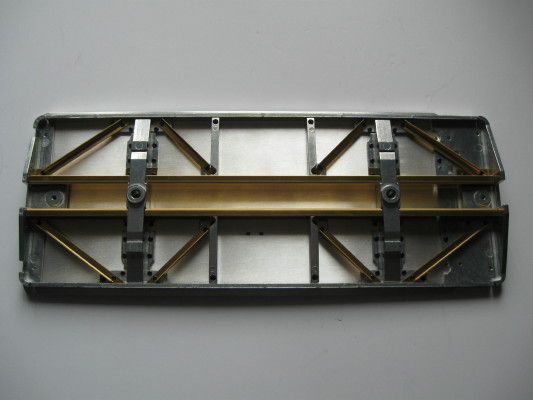

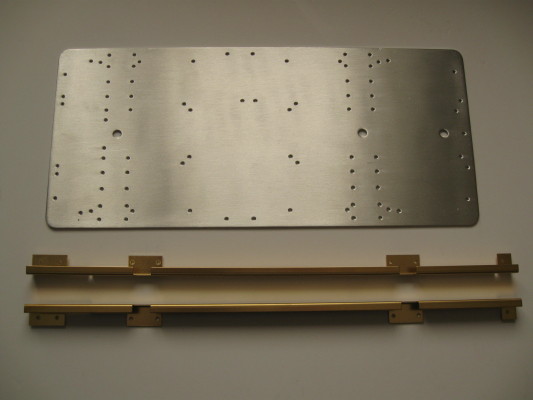

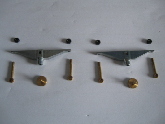

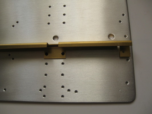

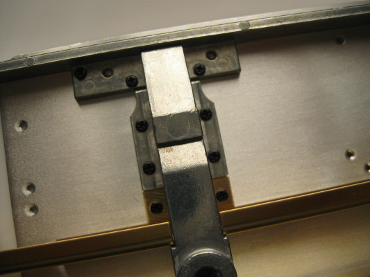

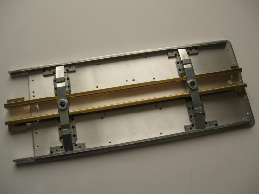

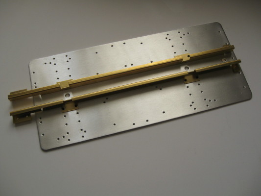

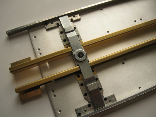

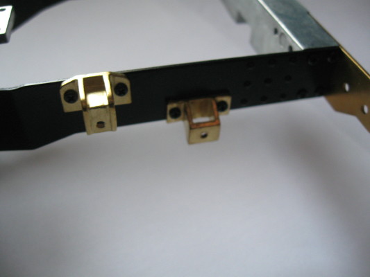

Stage 67 - Contains the tender base, left & right underframes and screws.
To distinguish between the front and rear of the tender base, look at the holes at either end as shown in the instructions.
The tender underframes can be identified by the number of screw holes at either end.
Place the right tender underframe onto the tender base, aligning the holes indicated in the instructions. Match up all the holes along the underframe with those onthe base, then tighten a 2x3mm screw into each of the two holes towards the front of the underframe, then a 2x3mm screw into each of the two holes towards the rear of the underframe.
Turn the base around, and align the two holes towards the rear of the left underframe with those in the base. Tighten a further two 2x3mm screws into the holes at the rear, then tighten two 2x3mm screws into the holes towards the front of the left underframe.

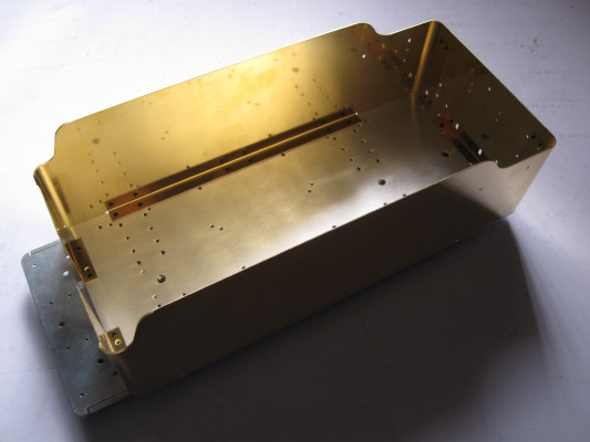

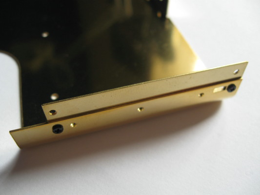

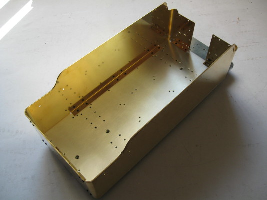

Stage 68 - Contains the tender side beams, bolters and scews.
Place the tender base as shown in the instructions, and position one of the side beams at the side of the base, aligning holes indicated. Tighten a 2x4mm screw into each of the three circled holes. Then tighten a 2x4mm screw into each of the three holes towards the rear of the side beam.
Turn the base around and place the second side beam onto the other side of it, aligning the holes indicated. Tighten a 2x4mm screw into the three holes indicated in the tab at the rear of the side beam. Tighten a 2x4mm screw into each of the three circled holes towards the front of the beam.
Place the first bolster towards the front of the assembly, engaging the slits in the bolster with the underframes. Make sure the bolster is resting flush with the tender base. Tighten four 2x3mm screws into the holes in the bolster. Then tighten four more 2x3mm screws into the other end of the bolster.
Place the second bolster into position in the underframes towards the rear of the tender base assembly. Tighten four 2x3mm screws into one side of the tender. Then tighten four 2x3mm screws into the other end of the bolster.

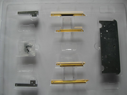

#5 Posted : 07 April 2014 10:31:10
Pack 18 contains Stages 69-72

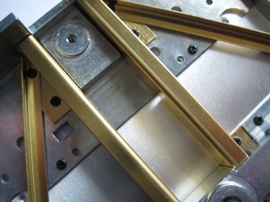

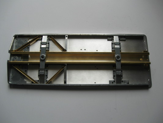

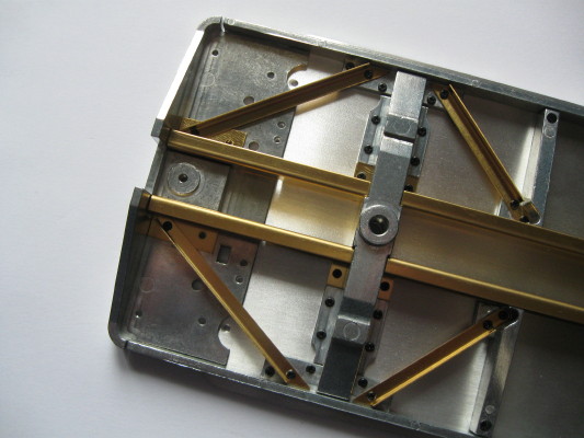

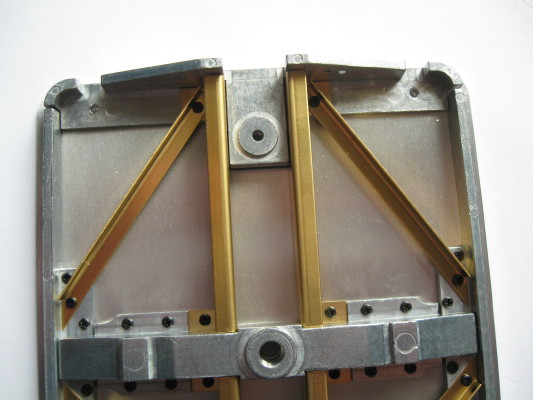

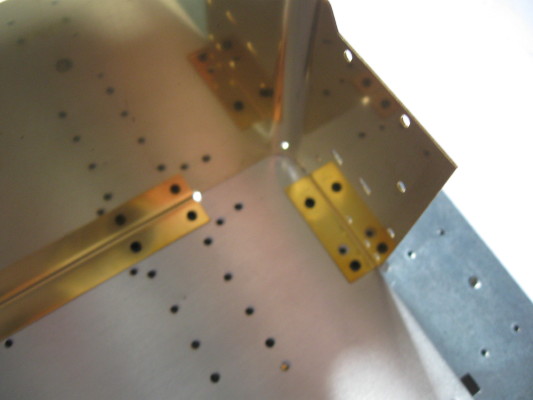

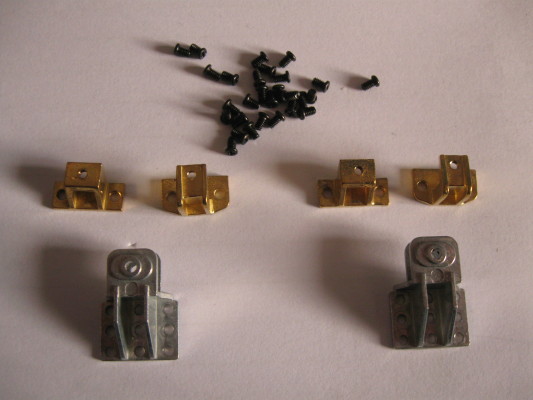

Stage 69 - Contains tender frame parts and screws.

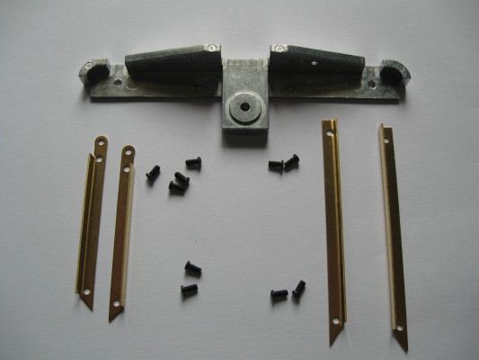

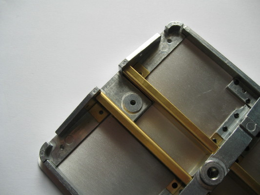

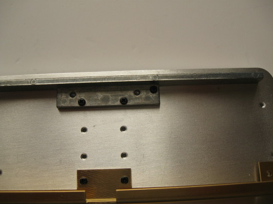

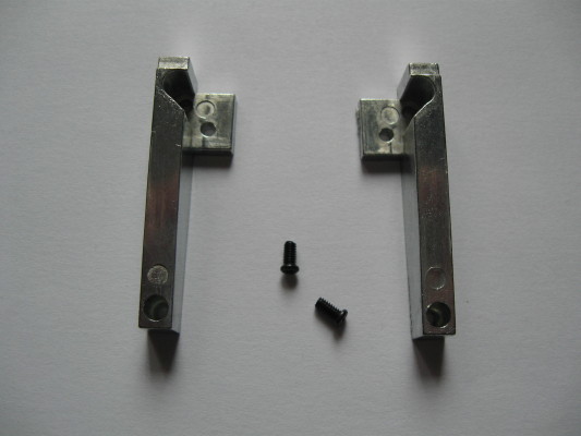

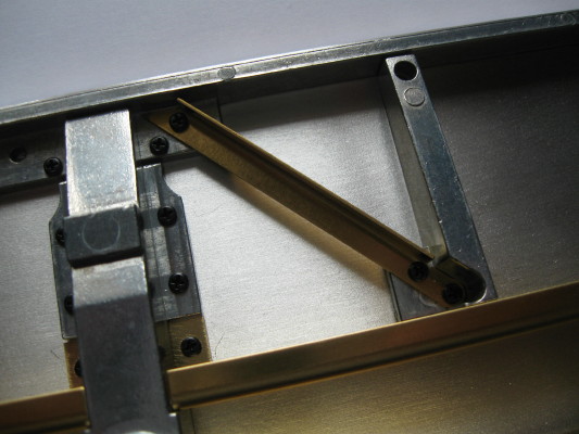

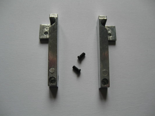

Align the screw holes of diecast frame B with the corresponding holes of the tender base, then tighten a 2x4mm screw into the single end hole of the frame.
Repeat for the other side of the tender base, using diecast frame A.

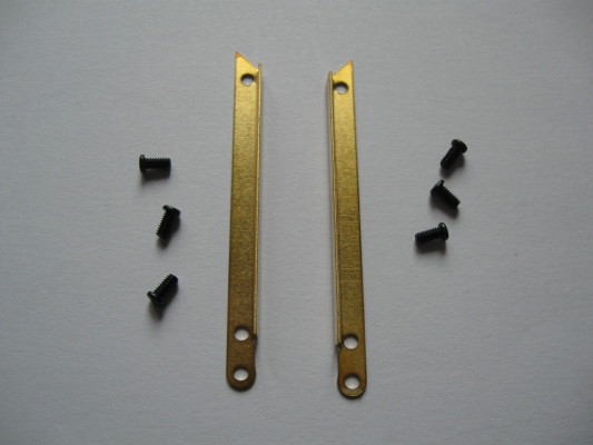

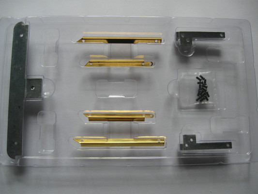

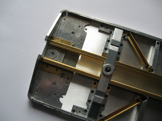

Fit brass frame C over the two holes of frame B and the hole of the side beam, then tighten 2x4mm screws into the three holes in frame C.
Repeat for the other side of the tender base, using brass frame D.
Place the diecast front tender base between the side beams and underneath the underframes, push the front into place until the holes are aligned.
Place brass frame B at the front of the tender base, aligning the holes, then tighten a 2x3mm screw into the hole at the front of the frame, and a 2x4mm screw into the hole at the side.
Repeat for the other side of the base with brass frame A.
Tighten a 2x2mm screw into the two indicated holes in the underframe. Then tighten a 2x3mm screw into the two indicated holes in the diecast base front.

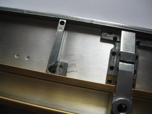

#6 Posted : 08 April 2014 11:25:17

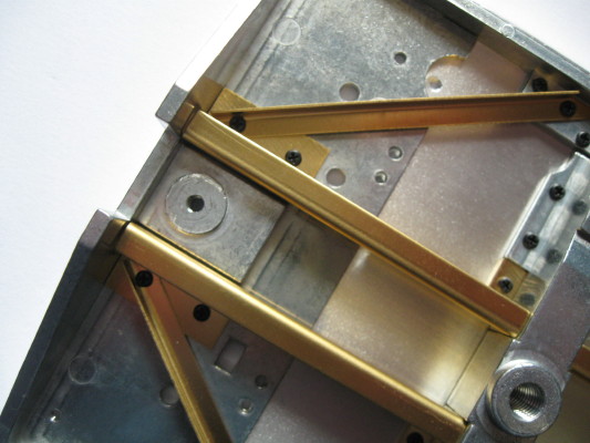

Stage 70 - Contains tender underframe parts and screws.

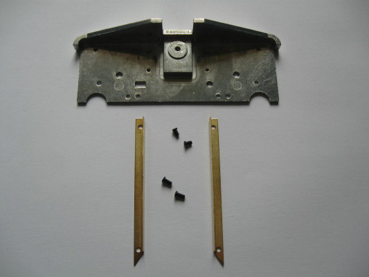

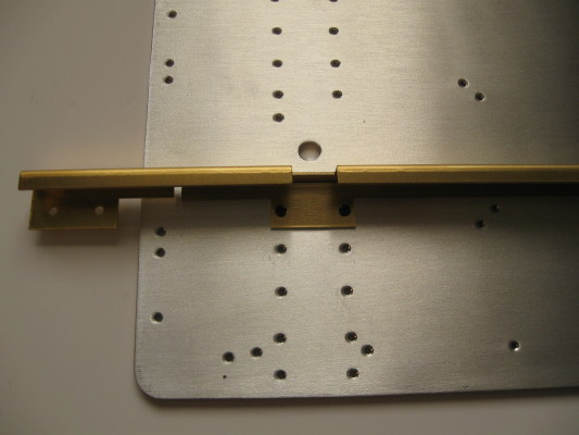

Locate the three indicated holes of the tender base with corresponding positions to those on diecast frame B. Fit the end of the frame into the groove of the underframe, then align the holes and tighten a 2x4mm screw into the single hole at the end of the frame.
Follow the same process to fit diecast frame A onto the opposite side of the tender base.
Place brass framer C over the two holes of frame B and the single hole of the side beam, and tighten a 2x4mm screw into the three holes.

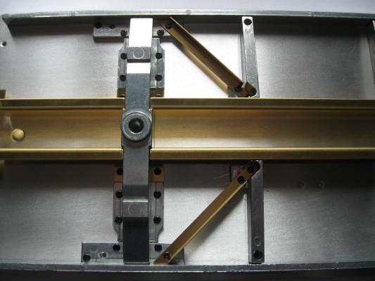

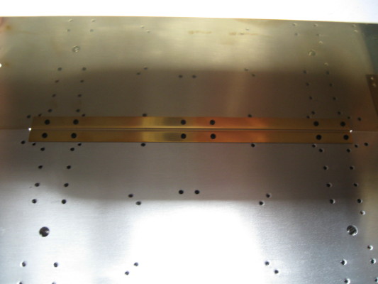

Place the rear diecast tender base in the gap between the underframes and the base. Push the rear in until the holes are aligned.
Align the end holes of brass frame B with those of the underframe and side beam, then tighten a 2x4mm screw into both holes of frame B.
Place brass frame A on the opposite side of the base, aligning the holes, then tighten a 2x4mm screw into each hole.

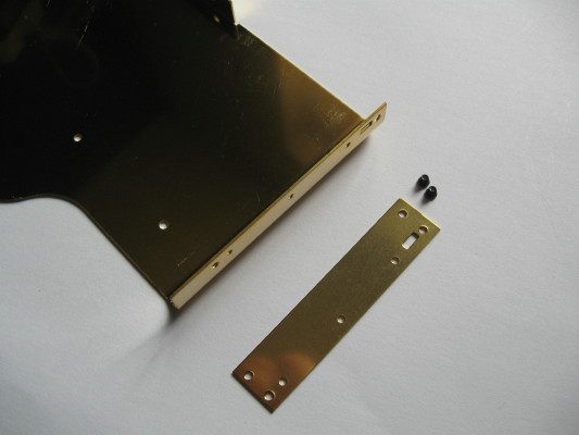

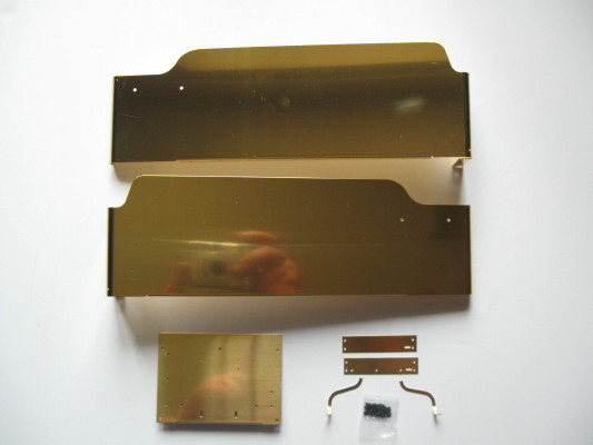

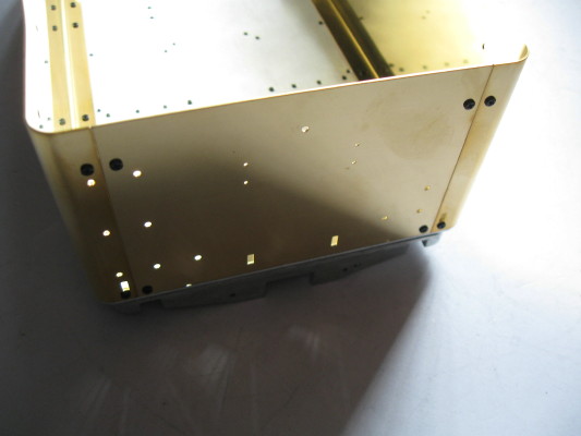

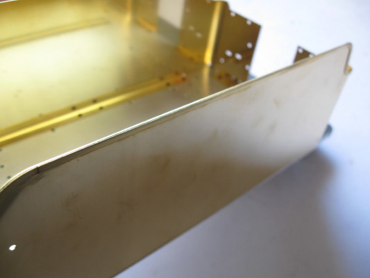

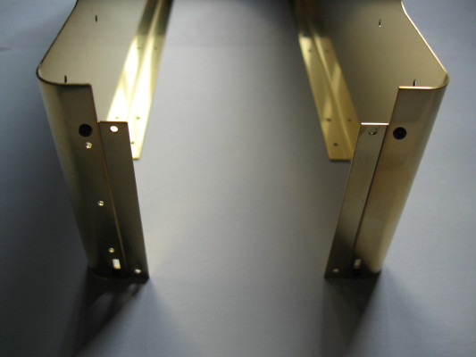

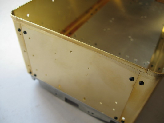

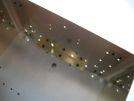

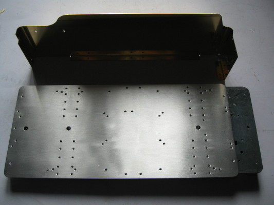

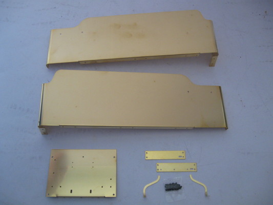

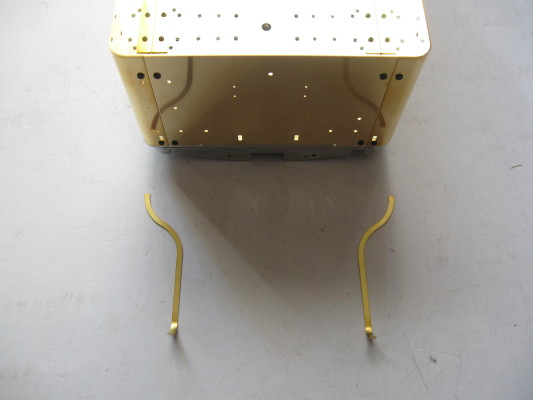

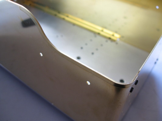

Stage 71 - Contains the tender sides, rear panel, joint plates, corner edging and screws.
Align the holes of tender joint B with the back of the left tender wall, then tighten a 2x2mm screw into the two holes.
Align the two holes of tender joint A with the back of the right tender wall, then tighten a 2x2 mm screw into each hole.
Place the left tender side onto the left side of the tender base, aligning the corners and holes, then tighten eight 2x2mm screws into the holes at the bottom of the tender side.
Place the right tender wall onto the right side of the tender base, as with the left. Tighten a 2x2mm screw into each of the eight holes at the bottom of the tender side.
Place the rear tender panel at the end of tender assembly, outside of the joints, with the tab at the bottom facing inwards. Tighten a 2x2mm screw into the three holes on the inside of the rear panel, at the bottom.
Tighten a 2x2mm screw into each of the four holes in the rear panel, securing it to the joints.

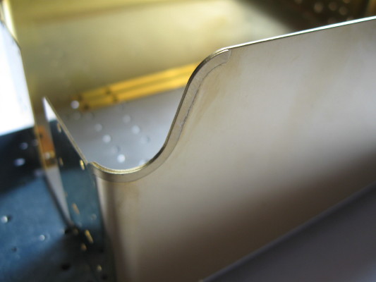

Identify the placement of and difference between the two tender front edging pieces.
Hold the left front edging piece in place and apply adhesive along the top of the edging and the wall.
Then fit the right front edging piece at the opposite corner.

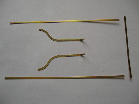

#8 Posted : 14 April 2014 08:31:59

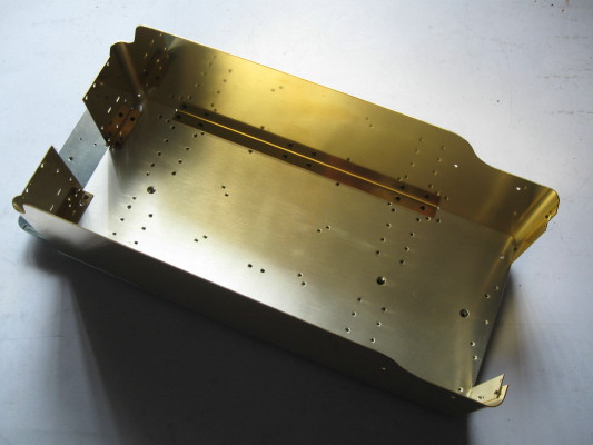

Stage 72 - Contains further tender edging pieces.
Identify and layout the tender assembly and edging pieces C and D as shown.
Apply adhesive to the inside of edging piece D, then place piece D against the left side of the tender wall, aligning the top edges and fit it in place.
Repeat this process to glue edging piece C into place on the right side of the tender. Adjust the placement of the edging so it is aligned with the top of the wall.
Apply adhesive to the side of tender edging piece A, then place piece A on the side of the tender between the front and back edging pieces. Adjust the placement of the edging so it is aligned with the top of the wall, and also make sure that it is flush with the pieces either side.
Apply adhesive to the second A piece, and place it up against the top of the right wall. Adjust the placement of the piece so it is aligned with the top of the wall and the pieces on either side.
Apply adhesive to one side of edging piece B, and place it at the back of the tender, up against the top of the wall. Adjust its position so it is aligned with the top of the wall.
