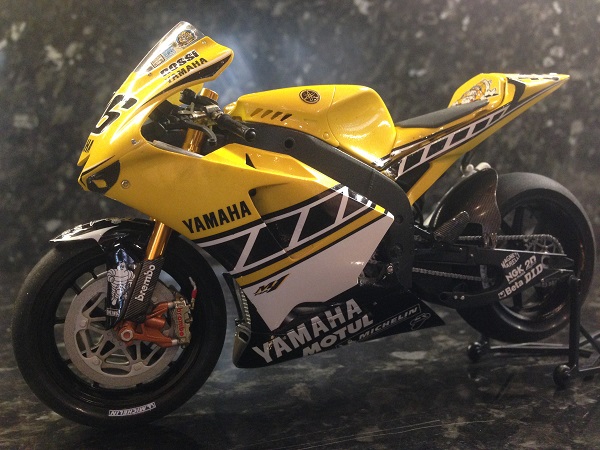

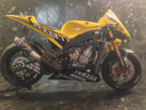

Hoping to finish it this weekend.
Rob.

Looks great Cool
#3 Posted : 01 March 2014 13:54:29
Hi Tanasius,
Fine looking model love the detail this is a credit to you well done.
Regards Trev.

Thanks for the comments,
Body parts,
Rob.

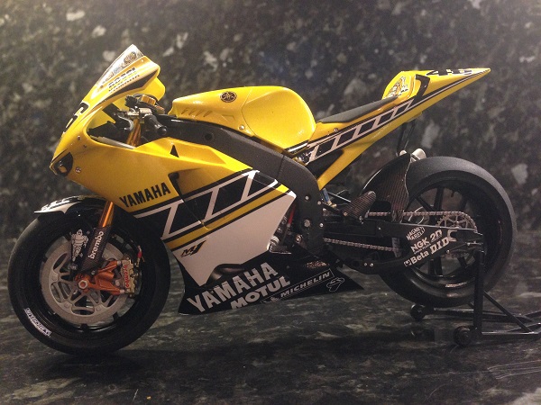

#5 Posted : 02 March 2014 13:15:53
Rank: Amateur level 2
Joined: 21/04/2012
Posts: 42
Points: 119
Getting there.

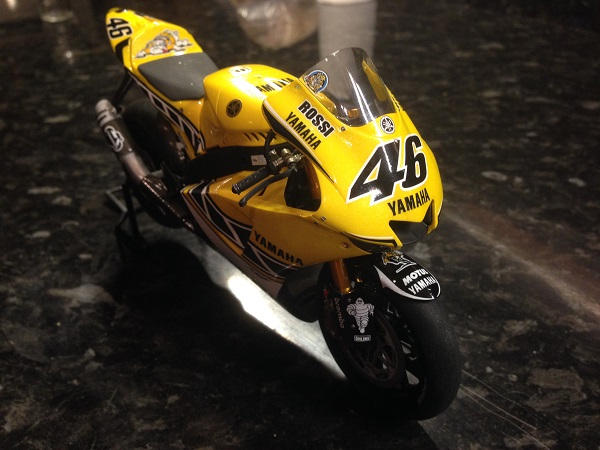

#7 Posted : 03 March 2014 19:01:29
Joined: 21/04/2012
Posts: 42
Points: 119

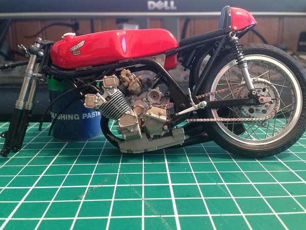

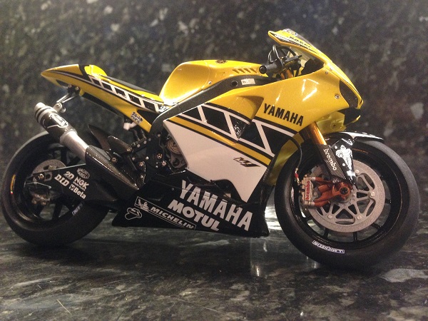

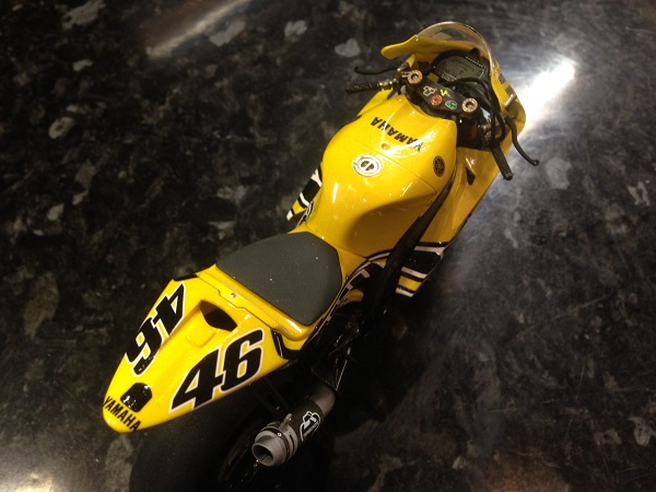

Thanks Trev, you got me interested in bikes, I bought the RC166 after seeing your build, also got the upgrades its about 75% built.
Well its finished,mainly built this to get some practise with decals and Zero paints, clear is 2K Zero gives really good finish but a bit of a pain mixing, I think my next project will be an MP4/4 with full detail.
Rob.
Tanasius attached the following image(s):
Builds, deag Zero, D51, Senna MP4/4
#8 Posted : 03 March 2014 19:26:25
BigGrin Hi Rob
She certainly looks the part nice work

excellent detail mate, a nice tribute to a legend....

Well done Rob, an excellent build and good to hear that a member has inspired you to take it on.
Also, congrat's on your first medal Cool

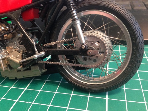

#11 Posted : 03 March 2014 22:29:41
Hi Rob,

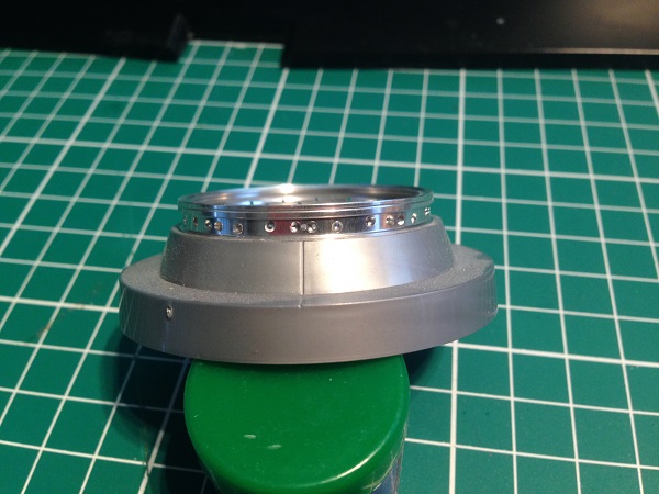

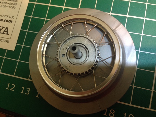

Great finish and a very worthy model for your collection,Rob have you any pictures of your part built Honda 166,my problem is the metal wheels regarding the spokes and the way they fit,I am due to start again soon as this is a great bike model and just looking at it I find a bit irritating.
Trev
Tanasius

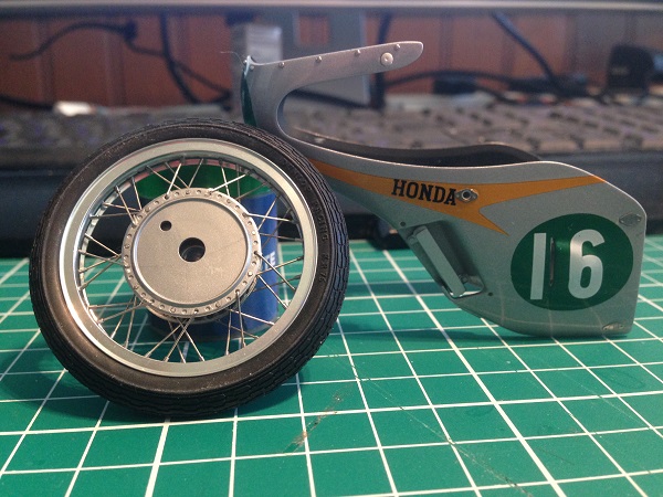

#12 Posted : 03 March 2014 23:18:40
Joined: 21/04/2012
Posts: 42
Points: 119
Hi Trev only done the back wheel will put some pictures up tomorrow, going to do the front wheel so I will put some pictures up hopefully it will help you, might even do it tomorrow.

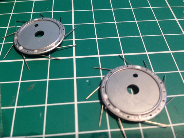

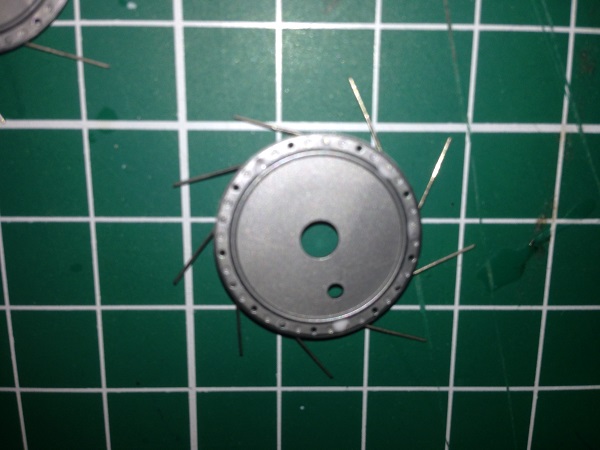

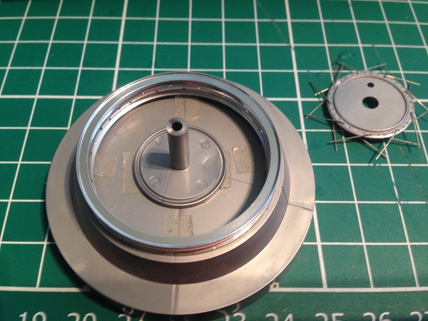

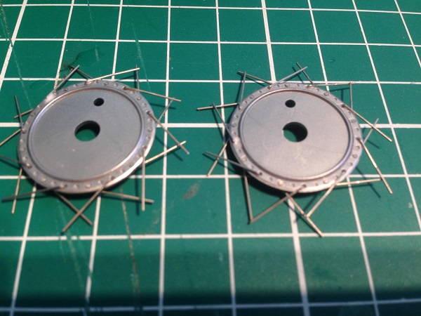

#14 Posted : 04 March 2014 15:32:28
Joined: 21/04/2012
Posts: 42
Points: 119
Hi Trev, only real advise I can give is do exactly as instructions, make sure the air valve hole is inline with the mark on the jig, if you look at the holes from the outside of the rim it's easy to identify as it's the only hole not counterboared,when you put the first lot of spokes in and position them as shown in the diagram, put a little watered down PVA glue on them to hold them in place, now you put the next lot of spokes in from the other side, and do the same, make two sets, when you put the first hub in the jig, align the lowest down spokes in there holes, they go in quite easy then put the nipples on and use some superglue to hold them in place, when there dry the jig wont be as fragile now because the spokes higher up need a bit of bending to get them in there holes, I used long nose pliers, now you put the spacer in part A1 making sure you align the right hole, then put the other hub in the jig align the spokes and fit the nipples.
I used a magnifier head set makes it a lot easier, so good luck let me know how you get on, any questions I will try to help, so stick with it as you can see they look superb when assembled.
Rob.
#15 Posted : 08 March 2014 17:23:29
Hi Rob,
Thank for taking the time to show your Honda wheels to me,I think I know where the problem was I did not PVA so it became very difficult to hold all the spokes together and in place I will try again thank you.

Hi Trev no problem, a tip do the back wheel first, it's easier because of the longer spokes.
