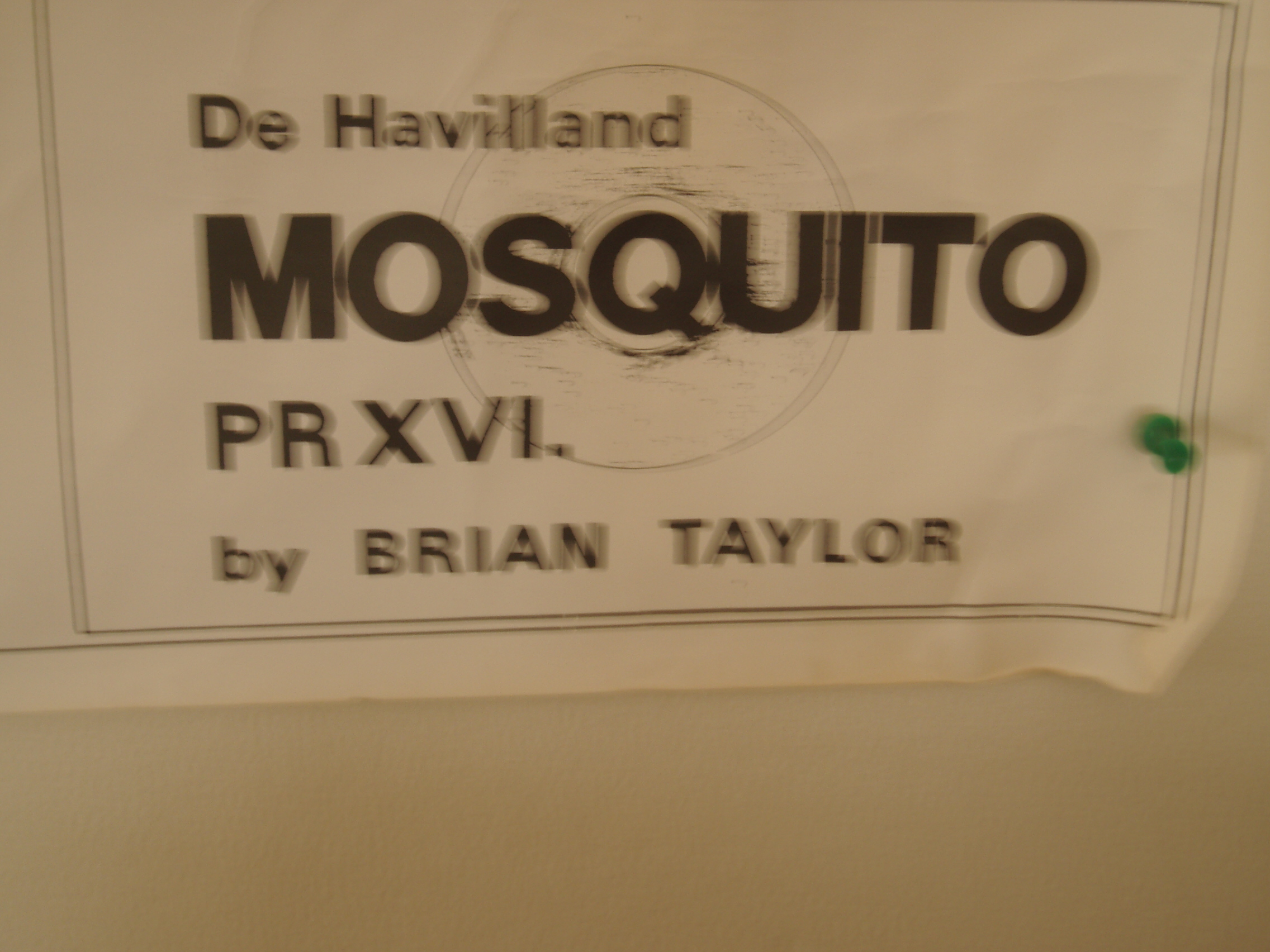

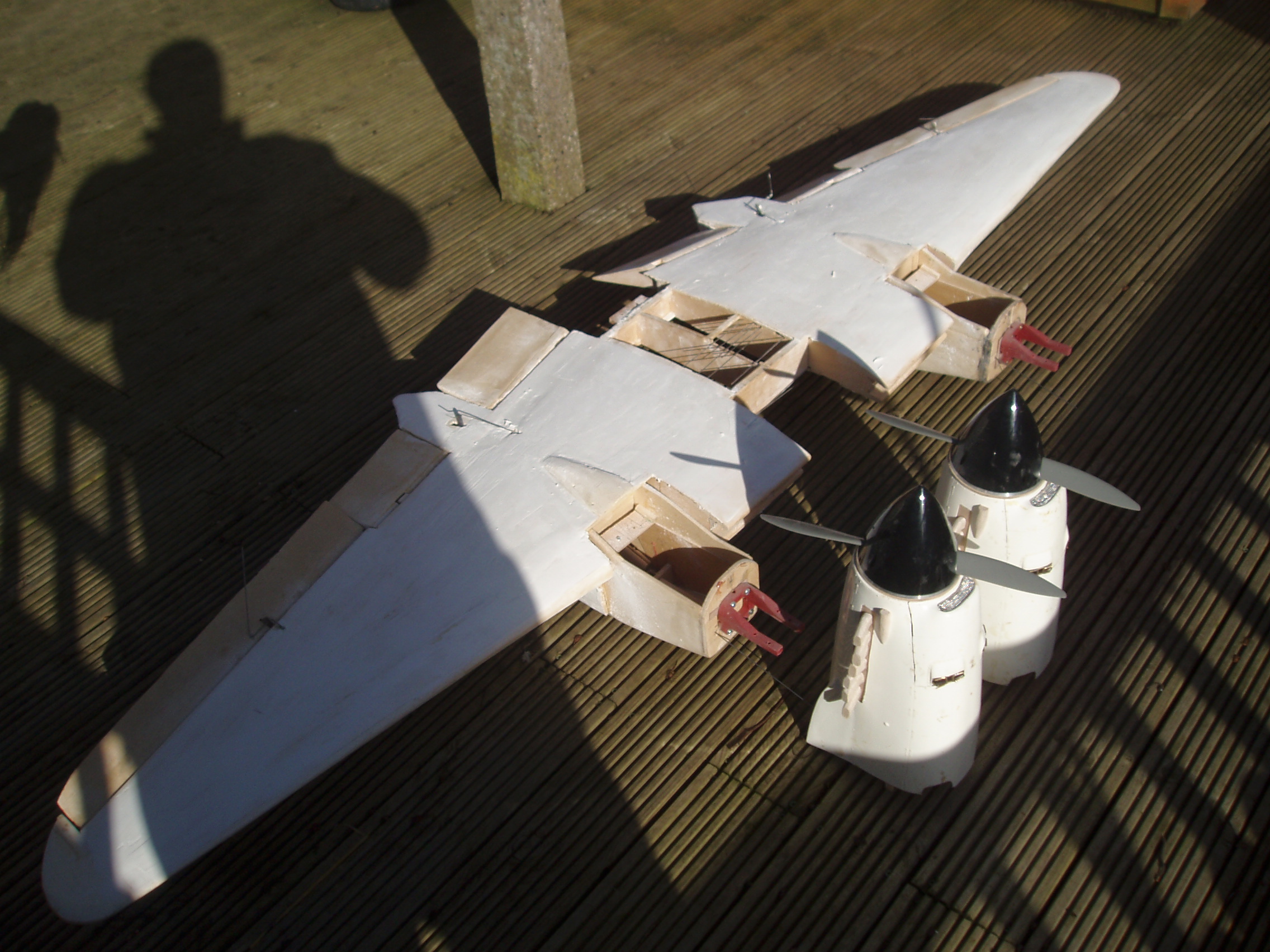

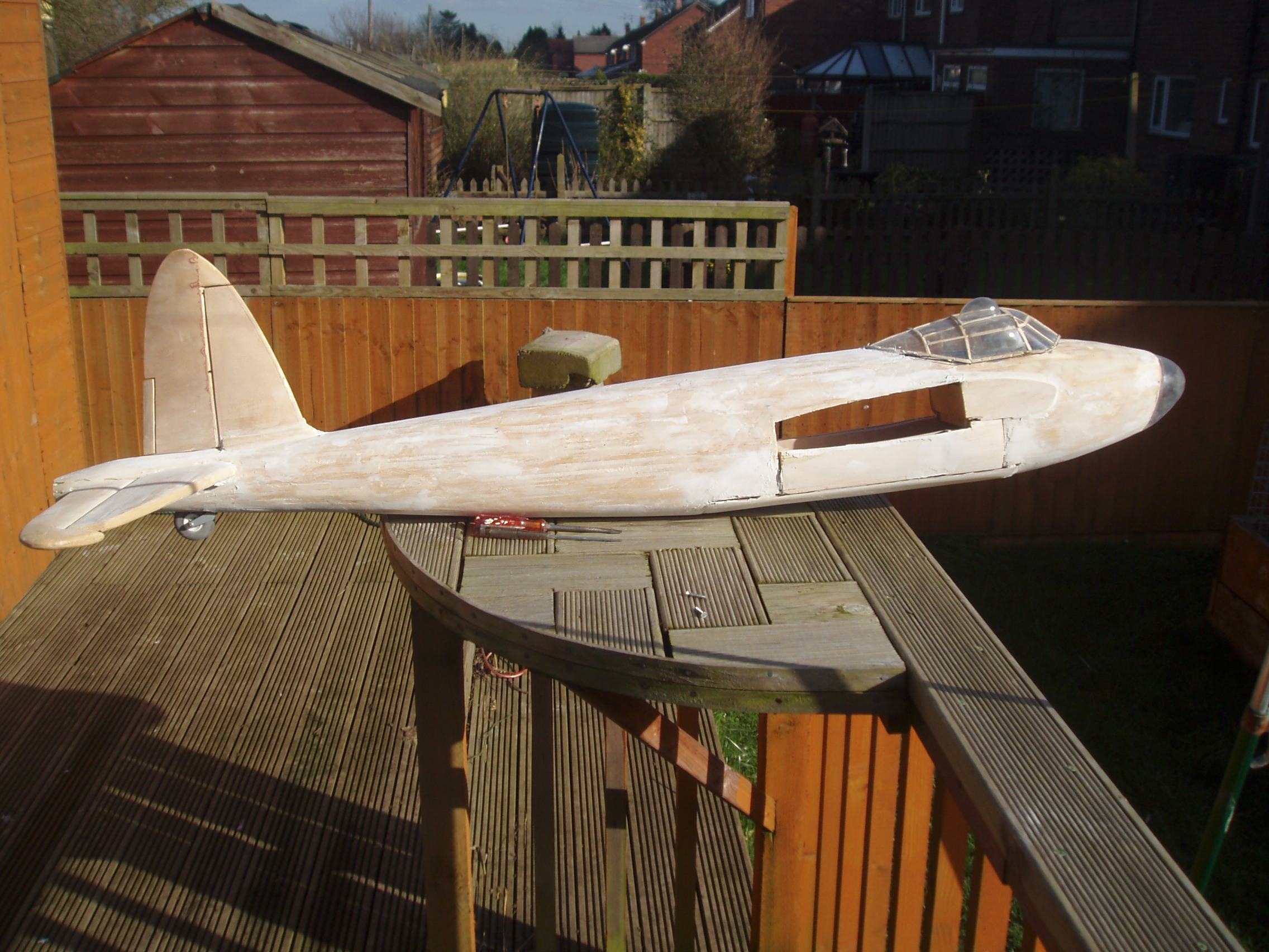

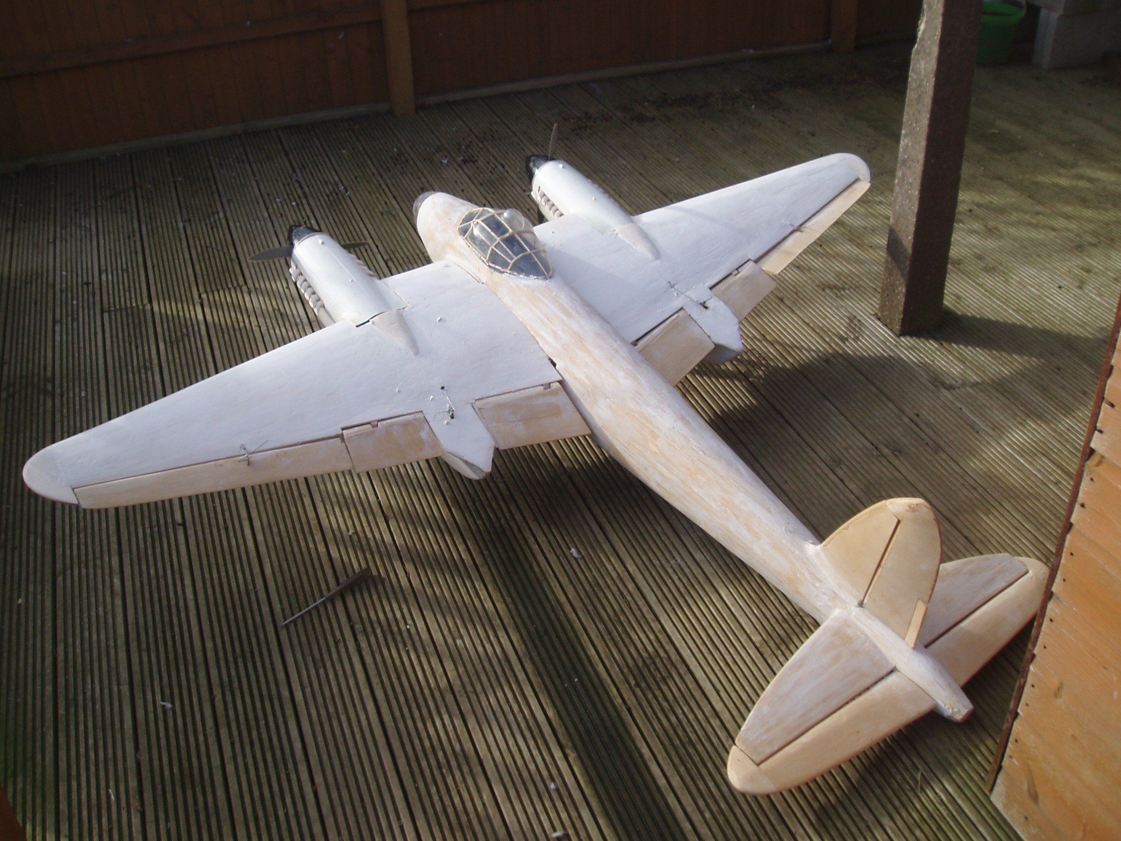

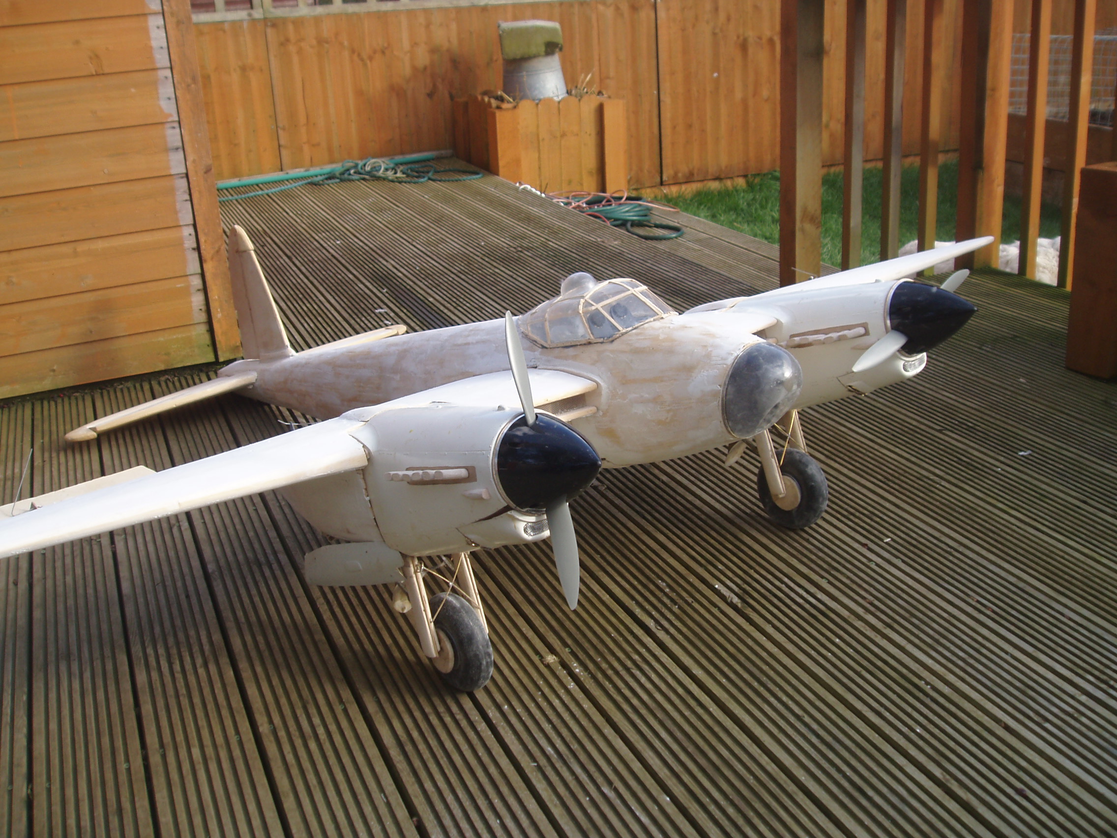

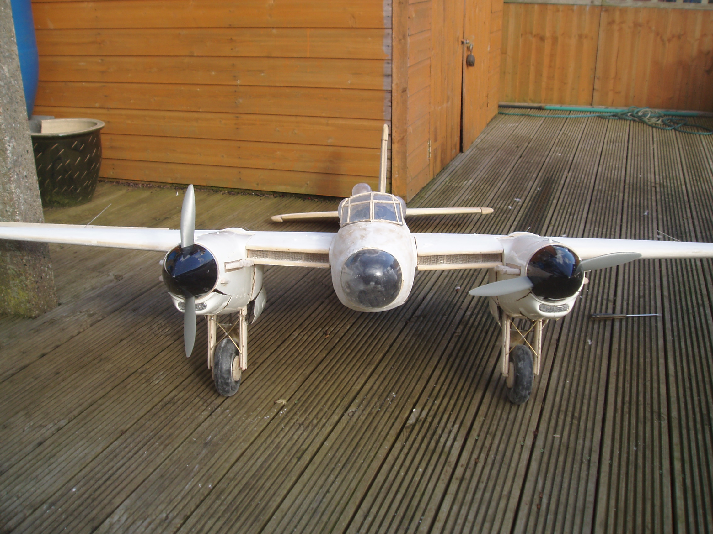

Hi all I hope the pic's come out this is my mozzy that i'm building and is near completion. This is also the first time i've put the mozzy together
So i'm pleased that it all fitted ok [<iframe width="480" height="360" src="http://s72.photobucket.com/user/leoandsky/embed/slideshow/"></iframe>][/img]

Hi all. well I have 4 stroke engines to but into my Mozzy. but there a small problem and that is that they are a bit large to put into the housing up right so I might have to see if I can put them in upside down with a bit of work.
But all that will be sorted out when it all finished. I'm in no rush as it taken me over 2 yrs to build from scratch.
I was please on how it looked when I put my Mozzy together as it was the first time every thing was put together
My next stage is to cover with PVA and tissue and pray that the wing do not twist out of shape.
This stage I think i'll wait until the summer as there to mush damp in the air.
I will try to keep you all up to date when my next stage is dune and if any body can till me the best was to cover mt Mozzy without any twisting the wings.
