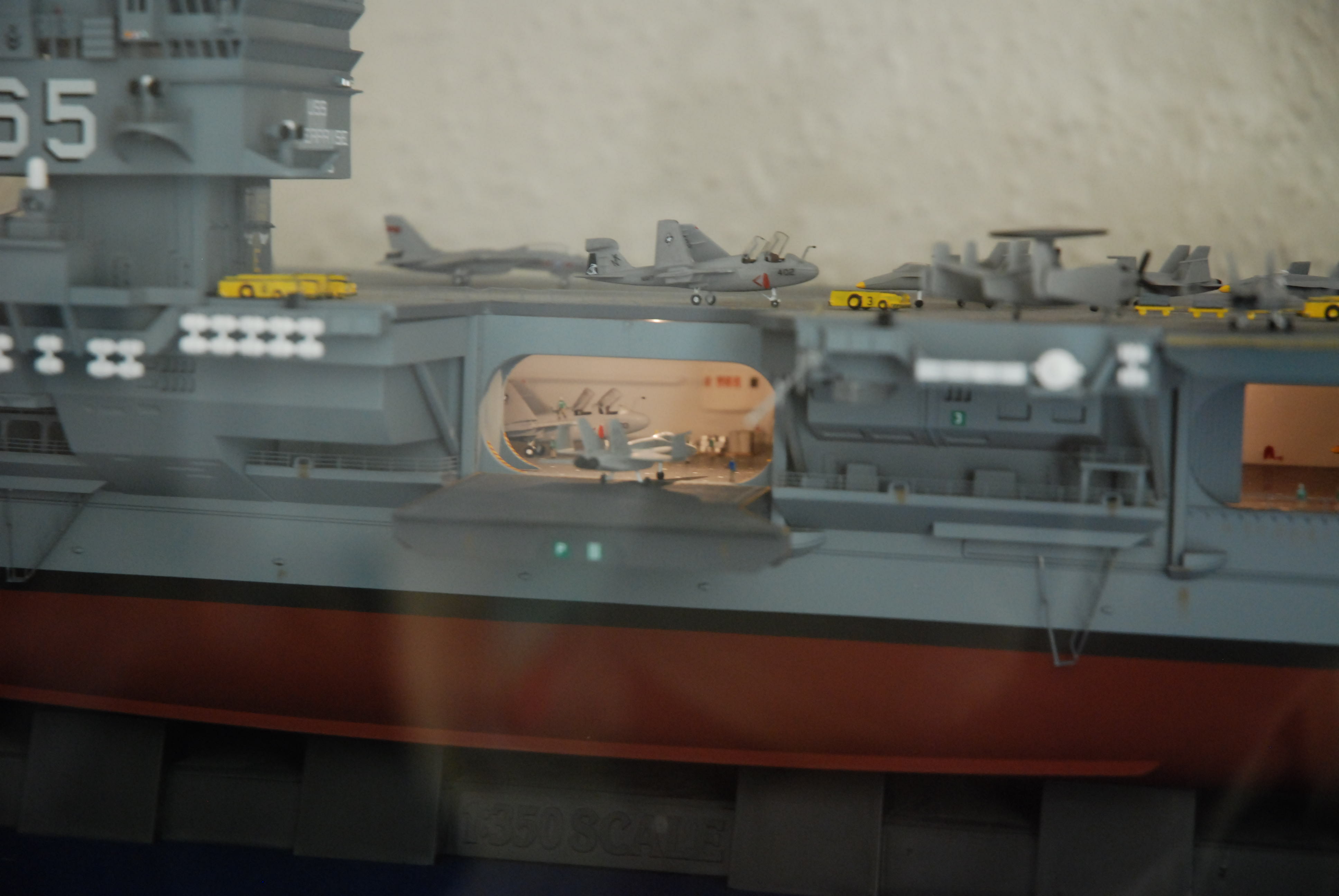

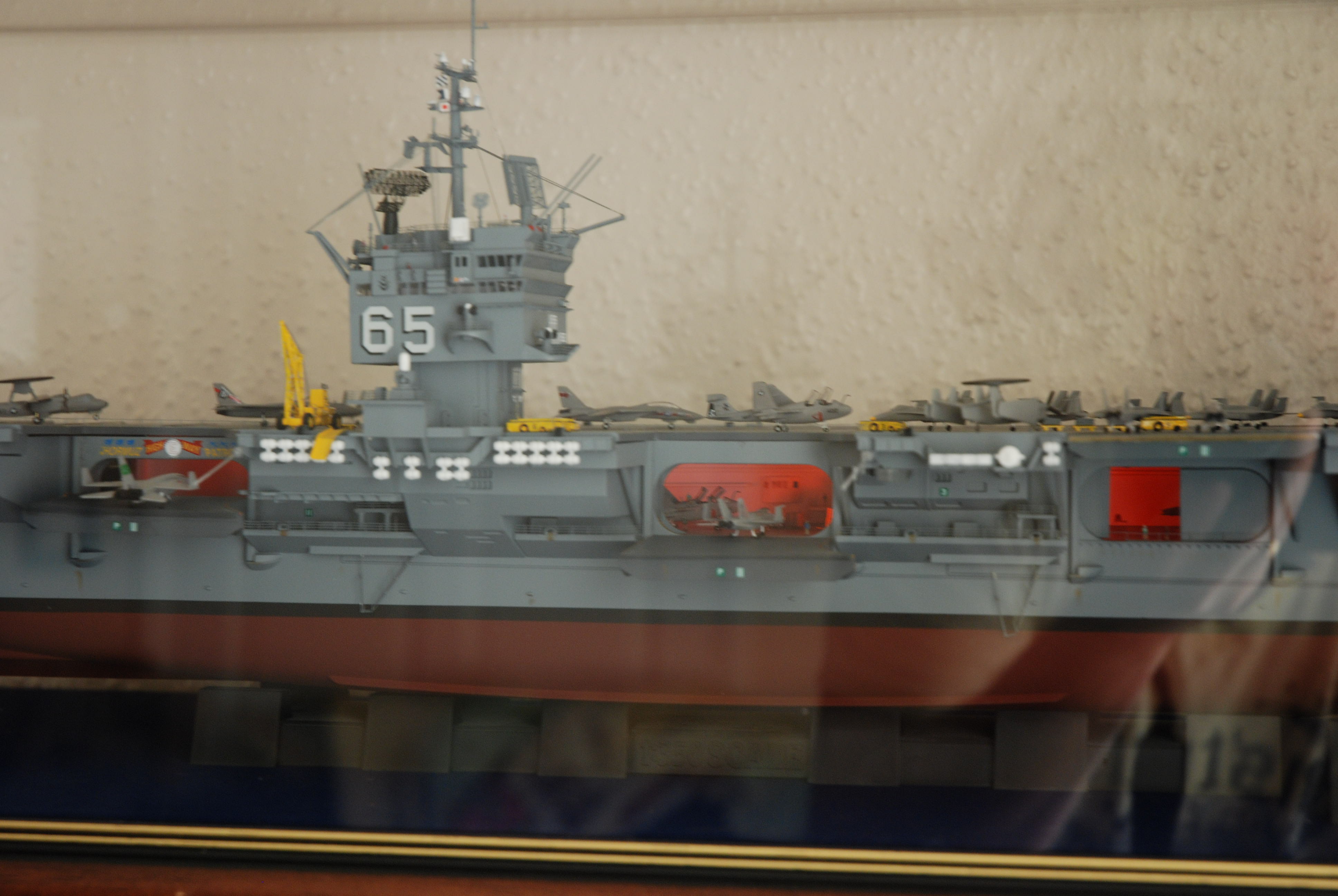

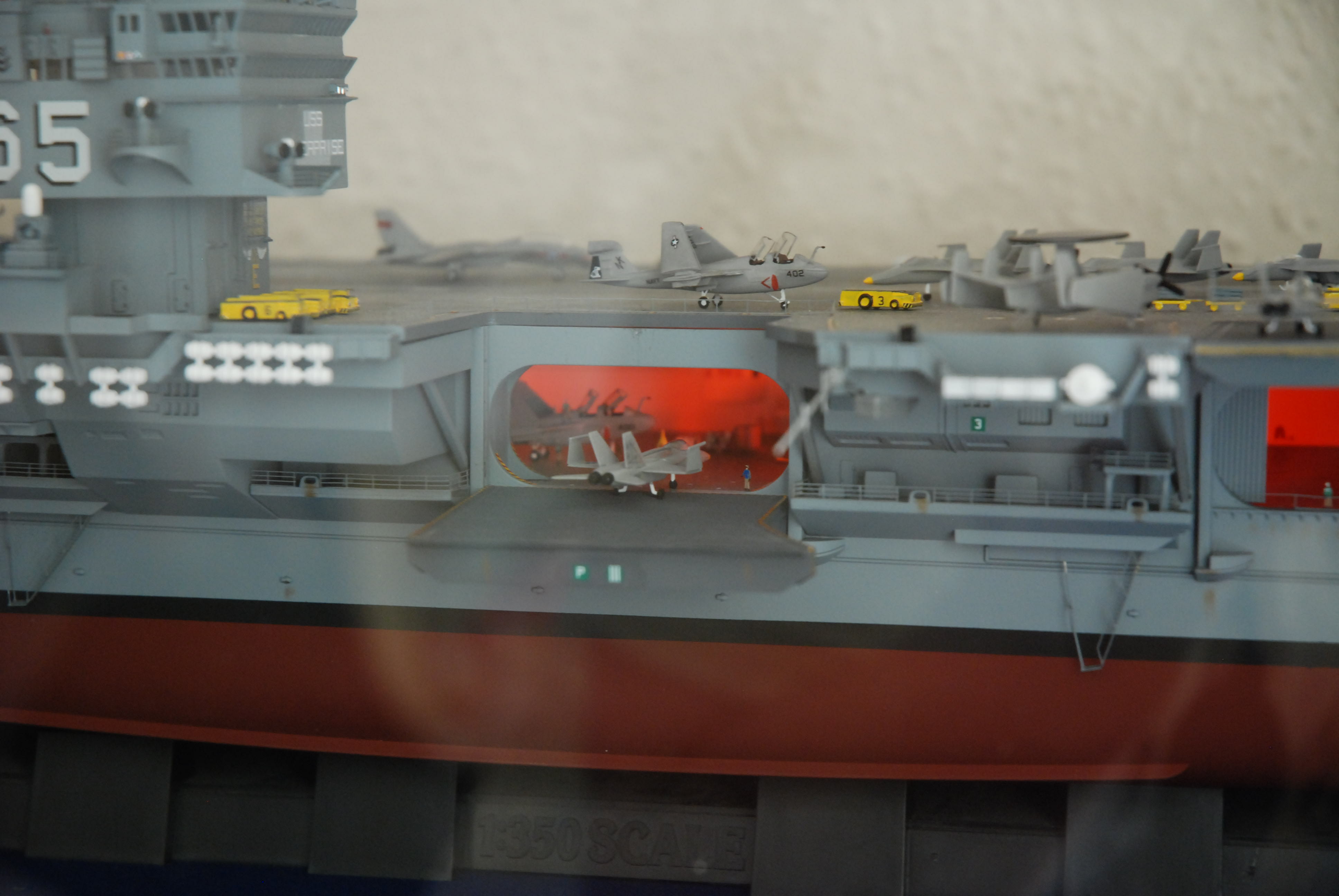

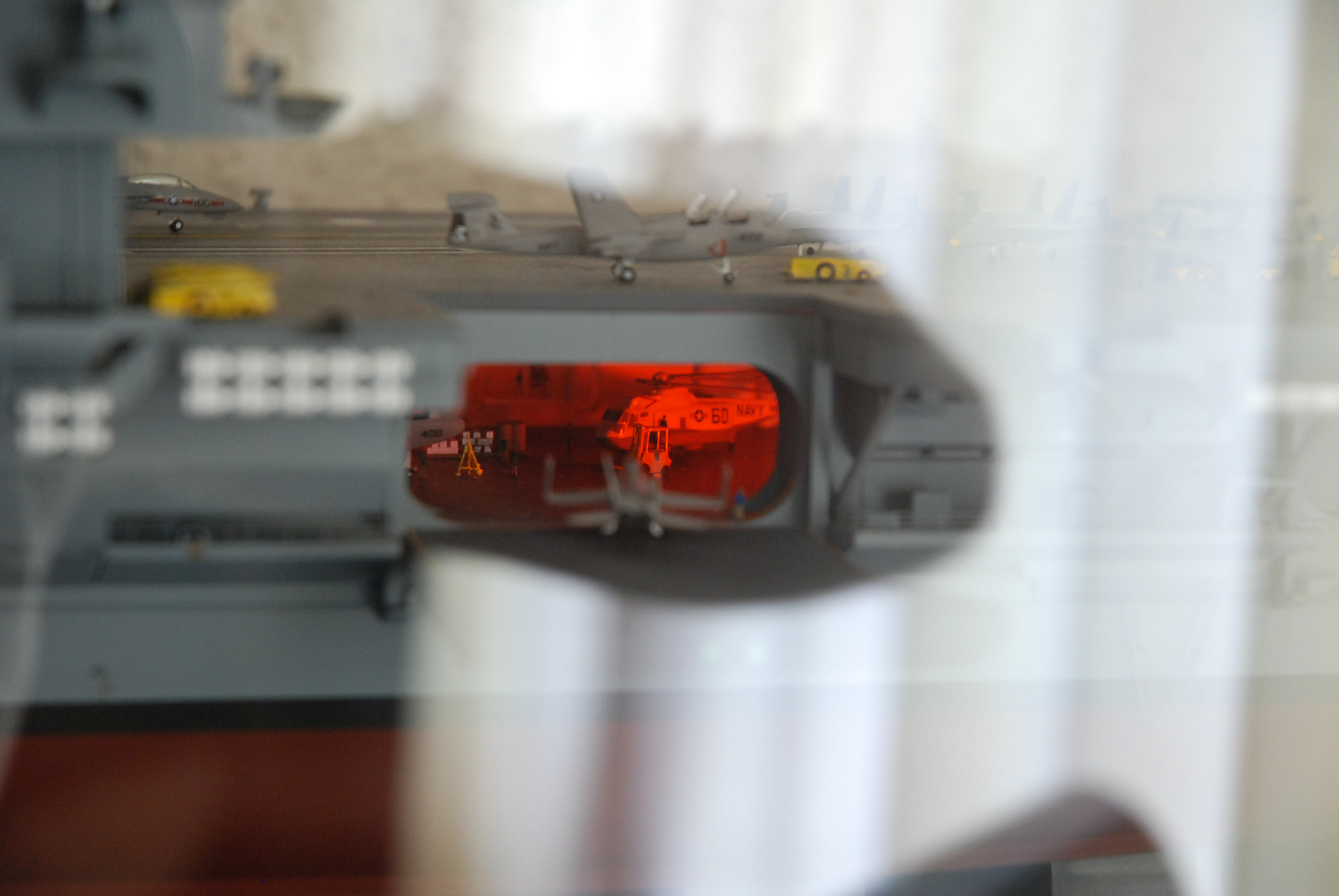

Thought I would post some photos of an Enterprise model I've made in the past with some lighting. This is turned on/off by remote control and can change between red/white (Night light/Normal). Bought the remote module from maplins I think. Can't remember how I wired it up but it looks awesome in the dark.
I had some problems getting decent pictures due to bright light coming through the curtains, but I think you will get the idea!!!
