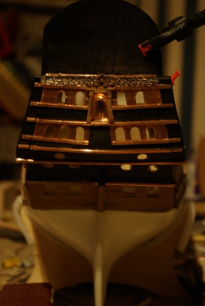

During experiments with the gold platting I was not happy with the results on large planes of gold areas around the stern. the wood grain or filler hairs caused a blurred light refraction. To combat this I decided to cover these areas in copper foil. It worked well on the test I will just have to wait and see how it turns out.
The stern with the laterals and large areas covered. the smaller walnut carvings will be coated in carbon ink to allow the platting.

Looking great SandyCool Cool Some very nice carving work above the niche and I do much prefer your tiles to Bill Short's wooden honeycomb.The windows are fabulous,did you use scribed acetate or the mesh?

The windows, after counting the panes on the painting I settled on 2mm diamond mesh, that's down to you and thanks again for giving me the heads up.
I have cracked the face panels on the prow their all made now, the castings did not work I lost to much detail as they were to thin, a depth of 2mm, so I tooled some copper that worked a treat although the foliage is a bit vague, I will post a photo when the pedestals are done. The Agapanthus is causing me problems at the moment.
The tiles could have been better I feel their a bit scrappy but I will press on with the vertical ties and how it looks and replace if needed.
The steerage window on the upper gallery walkway looks like a carbon copy of the kings room window further up. I will have to cut them out before mounting the gallery's.
