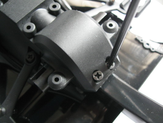

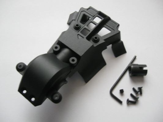

#1 Posted : 01 October 2013 13:00:10

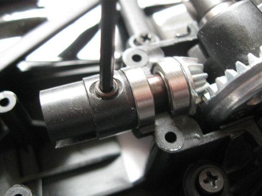

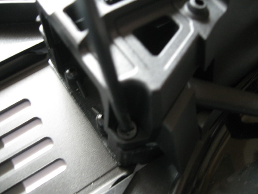

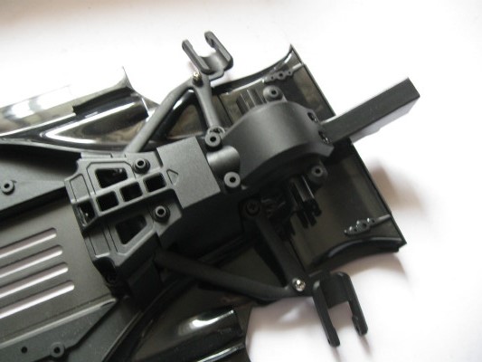

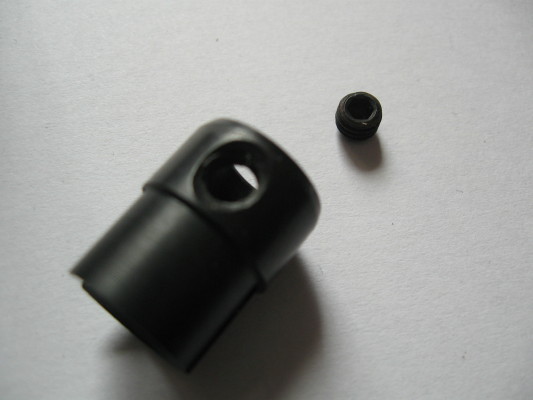

Issue 41 - Contains the upper gearbox cover, cup joint, set screw, screws and an allen key.
Rotate the drive bevel shaft so that its flat section faces upwards.
Take the drive cup, set screw and allen key. Partly screw the set screw into the the drive cup, then place the drive cup onto the drive bevel shaft, so that the set screw is positioned above the flat section of the drive be shaft. Then tighten the set screw. (To prevent the set screw working loose when the model is being run, you can apply a liquid thread lock to the set screw thread).

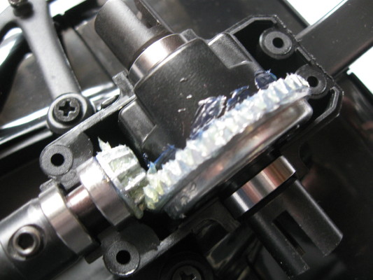

Apply grease to both of the gears, then rotate them a few turns to spread the grease evenly.
Place the upper gearbox cover to align with the lower half of the gearbox, then secure with four 3x10mm screws as shown. Check that the upper and lower gearbox halves are properly seated with each other.
This completes this stage of the assembly

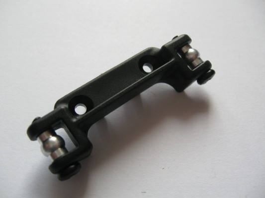

#2 Posted : 17 October 2013 18:16:39

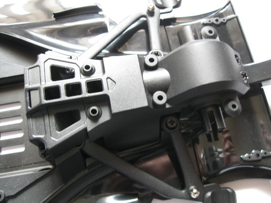

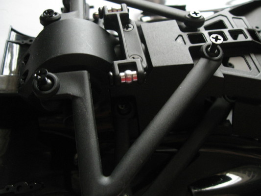

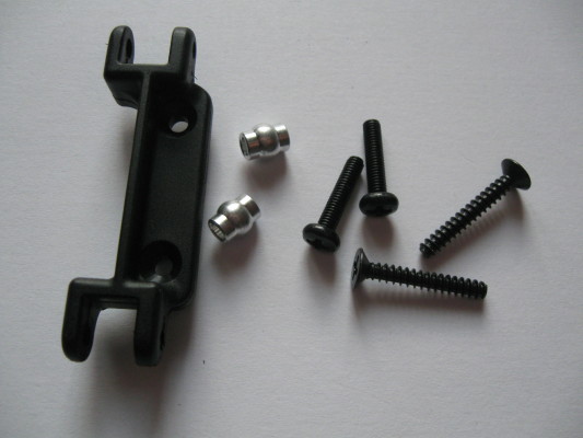

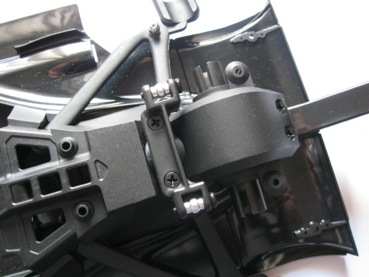

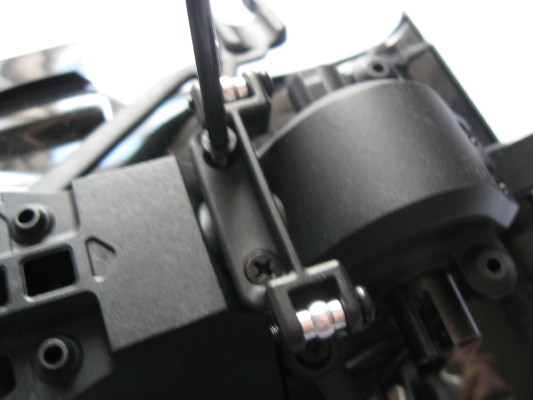

Issue 42 - Contains parts for the rear shock mount.

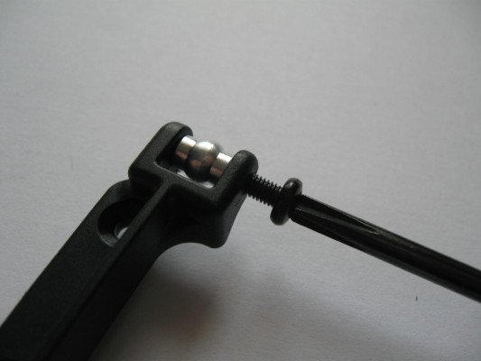

Orientate the mount into the correct position for fitting the ball shafts.
Fit one of the ball shafts between the forked arms of the mount, then slide a 3x14mm screw through then end and tighten it until you see its tip protrude at the opposite end of the mount.
Repeat to fit a second ball shaft at the opposite sie of the mount.
Take the car chassis, and secure the mount on top of the rear bulkhead using two 3x20mm countersunk screws as shown.
(The final image in the magazine shows both rear upper wishbones fitted to the model. This is not done until the following stages).
This complete this stage.

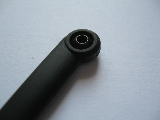

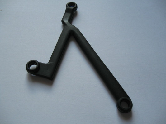

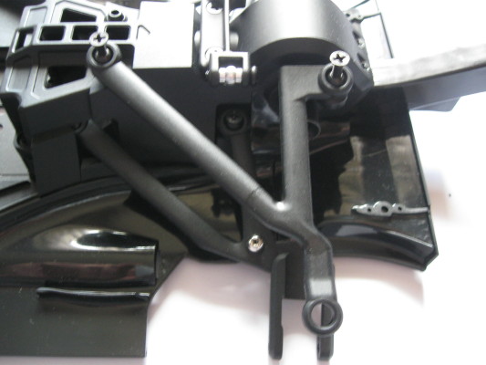

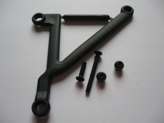

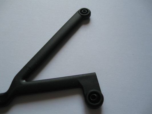

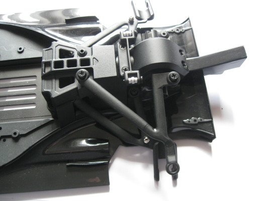

#3 Posted : 18 October 2013 15:32:43

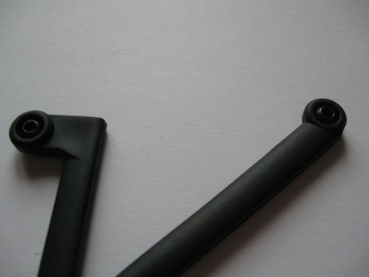

Issue 43 - Contains the left upper rear wishbone, pillow balls and screws.
Cut away the sprue from the wishbone as shown.
Orientate the wishbone as shown, then place a pillow ball into the hole at the shorter end of the arm. Ensure that the flange on the pilow ball is facing downwards, then, using pliers, snap the ball into its mount on the wishbone.
Repeat to fit a second pilow ball into the end of longer wishbone arm.
Take the chassis. Insert a 3x30mm screw through the pillow ball in the longer wishbone arm, and into the hole on the chassis bulkhead.
Tighten the screw until the head rests on top of the pillow ball. Do not overtighten.
Insert a 3x14mm screw into the pilow ball on the shorter wishbone arm, and into the hole on the chassis bulkhead.
Check that upper and lower left rear wishbones are free to move up and down

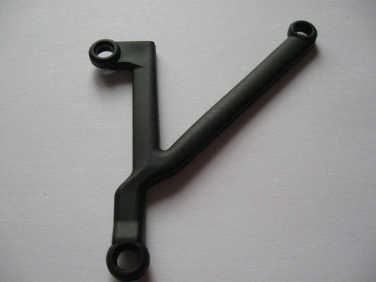

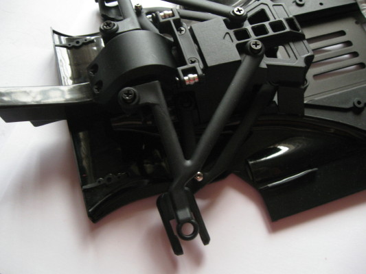

#4 Posted : 13 November 2013 16:41:32
Issue 44 - Contains the right upper rear wishbone, screws and pillow balls.
The assembly for this stage is the same as the previous stage, but this time for the right side of the car. Therefore I won't repeat the assembly process.

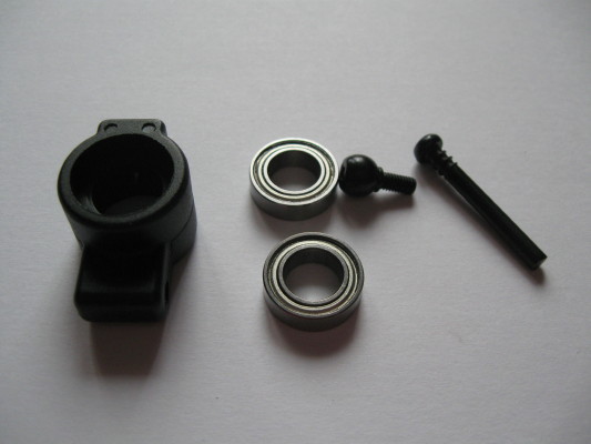

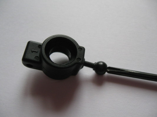

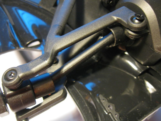

#5 Posted : 13 November 2013 16:51:27

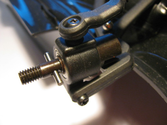

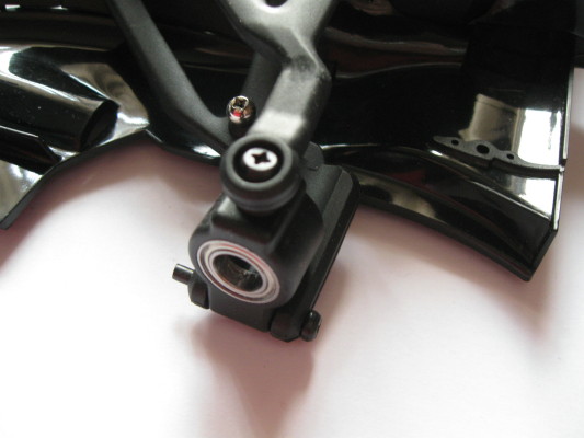

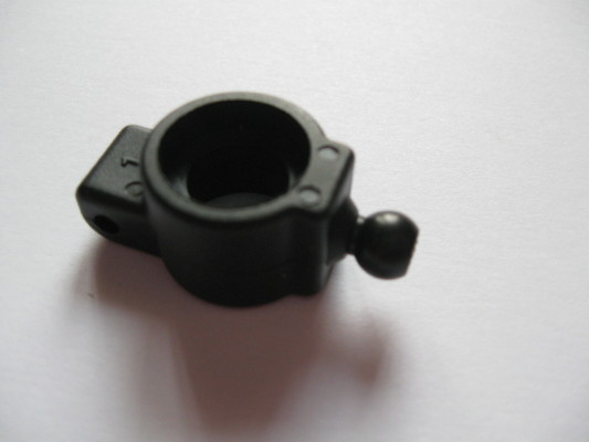

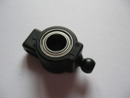

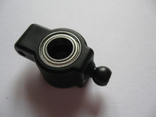

Issue 45 - Contains the left rear hub carrier, bearings a scew pin and ball-headed screw.
Fit the ball-headed screw into the end hole of the hub carrier.
Fit a bearing into each side of the hub carrier.

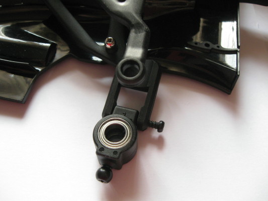

Place the hub carrier assembly between the arms of the left lower wishbone and align the pin holes.
Place the screw pin into the right-hand side pin hole, then tighten until its tip appears at the oposite end.
Check that the hub is free to move up and down, then position the upper wishbone so that its socket is over the ball of the hub. Press down until the arm clicks onto the ball and the ball is inside the socket.

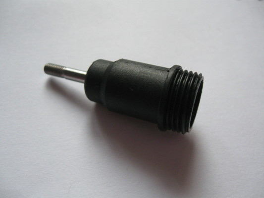

#6 Posted : 25 November 2013 09:58:13

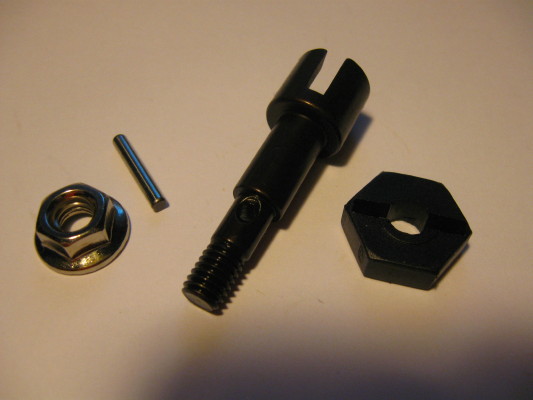

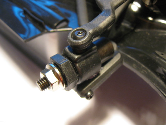

Issue 46 - Contains the left rear wheel shaft, drive nut, flange nut and pin.
Fit the wheel shaft into the left hub, then locate the pin through the outside end.
Locate the drive nut into the pin, ensure that you engage the pin with the recesses on the drive nut, then screw in place the flange nut. (You can to add a strip of masking tape onto the drive nut to prevent loss of the pin until the wheel is fitted).
#7 Posted : 25 November 2013 10:01:05
Issue 47 - Contains the left drive shaft.
You will need to remove the the left upper rear wishbone from its hub mounting to be able to fit the drive shaft.
An alternative to pulling it from its ball joint is to unscrew the wishbone fixings at the gearbox end of the wishbone.
Locate the drive shaft into the drive cup of the wheel hub and differential drive cup.
Then replace the upper wishbone.

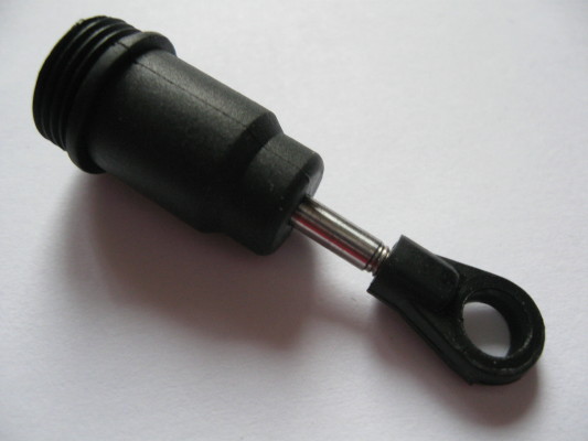

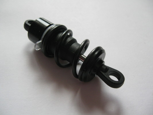

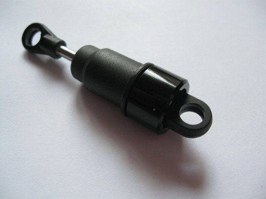

#8 Posted : 25 November 2013 10:03:30

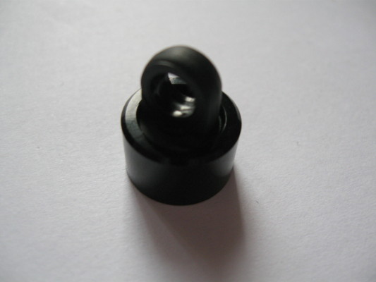

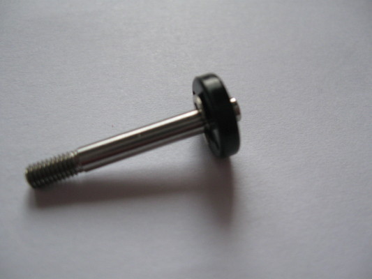

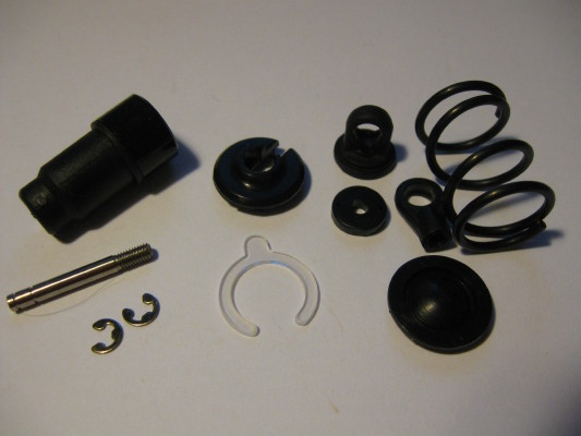

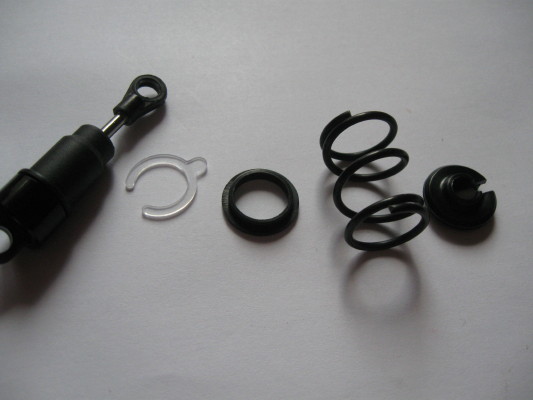

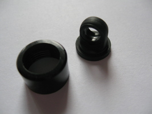

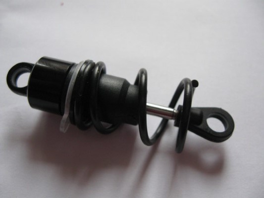

Issue 48 - Contains a rear shock absorber kit.
The assembly is similar to the front shock absorbers, apart from the addition of a spring spacer next to the shock cap.
Ensure that a distance of 8mm is set between the ball end and shock case.
