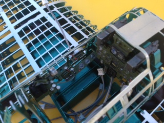

For mine, I used Lifecolor Aotake. It has the advantage of being waterbased, so cleanup is simple. however, the flip side of that is that it requires a primer to be used.

Well, I guess saying whatprimer I used might have been helpful! I use the Tamiya Clear Metal primer, because it allows the natural aluminum so show through, which gives the Aotake a bit of iridescence.
